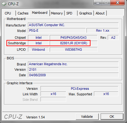

KyLe1294 Posted December 23, 2010 Share Posted December 23, 2010 its a Compaq CQ60-405SA as it says in my sig, heres a pic from CPU-Z thanks (: an the board is a Wistron 303C with a NVIDIA Chipset Quote Link to comment https://www.insanelymac.com/forum/topic/231274-install-snow-leopard-without-ahci-enabled/#findComment-1607590 Share on other sites More sharing options...
Gringo Vermelho Posted December 23, 2010 Share Posted December 23, 2010 CPU specs are irrelevant, you're looking for information about a motherboard component, not your CPU. I've read your signature but I don't know what's in a Compaq CQ60-405SA, I would have to use google to find out. I think you are perfectly capable of doing that yourself though. Wistron 303C with a NVIDIA Chipset That's not good enough, there are several different model Nvidia chipsets. Read: http://en.wikipedia.org/wiki/Comparison_of_NVIDIA_chipsets Use the information you have (motherboard model, Compaq model) to find out what nvidia chipset is on your motherboard, the Southbridge part in particular, that's where the hard drive controller is. Read: http://en.wikipedia.org/wiki/Southbridge_%28computing%29 That said...the information you want is probably available on the 'mainboard' tab of CPU-z. Here's mine: When you have the information you're looking for, use the search to find Verdant's nforce installation guides here on IM, he'll have the files you need. Quote Link to comment https://www.insanelymac.com/forum/topic/231274-install-snow-leopard-without-ahci-enabled/#findComment-1607622 Share on other sites More sharing options...
