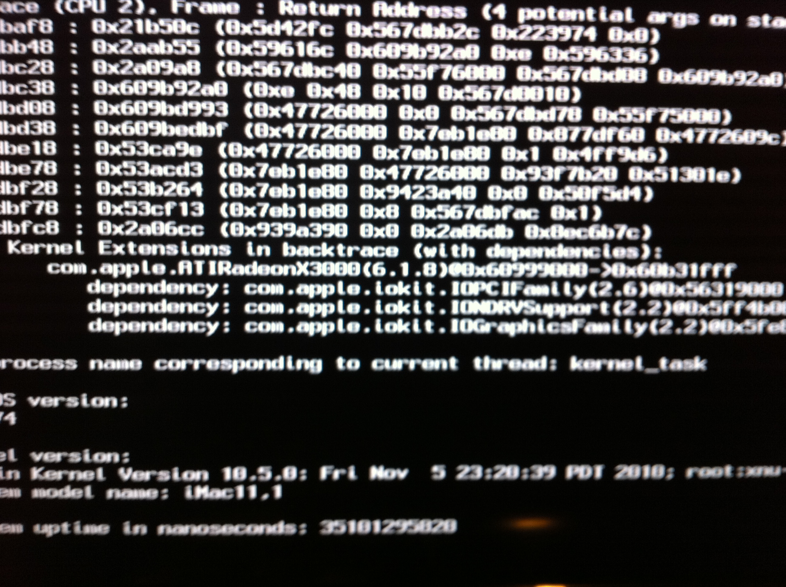

Spanky Deluxe Posted November 14, 2010 Author Share Posted November 14, 2010 10.6.5 working fine here. Running the update straight from my patched 10.6.4 install crashed but I managed to fix it in the end. The safest route for 5970 users to update is the following: 1. Download combo update. 2. Use Pacifist to extract all ATI* files to a working folder. 3. Apply modifications as described in the original post. 4. Remove all ATI kexts from /S/L/E. 5. Run Kext Utility. 6. Reboot. 7. Run combo install package (don't reboot yet though - keep the screen open). 8. Copy over your modified ATI* files from step 3 to /S/L/E. 9. Run Kext Utility (maybe repair file permissions for good measure). 10. Click reboot in the combo installer. That should do it. If you run the combo installer with your modified 10.6.4 drivers loaded then you risk a system crash during the install. If you've gone that route then you'll need to boot into single user mode, remove ATI kexts, remove caches, reboot and reinstall combo update + steps from above. If in doubt or it's not working, boot into single user, remove ATI*, remove the two mkext files and boot up into VESA mode. As I've mentioned before in this thread, my system has been particularly sensitive to playing around with the ATI drivers. Applying modifications when they're not loaded has been far more successful and not running kext utility after installing kexts lead to misery. P.S. Still no triple head support on 5970 in 10.6.5. Link to comment https://www.insanelymac.com/forum/topic/230874-radeon-5970-snow-leopard-instructions/page/3/#findComment-1583049 Share on other sites More sharing options...

sorandom Posted November 19, 2010 Share Posted November 19, 2010 Hay spanky, Im having a problem with the fan kicking in. and it doesnt boot. I have followed your instructions to the t. Will you help me work this out? I would really help if someone would post the exact pkg that needs to be installed. or the kexts that need to be installed. RIght after I post this I update my profile. Link to comment https://www.insanelymac.com/forum/topic/230874-radeon-5970-snow-leopard-instructions/page/3/#findComment-1586972 Share on other sites More sharing options...
Spanky Deluxe Posted November 19, 2010 Author Share Posted November 19, 2010 Can't help much right now since it's 5:30am here and I need to get to bed! Your symptoms sound like the bios file isn't getting read in right. If you're using the initial method I posted and are using a downloaded bios file then you might want to try another bios or dump your one one. You could also try the other bootloader I think I mentioned somewhere in here (there's another topic on it too) that doesn't need the rom dump. I can't give you the link right now though because I'm posting from my phone. Link to comment https://www.insanelymac.com/forum/topic/230874-radeon-5970-snow-leopard-instructions/page/3/#findComment-1586976 Share on other sites More sharing options...

planetetv Posted November 22, 2011 Share Posted November 22, 2011 I have done this procedure under Lion 10.7.2 but, my GPU suffer of overheating , fans works not enough to make GPU cooler (70°C under OSX, around 53°C under W7), can somebody helps? Thanks =) Link to comment https://www.insanelymac.com/forum/topic/230874-radeon-5970-snow-leopard-instructions/page/3/#findComment-1772708 Share on other sites More sharing options...
Spanky Deluxe Posted December 2, 2011 Author Share Posted December 2, 2011 planetetv, try removing the modification to the X3000 kext. It looks like it is no longer necessary and may be what's causing your GPU to overheat. I've noticed some instabilities on my system and suspected the same issue as yours (although I can't check GPU temps in OSX). I've removed the X3000 modification and so far it seems to be fine. Still no MDP joy though. Truth be told, I should really get rid of my 5970 in favour of a single GPU as I've got a GTX590 Windows box just a combo click away through a KVM switcher. I haven't used the second GPU of my 5970 in about half a year! I'll probably wait until the ATI 7xxx series comes out now though. Link to comment https://www.insanelymac.com/forum/topic/230874-radeon-5970-snow-leopard-instructions/page/3/#findComment-1775130 Share on other sites More sharing options...
