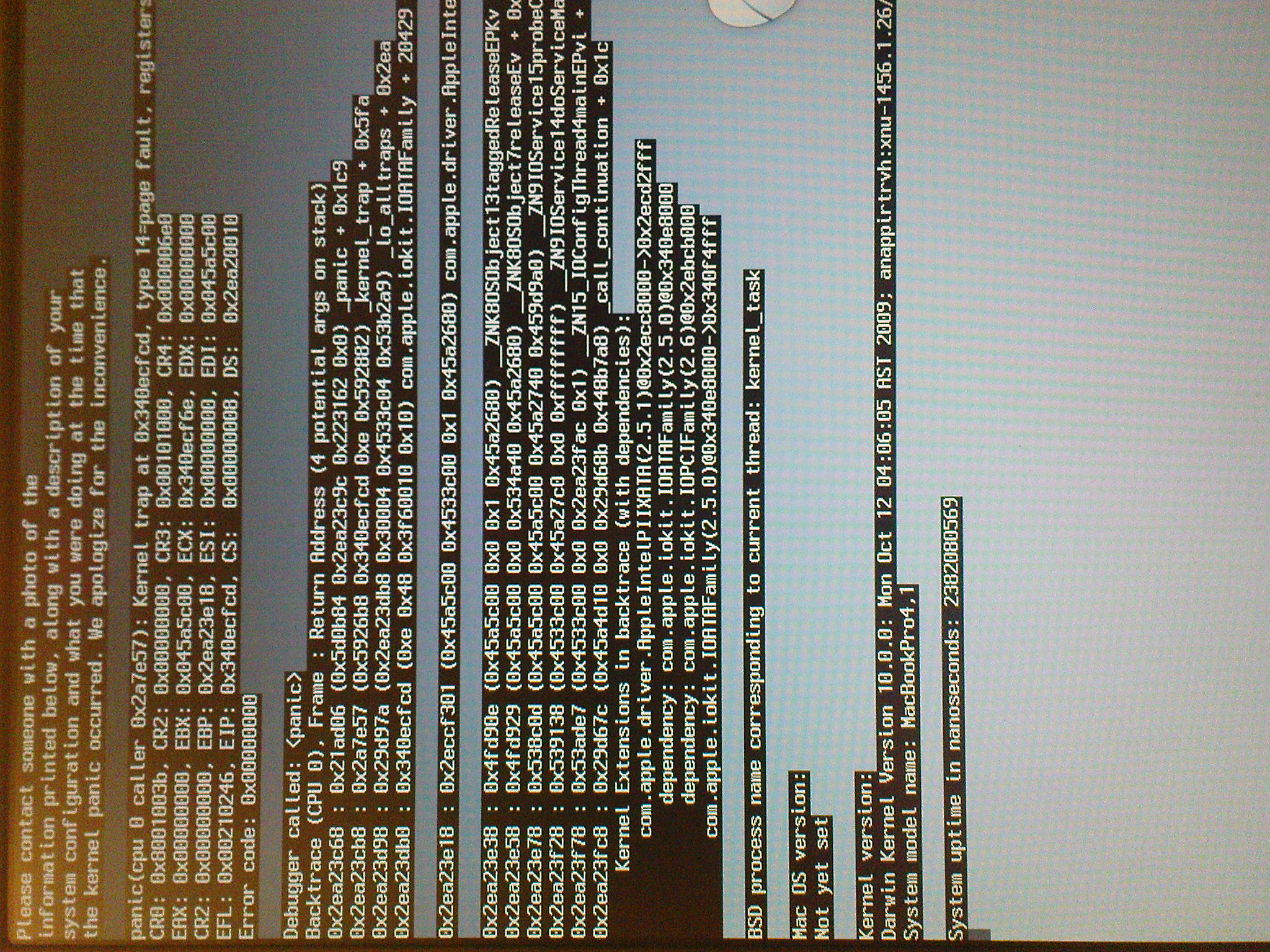

Montechristos Posted August 31, 2010 Share Posted August 31, 2010 Hi to all from a newbie osx86 member I am trying to install osx86 on my lenovo T60 2007-63G. I am using Empire EFI 1.085 ATI I get a kernel panic(attached) and I don't know where to start looking. Can someone help please? Quote Link to comment https://www.insanelymac.com/forum/topic/230631-help-with-kernel-panic/ Share on other sites More sharing options...
MacNutty Posted August 31, 2010 Share Posted August 31, 2010 Hi to all from a newbie osx86 member I am trying to install osx86 on my lenovo T60 2007-63G. I am using Empire EFI 1.085 ATI I get a kernel panic(attached) and I don't know where to start looking. Can someone help please? You have missed out some information in the screenshot. Quote Link to comment https://www.insanelymac.com/forum/topic/230631-help-with-kernel-panic/#findComment-1540592 Share on other sites More sharing options...

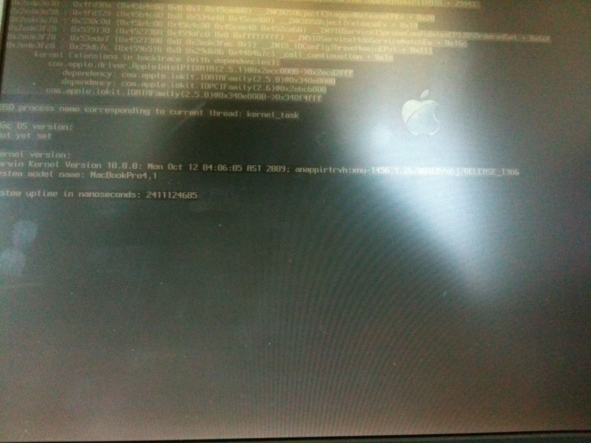

Montechristos Posted August 31, 2010 Author Share Posted August 31, 2010 Sorry, was in a hurry and with a bad camera. Here is a better photo. Any help is appreciated Quote Link to comment https://www.insanelymac.com/forum/topic/230631-help-with-kernel-panic/#findComment-1540858 Share on other sites More sharing options...
Gringo Vermelho Posted August 31, 2010 Share Posted August 31, 2010 What chipset is in your laptop? Please post some specs, believe it or not, most people don't know what hardware is in a Dellnovo x84-4560 or whatever it is you have. The panic is caused by a driver for Intel ICHx Southbridge in PATA mode. Switching SATA to AHCI mode in the BIOS should cure the panic, unless your PC has a PATA drive..? Quote Link to comment https://www.insanelymac.com/forum/topic/230631-help-with-kernel-panic/#findComment-1540862 Share on other sites More sharing options...

Gringo Vermelho Posted September 1, 2010 Share Posted September 1, 2010 Try disabling AHCI mode then. I just noticed there's also a complaint from AppleIntelCPUPowerManagement (half-cut off in your photo). At this point, if you can't even boot the install DVD, all you can do is play with BIOS settings and try different boot flags. Have you seen this? http://forum.thinkpads.com/viewforum.php?f=32 Quote Link to comment https://www.insanelymac.com/forum/topic/230631-help-with-kernel-panic/#findComment-1541485 Share on other sites More sharing options...
