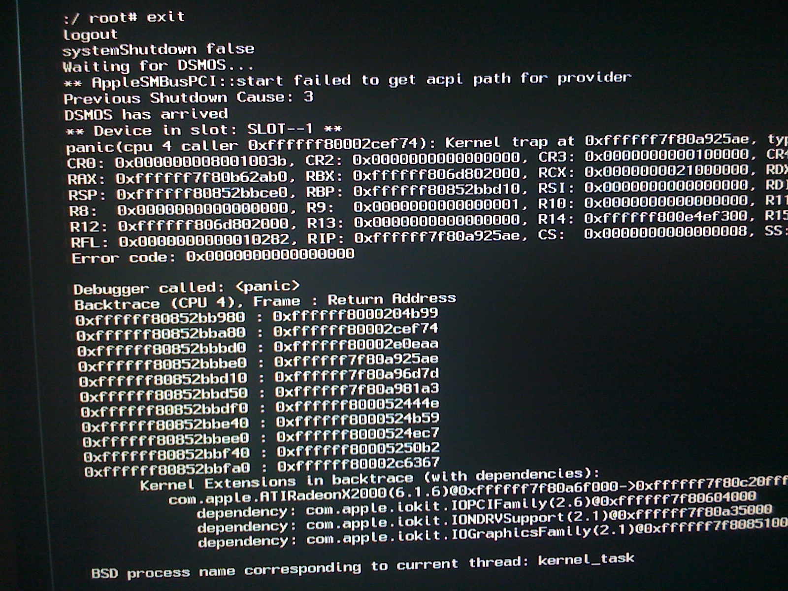

debutant0219 Posted August 29, 2010 Author Share Posted August 29, 2010 Check the SATA cable going to your DVD drive. Verify that it's plugged in properly, try a different cable, try completely unplugging the DVD drive. Or try just ejecting the DVD. Type "SerialATAPI device reconfiguration did not complete successfully" into google (including the quotes) and see what else you can find. I did try you suggestion, and unplugged the DVD and the Windows HD, left only the osx connected, I still got the kernel panic, but this time it is not the same problem, I have attached a screenshot of the issue here. Please take a look and advice me. Quote Link to comment https://www.insanelymac.com/forum/topic/230262-an-odd-situation-need-advice/#findComment-1539504 Share on other sites More sharing options...
Gringo Vermelho Posted August 29, 2010 Share Posted August 29, 2010 Enable ACPI 2.0 and ACPI APIC in the BIOS if you have those settings or similar and try again. If they're enabled already, try disabling them. Also while you're in there, enable all CPU features except CPUID Limit. If that doesn't work then I don't know what you can do next. There seems to be a problem with the driver that OS X is loading for your video card (com.apple.ATIRadeonX2000). I don't have any experience with ATI cards so I don't know what your options are. Quote Link to comment https://www.insanelymac.com/forum/topic/230262-an-odd-situation-need-advice/#findComment-1539611 Share on other sites More sharing options...
