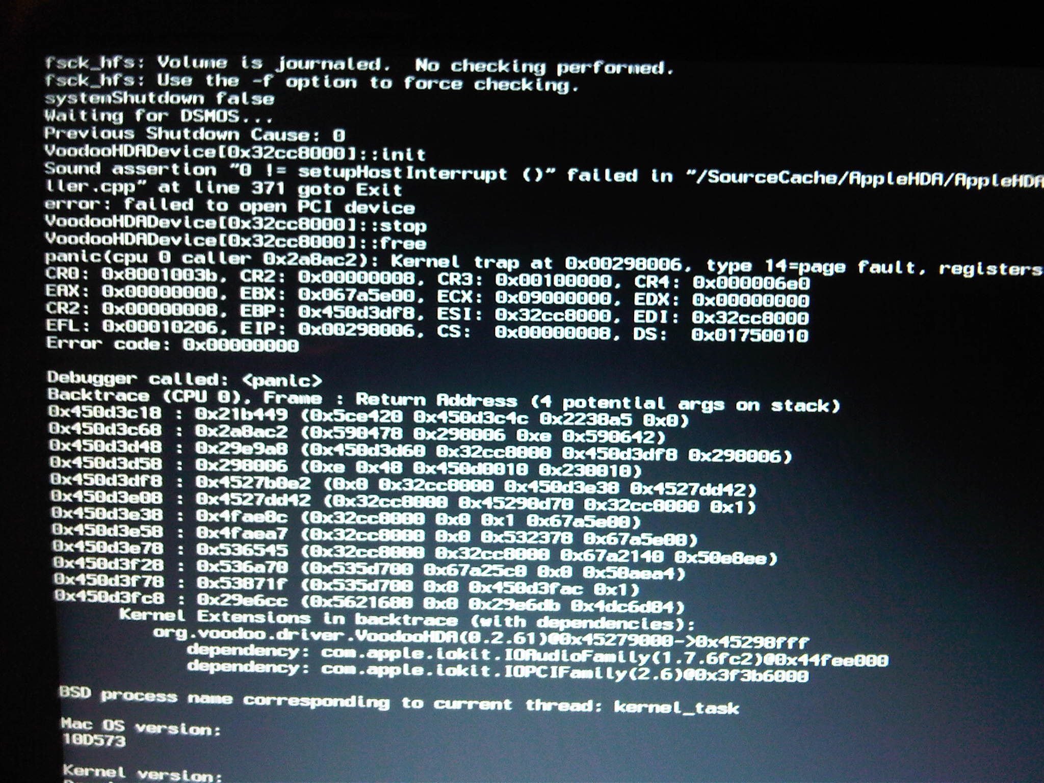

rhenus141 Posted July 31, 2010 Author Share Posted July 31, 2010 ok, finally i can boot from an external harddisk but during booting there is some message it has something to do with sound but i dont know how to unload/disable this driver when i boot with option -x than the gui will start but with message keyboard not connected... can somebody help me..? i am using iatkos s3 v2 Link to comment https://www.insanelymac.com/forum/topic/227121-osx86-on-a-toshiba-t110/#findComment-1522197 Share on other sites More sharing options...
J.B Posted July 31, 2010 Share Posted July 31, 2010 since you say sound, try removing the VoodooHDA.kext from System/Library/Extensions (repair permissions and generate new mkext if possible) and boot using the flags -v -f -x Link to comment https://www.insanelymac.com/forum/topic/227121-osx86-on-a-toshiba-t110/#findComment-1522219 Share on other sites More sharing options...

J.B Posted July 31, 2010 Share Posted July 31, 2010 ok, try using a linux bootCD (ubuntu is probably best) boot into in and navigate to System/Library/Extensions find and delete the VoodooHDA.kext restart and boot as you did before but use the flags "-v -f" Link to comment https://www.insanelymac.com/forum/topic/227121-osx86-on-a-toshiba-t110/#findComment-1522328 Share on other sites More sharing options...
rhenus132 Posted August 4, 2010 Share Posted August 4, 2010 I installed again and deselected under Audio Voodoo and AppleHDA and start again. No it is booting fine till asking for Keyboard. Sound is coming at the first screen. Why sound was coming. I deselect all drivers How i can install my keyboard? Is it enough to select PS/2? I am using external USB speaker and they are working fine. Also USB mouse. If got keyboard to work i can start the system and see what else is working. It looks like i can OSx86 on the T110 Link to comment https://www.insanelymac.com/forum/topic/227121-osx86-on-a-toshiba-t110/#findComment-1524593 Share on other sites More sharing options...
