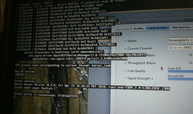

Frixxion Posted July 24, 2010 Share Posted July 24, 2010 Hello Everyone, I have a Dell Lattitude D830 and I have installed the OSX86 Hazard Distro to it. I have upgraded to 10.6.4 without a problem. Everything is running fine. The specs of this laptop are: INTEL CORE 2 DUO T710 MEMORY : 2048MB (2X1024MB) 667MHZ DDR2 S NVIDIA QUADRO NVS 140M WIRELESS : INTEL PRO WIRELESS 3945 (Not working, using an external USB stick) Now I am experiencing a kernel panic when the PC is experiencing heavy load. For example, during extracting rars with SabNZB, I get a kernel panic. I included a picture of the screen. I have already tried several solutions I have found when searching for "appleacpiplatform.kext panic" but these solutions don't seem to affect my problem . Can anyone help me out? Jordy Link to comment https://www.insanelymac.com/forum/topic/226339-osx-1064-random-kernel-panics-during-heavy-load/ Share on other sites More sharing options...

scififan68 Posted July 29, 2010 Share Posted July 29, 2010 It's a dell so there's definitely no ocing. To me this looks like appleacpibatterymeter kext isn't working correctly, so you should replace it with VoodooBattery.kext see if that solves your kp. then if it still does I'd run prime95 just like FormerlyKnownAs said. Link to comment https://www.insanelymac.com/forum/topic/226339-osx-1064-random-kernel-panics-during-heavy-load/#findComment-1520830 Share on other sites More sharing options...
Frixxion Posted July 30, 2010 Author Share Posted July 30, 2010 Thanks for al the replies guys! My laptop is not overclocked though, I'm just running it with all the normal CPU settings. The Dell bios program doesn't really leave any room for tweaking those settings anyway. To formerlyknowas, I have unstalled NULLCPUPM.kext and I'm still having the same problems, so that's not the solution To Hotcorez, my laptop only has 2 gb ram, so using that bootflag shouldn't do anything right? Thanks though! Where can I find information about "tsc sync"? I have tried googling it, but didn't really find anything useful I'll try replacing appleacpibatterymanager.kext and if that won't work prime95. I'll report my results in a few hours! Thnx guys! Link to comment https://www.insanelymac.com/forum/topic/226339-osx-1064-random-kernel-panics-during-heavy-load/#findComment-1521563 Share on other sites More sharing options...
Frixxion Posted July 30, 2010 Author Share Posted July 30, 2010 Solved!!! I installed a few kexts from voodoo and I haven't had a kernel panic for a few hours now! The kexts I installed: - VoodoopowerACPI.kext - VoodooTSCSync.kext I already had the Voodoobattery.kext running. I don't know which of these kexts did the trick, but the combination certainly did the trick! I now have a perfect installation of Snow Leopard !!! Gotta love it Link to comment https://www.insanelymac.com/forum/topic/226339-osx-1064-random-kernel-panics-during-heavy-load/#findComment-1521832 Share on other sites More sharing options...
