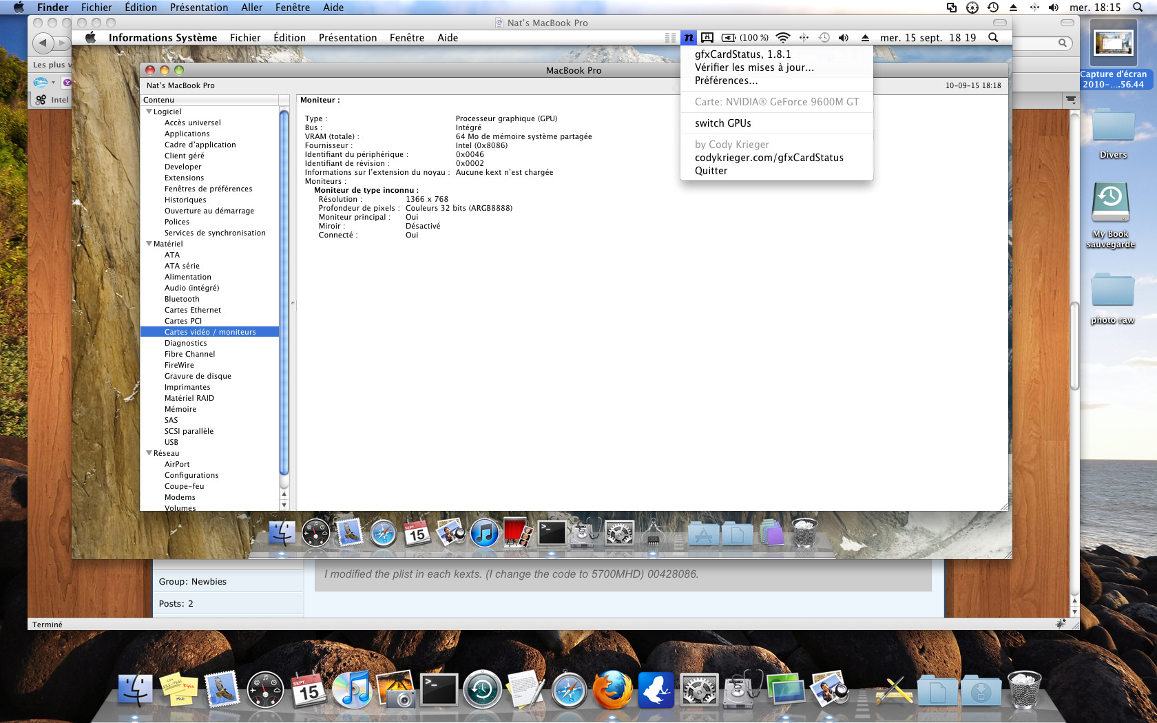

stevmach Posted September 15, 2010 Share Posted September 15, 2010 Hi, someone want to see that, SL 10.6.4 run on sony vaio VPCEB12FD with core I3 and intel hd graphic. I don't see nothing on vaio just a white screen but i can see desktop on my vaio with screen sharing , booting 32 or 64 bit have same result . It's same kexts come with update 10.6.4. Another cool thing too , i have 4 resolution 800x 600, 1024 x 768, 1240 x 1024 and 1680 x 1050. gfxstatuscard detect NVIDIA and INTEL but i can't switch . I think kexts are ok , but miss information about screen or screen not detect or maybe i see many errors in windowserver.log. So it's just my 2 cents !!!!! If you want more informatiom just asking!!!! Link to comment https://www.insanelymac.com/forum/topic/223754-intel-hd-graphics-gma-5700/page/2/#findComment-1549059 Share on other sites More sharing options...

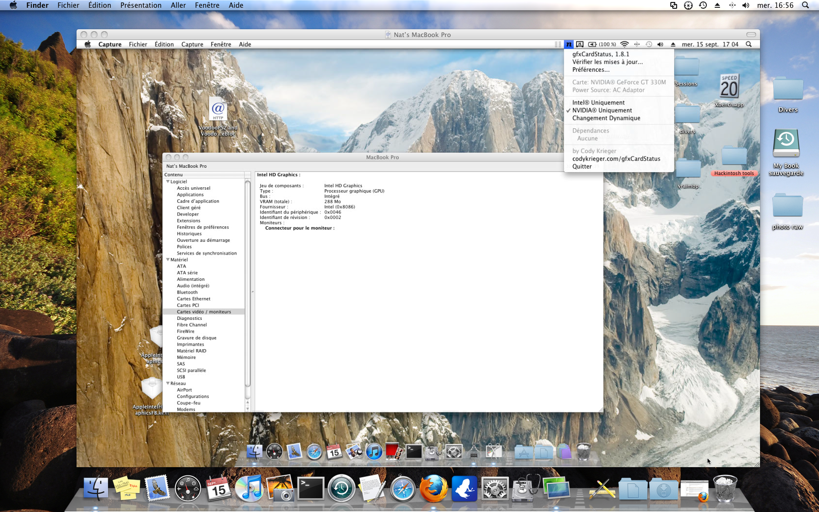

stevmach Posted September 15, 2010 Share Posted September 15, 2010 Other things is if a remove appleintelhdgraphics.kext and appleintelhdgraphicsFB.kext i can reach desktop but only one resolution 1368x768. But gfxstatuscard show me a 9600M GT, it's very weird!!!! Another pic from my vaio system profiler as you can see the system detect a card, he don' know wich card is intel or nvidia it's weird too !!!! I use chameleon v2 RC3 to boot and PCEFI 10.6 with graphicenabler=yes If you need tester for new kext , i will happy to help if i can. Link to comment https://www.insanelymac.com/forum/topic/223754-intel-hd-graphics-gma-5700/page/2/#findComment-1549077 Share on other sites More sharing options...

fmac Posted September 16, 2010 Share Posted September 16, 2010 @stevmach try to disconnect the powercord (ac adapter) switching the graphics cards has something todo with the power you can use the kernelflag "Graphics Mode"="1920x1200x32" to setup the resolution for it is working @ 1600x900x32 greetings AUSTRIA - high montains, no kangurus Link to comment https://www.insanelymac.com/forum/topic/223754-intel-hd-graphics-gma-5700/page/2/#findComment-1549530 Share on other sites More sharing options...
stevmach Posted September 16, 2010 Share Posted September 16, 2010 @fmac I try it but no success . the only thing a see on my laptop screen is a grey or white screen i put my ioreg -l with the kext loaded, if anyone want to see IOregCOREi3.txt If you have others idea to test with my stuff, your welcome. laptop sony vaio VPCEB12FD search on the net to see the spec. Link to comment https://www.insanelymac.com/forum/topic/223754-intel-hd-graphics-gma-5700/page/2/#findComment-1549624 Share on other sites More sharing options...

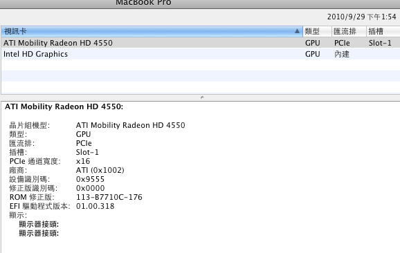

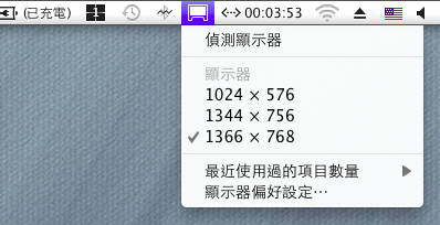

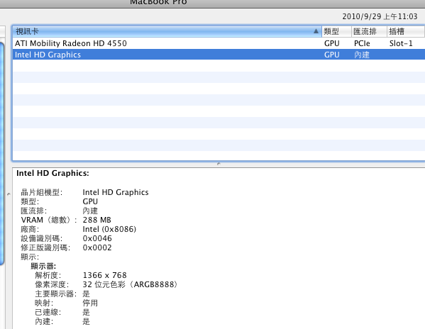

wii3212 Posted September 29, 2010 Share Posted September 29, 2010 my nb VGA come with intel HD + ATI 4550 mobility, I can boot without ATI or INTEL HD kext loaded for 1024x768 without qe/ci, after patched the Chameleon RC4 bootloader, I can get 1366x768 without qe/ci and have the ATI 4550 HD recognized but cannot make it work yet. while update the osx from 10.6.3 to 10.6.4 and with last video upgrade from Apple, I got intel HD kext loaded, but it's a blank screen on lcd, but it run smooth on shared screen withOUT qe/ci ! and can change lcd resolution too. see the attached pics AppleIntelHDGraphicsFB is loaded, but AppleIntelHDGraphics did not ! I think there's somewhere we have to trigger for making the lcd up and running. also, attached patched Chameleon RC4 with 915vga and ati4550, just unzip and replace the boot file at root / update: attached rc5 with 915vga and ati4550 patch myboot.zip myboot_rc5.zip Link to comment https://www.insanelymac.com/forum/topic/223754-intel-hd-graphics-gma-5700/page/2/#findComment-1556350 Share on other sites More sharing options...
