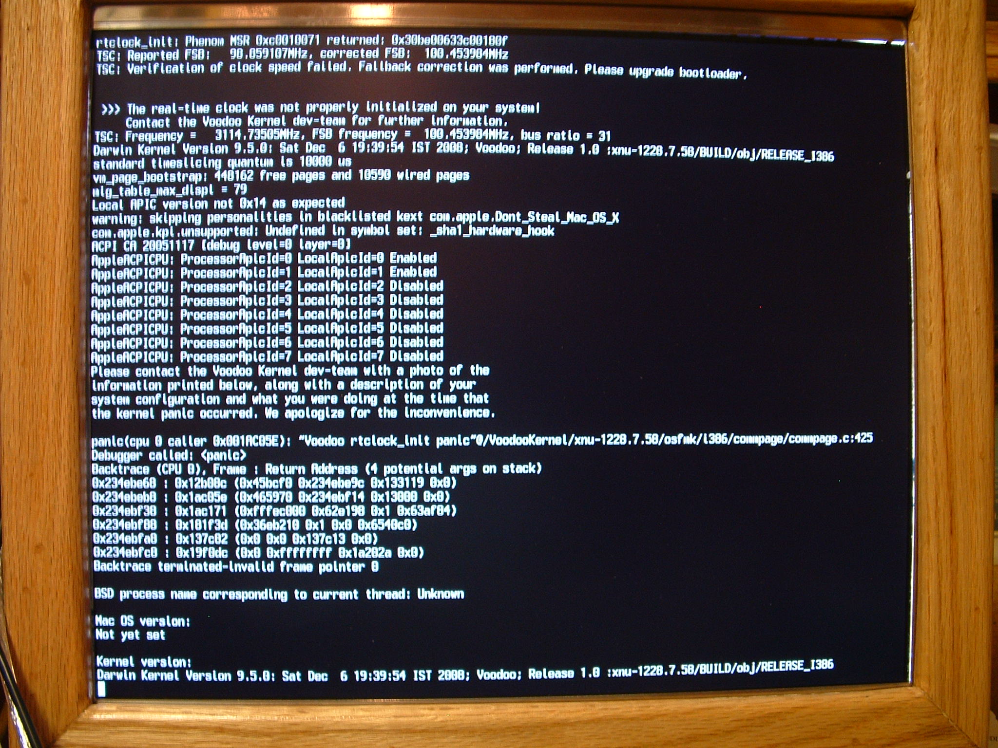

sirbow2 Posted May 26, 2010 Share Posted May 26, 2010 i am trying to install ideneb v1.6 on these specs: "Distro: *iDeneb 10.5.8 Lite edition* AMD anthlon II 3.0GHz dual core mobo= ga-ma785gm-us2h BIOS Version: F11(latest) 500gb sata 7200 hard drive bluray drive integrated graphics this was from the osx86 project wiki and was reported by someone to be fully functional. the only difference is they had a phenom II instead of an Anthlon II like i do. the issue i have is i get a kernel panic. i have uploaded the verbose output in a picture below Link to comment https://www.insanelymac.com/forum/topic/219488-ideneb-v16-lite-kernel-panic/ Share on other sites More sharing options...

sirbow2 Posted May 27, 2010 Author Share Posted May 27, 2010 i get this error when i try to boot the install dvd even before i have installed it to a HD Link to comment https://www.insanelymac.com/forum/topic/219488-ideneb-v16-lite-kernel-panic/#findComment-1476924 Share on other sites More sharing options...
sirbow2 Posted May 28, 2010 Author Share Posted May 28, 2010 i think i know how to fix but i havent tried it in the HCL in the osx86 wiki it said i need to use the boot flag "busratio=15" and it should work so i think this is solved Link to comment https://www.insanelymac.com/forum/topic/219488-ideneb-v16-lite-kernel-panic/#findComment-1477647 Share on other sites More sharing options...
