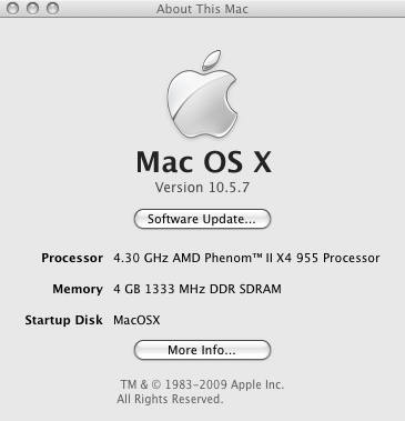

creative4art Posted May 26, 2010 Author Share Posted May 26, 2010 Check this bad boy out..! it says its running at 4.3GHz (per core) !!! Is that true reliable info or a bug? I have the CoolerMaster v10, so if any case there is heat, this bad boy can take care of it. Link to comment Share on other sites More sharing options...
