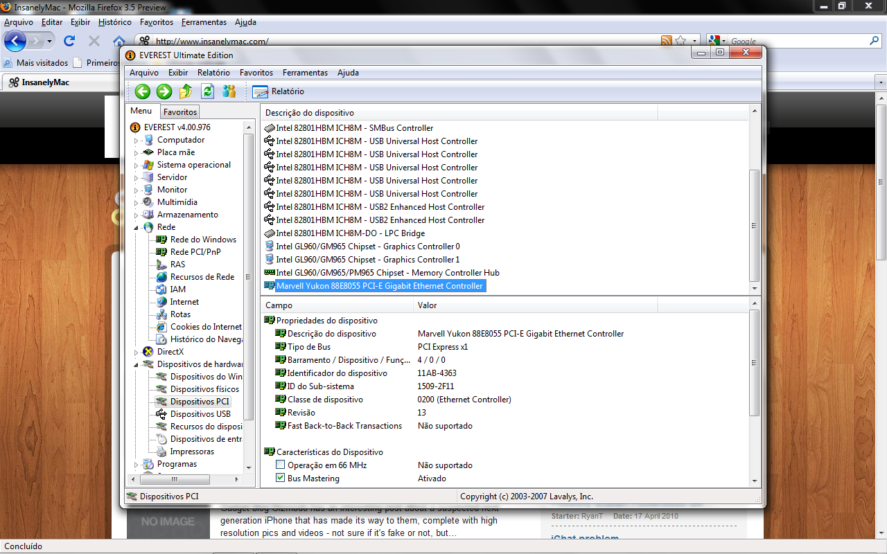

oldnapalm Posted April 27, 2010 Share Posted April 27, 2010 Use o Pacifist para extrair do dmg. A sua rede é 88E8055? Estranho não funcionar, porque ela já está na kext original. Qual o device ID? Link to comment https://www.insanelymac.com/forum/topic/214445-snow-ap%C3%B3s-instala%C3%A7%C3%A3o/page/3/#findComment-1456839 Share on other sites More sharing options...
avcoura Posted April 27, 2010 Author Share Posted April 27, 2010 tentei o comando mas deu o mesmo erro.... vou entrar no windows para eu ver a id da placa.. Link to comment https://www.insanelymac.com/forum/topic/214445-snow-ap%C3%B3s-instala%C3%A7%C3%A3o/page/3/#findComment-1456842 Share on other sites More sharing options...
oldnapalm Posted April 27, 2010 Share Posted April 27, 2010 Tente sem o formato e o nome sudo diskutil mergePartitions disk0s2 disk0s3 Pode ver o device ID pelo Snow (lspci -nn). http://www.osx86.es/?p=620 Link to comment https://www.insanelymac.com/forum/topic/214445-snow-ap%C3%B3s-instala%C3%A7%C3%A3o/page/3/#findComment-1456851 Share on other sites More sharing options...
avcoura Posted April 27, 2010 Author Share Posted April 27, 2010 Vou tentar executar o comando.. Agora já era..xD Link to comment https://www.insanelymac.com/forum/topic/214445-snow-ap%C3%B3s-instala%C3%A7%C3%A3o/page/3/#findComment-1456877 Share on other sites More sharing options...
oldnapalm Posted April 27, 2010 Share Posted April 27, 2010 Pois é, 4363, já está na kext, deveria funcionar direto. Talvez precise da IOPCIFamily modificada, como o meu Aspire 5920, veja no link da minha assinatura. Link to comment https://www.insanelymac.com/forum/topic/214445-snow-ap%C3%B3s-instala%C3%A7%C3%A3o/page/3/#findComment-1456886 Share on other sites More sharing options...
