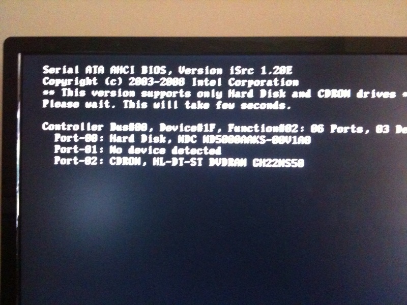

Richdave Posted April 2, 2010 Author Share Posted April 2, 2010 I have reflashed the BIOS and cleared CMOS by removing battery and shorting the CLR pins to be certain. This has not helped... I am able to use the SATA port with other drives OK too. This is what I see when I boot with the problematic HDD on SATA port 3. If I put it on any other port (I have 8) it halts at that point... Link to comment https://www.insanelymac.com/forum/topic/214212-can-boot-hdd-via-usb-but-not-sata/#findComment-1440075 Share on other sites More sharing options...
