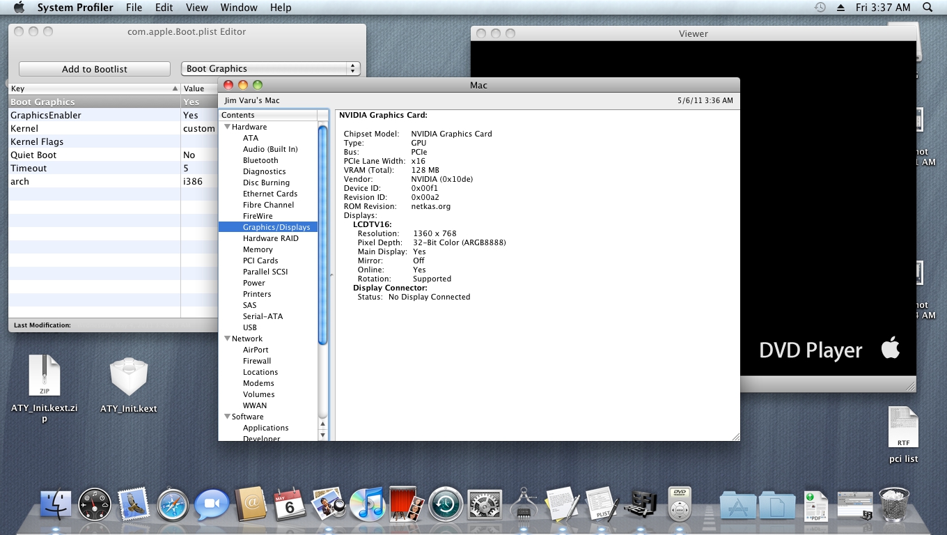

wonderbgr 0 Posted May 6, 2011 Share Posted May 6, 2011 Γεια χαρα!!! Εχω βαλει και εγω leopard (iatkosv7) και SnowLeopard (iatkos S3 v2) σε ενα δεινόσαυρο που εχω !! και μαλλον θα κρατησω το SL!!! Συστημα: Pentium4 Prescott 3.0Ghz sse3 (478socket) Albatron PX865PE PRO (Intel 865PE/ICH5) 2 GB Ram nVidia 6600GT AGP 128MB (qe/ci μονο με ATY_Init.kext 32bit) την βλεπει σαν PCIe ... εχω ανεβασει και 1 screenshot. Sound OnBoard AC97 (με AppleAC97Audio.kext) Lan OnBoard (με tulip.kext)( xcode3.2 και re-compile to src apo darwin_tulip 3rd part drivers....) WD Raptor 36GB sata1.. και LG-DVD-RW ide BIOS Settings: (HT Disabled ,Sata Enhanced mode Enabled, AGP/PCI/SRC 66.6/33.3/100 Manual) installed options (iatkos s3 v2)10.6.3 iATKOS S3 Main System Bootloader(AsereBLN v1.19) Bootloader Opt(32-bit boot,Graphics Enabler) /Extra directory(fakesmc V2.5, Disabler, RTC(32bit), Modified Kernels(qoopz 10.3.0), EVO Reboot) Main Hardware(Intel SATA, Voodoo PS/2, NTFS3G) Sound (Voodoo HDA; Apple HDA 10.6.2) Αυτα!.. Ολα τα .kext Τα φορτωσα με το Kext Utility v2.3 x64 σε γλιτωνει απο γραψιμο! Link to post Share on other sites

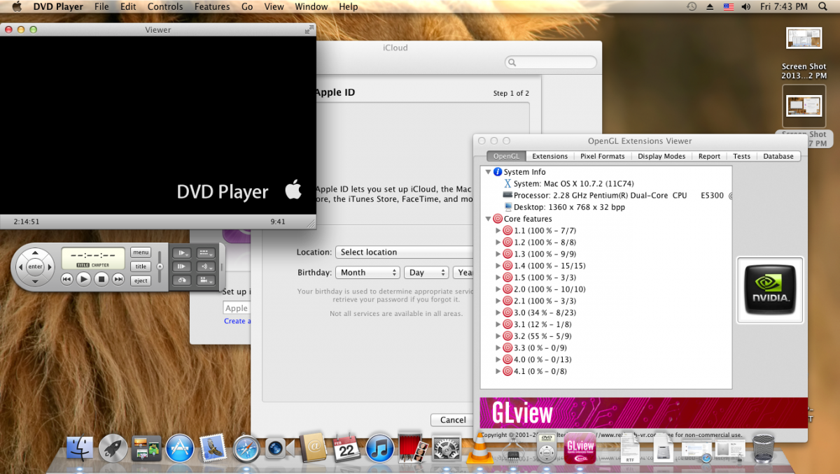

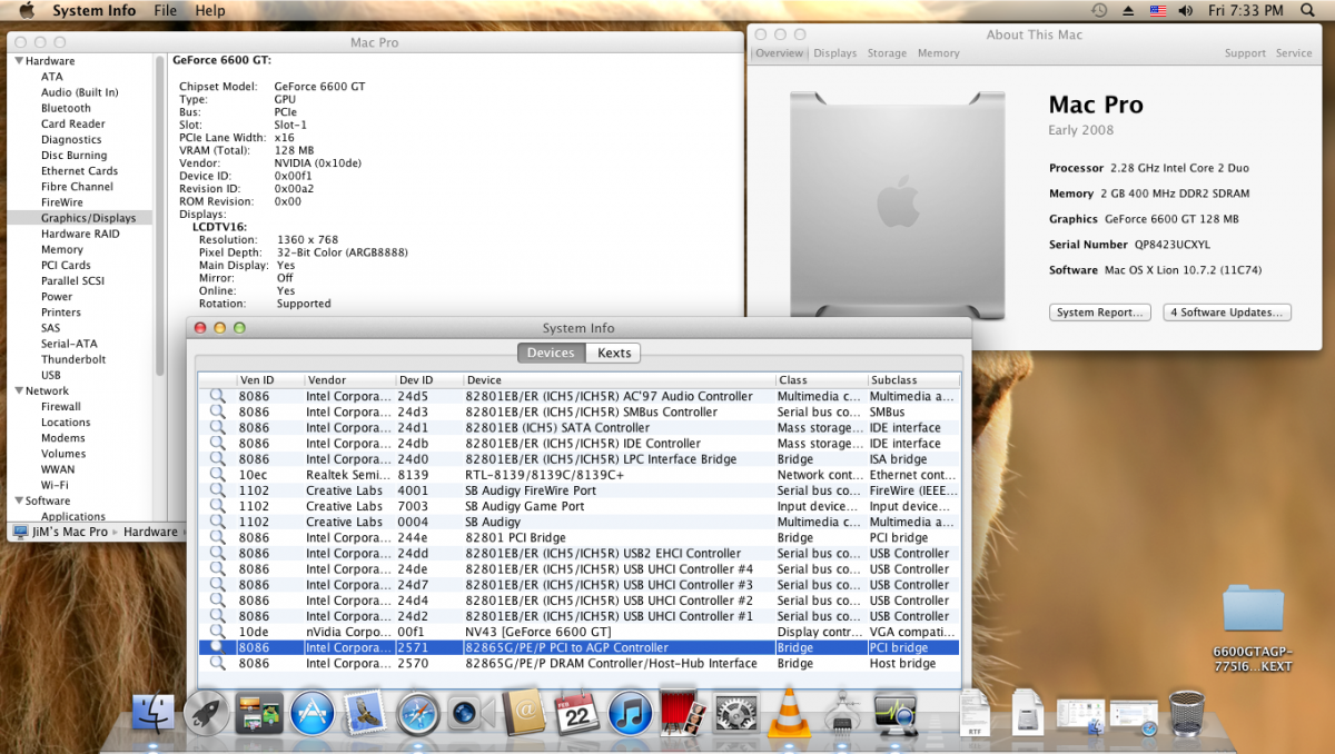

wonderbgr 0 Posted February 22, 2013 Share Posted February 22, 2013 Μετa aπο πολυ πολυ κοπο... OSX LION 10.7.2 on living dinosaur!! 32bit mode ONLY se 64bit δεν τρεχουν VGA,LAN,SOUND.... 775i65G R2.0- Intel® 865G - ICH5 Intel® Pentium® Processor E5300 GeForce 6600 GT '''AGP''' 128MB Cmedia 9761A Realtek PCI LAN 8101L 2GB Dual Channel DDR400 (2x1GB) Raptor 36GB Sata 3.5", Seagate 250GB Sata 2.5", Maxtor 40GB IDE Installation: * '''iAtkos L2''' dvd '''modded''' with http://www.osx86.net...y_for_lion.html IOATAFamily for Lion] (a modded IOATAFamily (v2.5.1) from the 10.7.0 Lion Install Disk Image. It enables booting and installing from SATA IDE Enhanced/Compatible Mode. It's for those who can't boot/install with AHCI nor have this option in BIOS. ONLY FOR ICHx-based SATA chipsets/southbridges.) *Bootloader: chameleon 2.1 *Bootloader options: built in ethernet, 32bit boot *Patches: **fakeSMC **Disabler: RTC **evoreboot *Drivers: **Main Hardware: NON ACHI SATA *PS/2 '''Kexts:''' GeForce 6600 GT AGP 128MB http://www.mediafire.com/?a3dnqwln2dM Cmedia 9761A on board http://www.insanelym...rd-i386x86-64/ Volume slider don't work (classic bug...) Realtek PCI LAN 8101L on board http://osx86kexts.cl....com/browse.php PCGenRTL8139Ethernet.kext] 8139:10EC Link to post Share on other sites
SomniusX 2 Posted February 25, 2013 Author Share Posted February 25, 2013 κaλή πaτέντa πέτυχες, κaι σε 32bit ντaξ χάνεις aλλά τουλάχιστον πaίζει! Link to post Share on other sites
