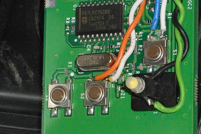

Roykjepolse Posted February 8, 2010 Share Posted February 8, 2010 PLEASE, I NEED HELP!!! I'M DESPERATE!!! I'm modding a Powermac G4 (digital audio) and i'm almost done. The only problem i have is that i don't know how to adapt the power button panel to the mobo's own panel connector. The mobo's an ASUS P5KPL-AM. I got the mobo's diagram here. IF U DON'T HELP ME... well.. errr... i dunno... The way i did it. I used the original PCB, omit the electronic by cut the original copper lines to the switches, and soldred wires directly to the switches and the LED for power on. This is working wery well, and i'm pleased. Link to comment https://www.insanelymac.com/forum/topic/208138-powermac-g4-power-buttons-with-atx-mod/#findComment-1406364 Share on other sites More sharing options...
bonestonne Posted February 9, 2010 Share Posted February 9, 2010 also how i did it on my G3...I don't have the time, patience or means to get the pinout. it's also much simpler when you think about it...eliminates a ribbon cable, and gives you just what you need or want. Link to comment https://www.insanelymac.com/forum/topic/208138-powermac-g4-power-buttons-with-atx-mod/#findComment-1406487 Share on other sites More sharing options...
