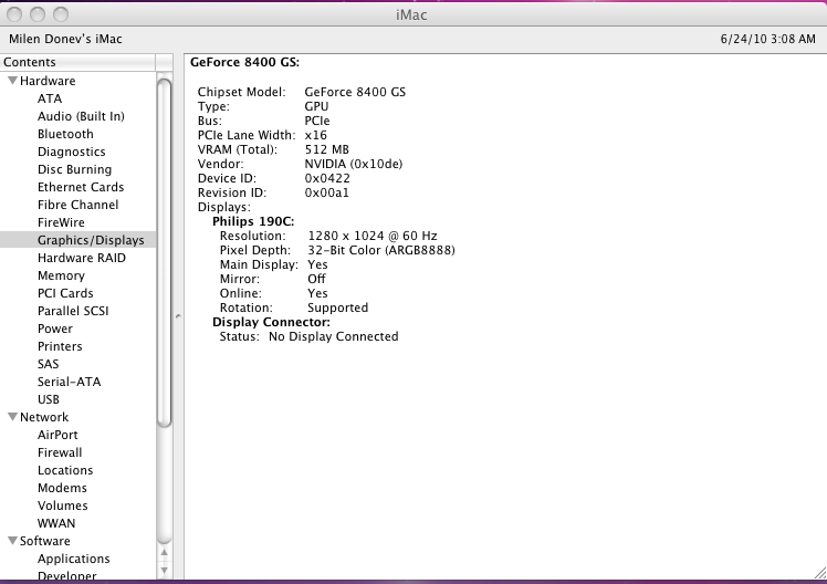

midonev Posted June 24, 2010 Share Posted June 24, 2010 Hello guys I am newbie for the mac world. I have Video card Nvidia 8400 GS 512 MB VRAM My hackintosh is Snow Leopard 10.6.2 by hazard. Where I can find driver for my video? Can you help me please... for now my system profiler detect my video card with this parameters. See attached picture for details. Link to comment https://www.insanelymac.com/forum/topic/204000-nv-8400-gs-0x0422-desktop-fully-working-qeqglci/page/4/#findComment-1497160 Share on other sites More sharing options...

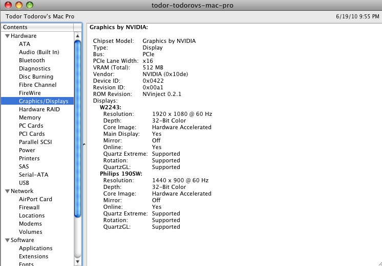

Logicpro9_user Posted July 21, 2010 Share Posted July 21, 2010 1.) Remove all Natit and NVinject kexts. 2.) Connect 2 monitors, 1 DVI (Secondary) and 1 VGA (Primary). 3.) Download and install NVIDIA 10.5.2 kexts and OpenGL from: http://scottdangel.com/blog/?p=18 3.) Edit NVCAPs to display: <04000000 00000100 02000000 00000000 00000000> 4.) Reboot and you should be getting something very similar: Graphics by NVIDIA: Chipset Model: Graphics by NVIDIA Type: Display Bus: PCIe PCIe Lane Width: x16 VRAM (Total): 256 MB Vendor: NVIDIA (0x10de) Device ID: 0x0422 Revision ID: 0x00a1 ROM Revision: NVinject 0.2.1 Displays: C383FA: Resolution: 832 x 624 @ 75 Hz Depth: 32-bit Color Core Image: Hardware Accelerated Main Display: Yes Mirror: Off Online: Yes Quartz Extreme: Supported QuartzGL: Supported Rotation: Supported Compaq WF1907: Resolution: 1440 x 900 @ 60 Hz Depth: 32-bit Color Core Image: Hardware Accelerated Mirror: Off Online: Yes Quartz Extreme: Supported QuartzGL: Supported Rotation: Supported 5.) Thats it there are no more steps unless you want to swap displays and such... Hi there, Your NVCAP worked on my XFX 8400GS or but I dont get.. Core Image: Hardware Accelerated Quartz Extreme: Supported QuartzGL: Supported in my About this mac (Graphics section) should I get this? This is what I get just now. Something is right I dont think. Anyone shine a light on this subject? NVIDIA Geforce 8400GS: Chipset Model: NVIDIA Geforce 8400GS Type: GPU Bus: PCIe Slot: PCIE X16 SLOT PCIe Lane Width: x16 VRAM (Total): 512 MB Vendor: NVIDIA (0x10de) Device ID: 0x06e4 Revision ID: 0x00a1 ROM Revision: nVidia GeForce 8400 GS OpenGL Engine Displays: Display Connector: Status: No Display Connected Acer AL2216W: Resolution: 1680 x 1050 @ 60 Hz Pixel Depth: 32-Bit Color (ARGB8888) Main Display: Yes Mirror: Off Online: Yes Rotation: Supported Link to comment https://www.insanelymac.com/forum/topic/204000-nv-8400-gs-0x0422-desktop-fully-working-qeqglci/page/4/#findComment-1515619 Share on other sites More sharing options...
