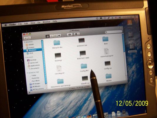

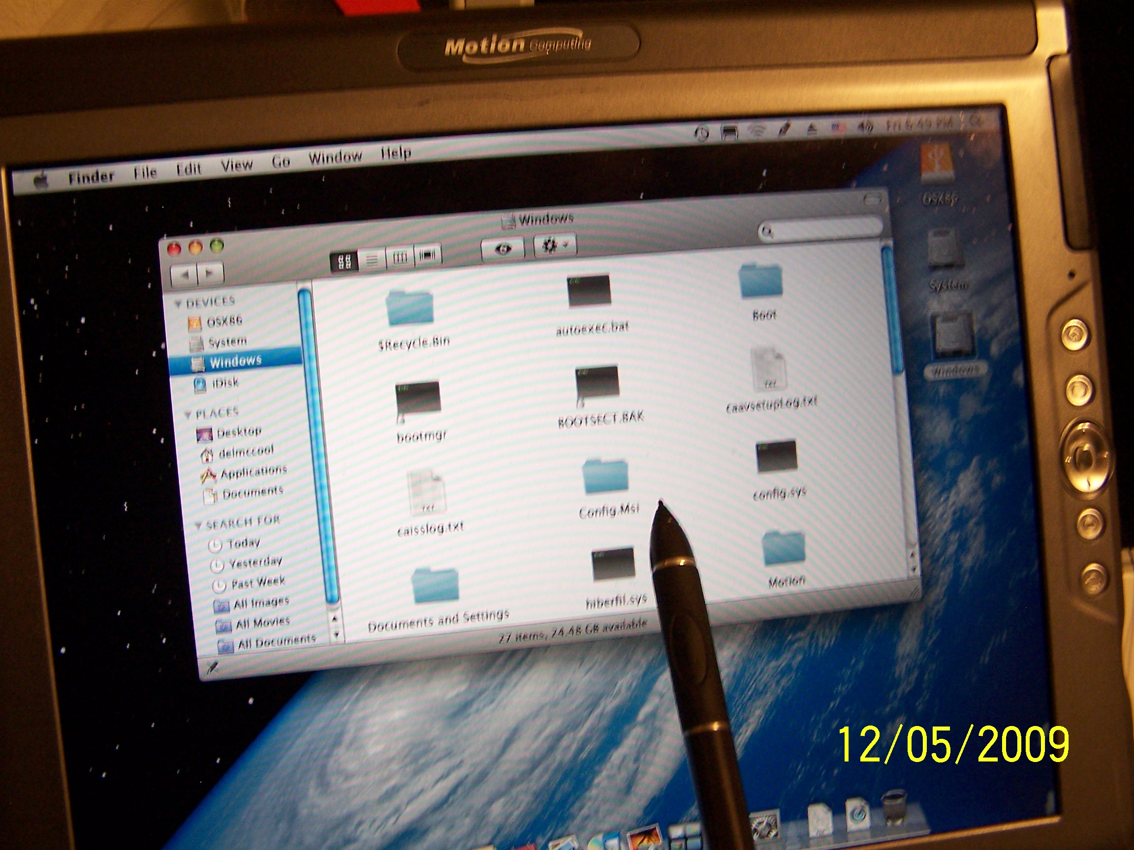

Sam_Bass Posted December 7, 2009 Share Posted December 7, 2009 On my main Hackintosh Pro (Lifehacker version) I run 10.6.2 all features working. On my Motion Computing LE1700 Tablet PC (MFG by Compal) I have 10.5.2 running with serial WACOM digitizer working. Still want to get the IDT sound card working, the battery meter, finger print reader... ANyone else doing this on a Motion Tablet. Mine is the Core 2 Duo 1.5 GHZ with 4 GB of memory, 80GB HDD. I had to do the video change to intel after install, then I loaded Tablet Magic for the WACOM digitizer. Link to comment https://www.insanelymac.com/forum/topic/201220-motion-computing-tablet-pc-le1700/ Share on other sites More sharing options...
