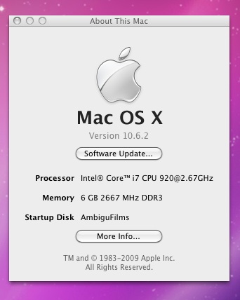

makosx Posted November 22, 2009 Author Share Posted November 22, 2009 Ok. That's how I get it. Clean with known issues. Then, update with Combo 10.6.2 via Apple Site Download (not Software Update); replace from Leopard 5.6 Sleepenabler netkas kext, delete dsmos and install fakesmc 2.5 from netkas again. Reboot in single user and do what dgsga says to do in Terminal with fakesmc, you know, chown -R root:wheel... etc. Reboot exiting -s mode, and go. Evrerything go. Audio (SoundMax 2000B) and graphic (nVidia Q Fx 3700) works. And perfect System Profiler reports about i7, BlueTooth, Firewire, Mem, etc... Thank you again, dgsga, and... I hope this is moved to another site "so we can all sleep safely tonight"... (inquisitor Bernardo Gui at The Name Of The Rose.) Greetings for all. . Link to comment Share on other sites More sharing options...
