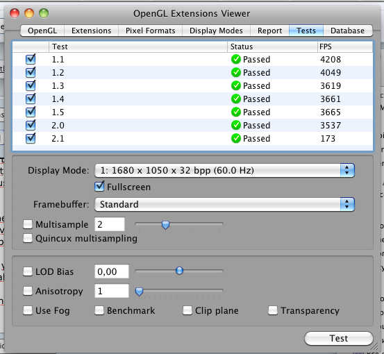

UPDATED 12.07.2009 added: dual dvi support
Hi all! I;ve made my vie card fully working now in my hackintosh and i'am really happy!
Thanks to all who is working on making hackintoshers life easier and noob friendly. I would like to post here my guide on how to make gtx 275 work with two monitors full QE-CI.
Let's start!

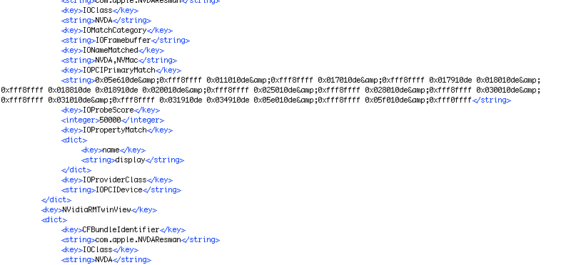

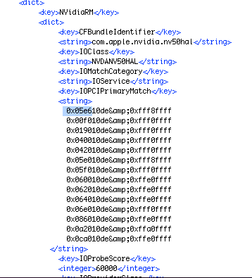

I.Preparation:
Go to /System/Library/Extensions/ and find
*NVDANV50Hal.kext
*NVDAResman.kext

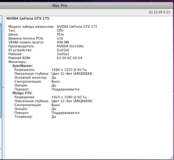

Copy them to your Desktop. Then open each info.plist in them and add your device id property there as shown on the screenshots. The device id could be found in About -> More info... -> Graphics/ Displays -> Device ID (also shown on screenshot).
Mine is 0x05e6 , suppose yours is the same.

Whats the device id of the GTX 275?
GeForce GTX 275:
Type: display
Driver Installed: Yes
Bus: PCI
Slot: Slot-1
Vendor ID: 0x10de
Device ID: 0x05e6
Subsystem Vendor ID: 0x1458
Subsystem ID: 0x0010
ROM Revision: xx.xx.xx - internal
Revision ID: 0x00a1
Link Width: x16
Link Speed: 2.5 GT/s

*NVDANV50Hal.kext
*NVDAResman.kext
