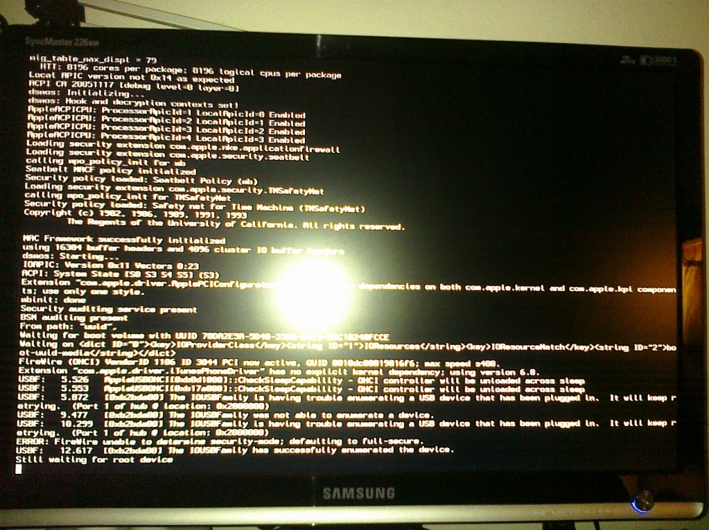

thegodfaza Posted October 30, 2009 Share Posted October 30, 2009 It's been a while since I've done anything with OSX86 so I could use some help with this install. Hardware is in signature. Right now I'm getting a "Still Waiting for Root Device" error. Output is attached. Sorry about the flash. It was needed to make the letters crisp. Otherwise they were blown out. I'm planing on putting Leopard on the 500GB Hard Disk. I'm trying to use Leo4All v4.1. Link to comment https://www.insanelymac.com/forum/topic/194936-putting-leopard-on-my-new-sli-pc/ Share on other sites More sharing options...
MacNutty Posted October 30, 2009 Share Posted October 30, 2009 Try booting from External USB DVD drive. Link to comment https://www.insanelymac.com/forum/topic/194936-putting-leopard-on-my-new-sli-pc/#findComment-1314526 Share on other sites More sharing options...
thegodfaza Posted October 31, 2009 Author Share Posted October 31, 2009 Try booting from External USB DVD drive. I don't have any of those laying around or any USB thumb drives large enough. Also I'm using a SATA 2 DVD drive. Should I try an EIDE one? Link to comment https://www.insanelymac.com/forum/topic/194936-putting-leopard-on-my-new-sli-pc/#findComment-1315479 Share on other sites More sharing options...
thegodfaza Posted November 4, 2009 Author Share Posted November 4, 2009 I was digging around in the BIOS and noticed that my SATA controller was set to IDE. I set it to AHCI and am attempting an install now. Now once I get it installed can I get SLI to work? I'm using 2 EVGA GTX 260's. Link to comment https://www.insanelymac.com/forum/topic/194936-putting-leopard-on-my-new-sli-pc/#findComment-1320314 Share on other sites More sharing options...

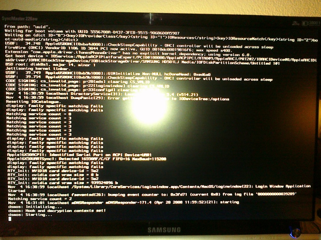

thegodfaza Posted November 5, 2009 Author Share Posted November 5, 2009 Ok, I have Leopard installed. But I have no audio, ethernet, or QE/CI. Trying to get QE/CI working first. Tried this with no luck. Also tried editing the NVDAN50.kext and NVDAResman.kext and putting my device ID in there(0x05e210de). The system just hangs on boot at "dsmos: Starting...". Link to comment https://www.insanelymac.com/forum/topic/194936-putting-leopard-on-my-new-sli-pc/#findComment-1320411 Share on other sites More sharing options...

thegodfaza Posted November 5, 2009 Author Share Posted November 5, 2009 n e t k a s.org/?p=105 Tried it and it didn't work. Also I installed Leo4All 10.5.4. I was going to install iATKOS 10.5.7 but the installer would hang at the gray screen with a pinwheel of death. From how I understood the install process you installed the NV drivers from the irc server first(OpenGL, NV Driver, and GForce Drivers) then ran the injector. Again sorry about the flash. Without it the letters are too blurred to read. Link to comment https://www.insanelymac.com/forum/topic/194936-putting-leopard-on-my-new-sli-pc/#findComment-1320521 Share on other sites More sharing options...
