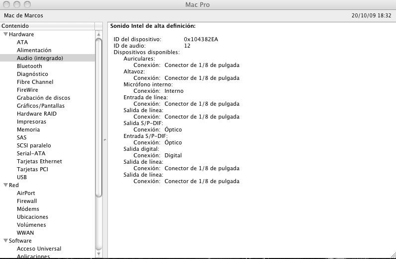

makosx Posted October 20, 2009 Share Posted October 20, 2009 It seems that SoundMax Digital Audio isn't so banished by Apple from SL onwards. After trying many times all kinds of solutions from those on the internet like AD2000b.kext, VoodooHDA.kext, etc, with which only got the famous "device id 0x..., audio id 12, available devices... none, and only the LineOut working in system preferences audio out, I finally got all in my sound card working combining the following: -AppleHDA.kext (from retail SL Extensions folder) -A kext named HDAEnabler from Kabyl (v 1.0.0d1 - (2008) -A kext named HDEFEnabler from Idon't know who (Copyrighted "MyCompanyName_2006) and nothing more. Anything named "voodoo" is on my computer. (But many thanx to voodoo owners for their help in leopard and so many times, of course!), so, now, this is my audio system profiler. And everything works, and everything is present in the Logic 9 and others audio applications and with full functionality. Link to comment https://www.insanelymac.com/forum/topic/193130-soundmax-2000b-ad2000b-on-asus-p6t-ws-intel-i7/ Share on other sites More sharing options...

makosx Posted October 21, 2009 Author Share Posted October 21, 2009 Ok, i will try (never do before in this forum) And, sorry, there aren't 3. I forgot AD2000b.kext (of a certain XyZ Corp 2009). There are 4 including AppleHDA.kext from retail SL. Install, you know, with Kext Helper and then run Kext Utility. I have nothing in the folder Extra except the Chameleon Themes (RC2) and, of course, the SMBIOS.plist (hide). Chameleon was installed with de Netkas bootloader. Ok, this is the zip. Good luck! Kext.zip Link to comment https://www.insanelymac.com/forum/topic/193130-soundmax-2000b-ad2000b-on-asus-p6t-ws-intel-i7/#findComment-1305695 Share on other sites More sharing options...

Nemes Posted November 2, 2009 Share Posted November 2, 2009 We solved this out 2 months ago. All you need is the AD2000B.kext, along with the newer 32bit/64bit version of HDAEnabler. You don't need both HDA and HDEF; they both do the same thing and can conflict with each other. Link to comment https://www.insanelymac.com/forum/topic/193130-soundmax-2000b-ad2000b-on-asus-p6t-ws-intel-i7/#findComment-1317252 Share on other sites More sharing options...
