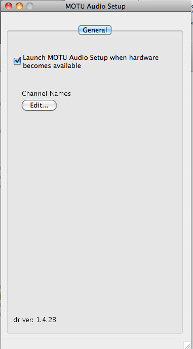

Noo_123 Posted October 12, 2009 Share Posted October 12, 2009 I have successfully install 10.6.1 on a intel mother board WX58BP. Everything is perfectly working. Right form Ethernet to onboard sound, Display card ( GT7300,256) , sata everything. … Have loaded lots of applications along with Logic 9, Spectrasonics, Kontakt etc. All are working fine. Now the problem is my sound card MOTU firewire MK2 is not working. I have tried installing the latest driver from the site- “MOTU_Audio_Installer-1.4.23.zip”. Tried changing the internal and onboard firewire cards. But avail no success. Anybody have any success story on the same. Please inform. Thanks OSX 10.6.1 using retails disk Intel WX58BP, i7 920, 4 x 2 GB DDR3@1333, 150GB WD Raptor, nVidia 7300GT,256mb Link to comment https://www.insanelymac.com/forum/topic/191593-motu-mk2-sound-card-with-snowleopard-1061/ Share on other sites More sharing options...

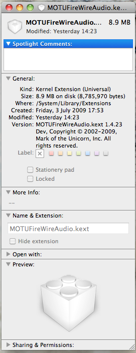

pangea2003 Posted November 11, 2009 Share Posted November 11, 2009 Hello to everyone, I'm a completely ignorant here but could someone explain me what do I have to do in order to boot with the mentioned arch=i386?? I tried this link in order to boot in32bit and 64bit alternatively and nothing... http://blogs.zdnet.com/Apple/?p=4716&tag=rbxccnbzd1 The new imac boots in 32bit anyway, am I wrong? I have contacted the MOTU technical Support a million times and I have to say that they've been wasting my last 5 days assuring me that their new driver 1.4.23 for the MOTU Mk2 and Firewire interfaces is fully compatible with Snow Leopard... Any thoughts about this? Thanks! Eliseo Imac 3.06GHz 27", 10.6.2, MOTU MK2 Link to comment https://www.insanelymac.com/forum/topic/191593-motu-mk2-sound-card-with-snowleopard-1061/#findComment-1327138 Share on other sites More sharing options...

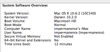

boiancs Posted December 23, 2009 Share Posted December 23, 2009 i had this same problem with several peices of audio equipment such as a Motu Interface, A Metric Interface and the UAD 2 DSP cards. None of these guys work in 64 bit mode, so you need to run snow leopard in 32 bit to get them happening. i fixed this problem by going into my extra's folder and change the com.apple.boot.ptlist - i changed the <string>arch=x86_64 ..... from "64" to "32" when i rebooted i was then rebooting in 32 bit mode. you can check to see if your snow leopard in running in 32 bit mode by going to: About this Mac -> More Into. Then click on the software section on the left. You will see "System Software Overview" come up on the right. 2nd from the bottom youll see 64-Bit Kernel and Extensions: No (if your in 32bit mode) or 64-Bit Kernel and Extensions: Yes (if your in 64bit mode) As soon as i got it to say no. then all of a sudden all my gear starting working. Link to comment https://www.insanelymac.com/forum/topic/191593-motu-mk2-sound-card-with-snowleopard-1061/#findComment-1367151 Share on other sites More sharing options...
