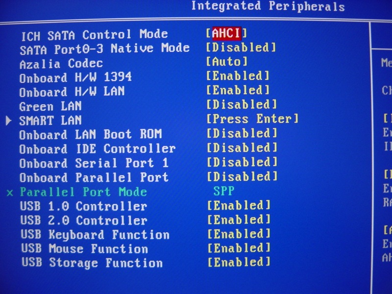

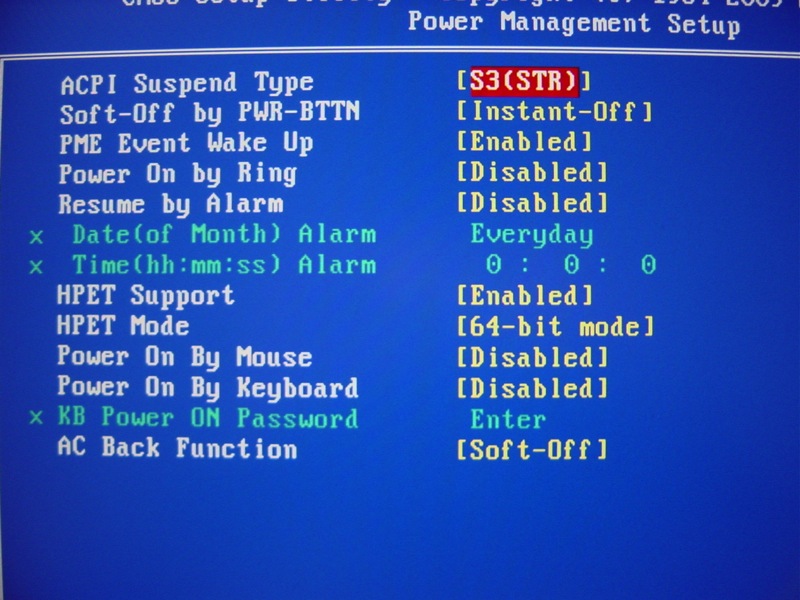

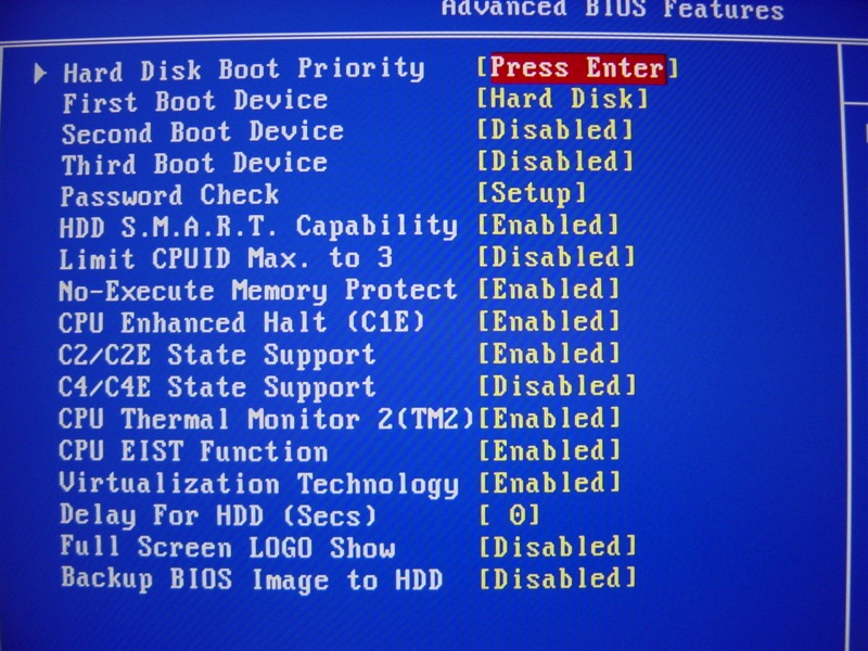

HELLFISH Posted November 12, 2009 Share Posted November 12, 2009 post the new dsdt so i can test your version as well.Maybe there's a difference when creating dsdt under windows or mac T. gonne reboot to get some bios pics (as you can see A sony cam) Thanks for those pics. I verified my BIOS settings to be the same, except I use native mode on AHCI. But that setting doesn't matter (I tried Legacy setting as well). But, I did figure out what is causing my sleep problems. It is my LG Blu-ray drive. I have an aluminum bezel over the front of the drive, so it matches my case (Lian Li 351). Looks very good, but I can not see the LED on the drive. I had the room dark, and when trying for sleep, I noticed that LED flashing like mad behind the bezel. SL was for some reason pulling the Blu-ray drive when attempting sleep. If I disconnect the drive, sleep just works! I'll post my DSDT version when it's done, but it's going to take some time as 1. I'm a noob, and 2. i have a large project coming to a close at work thats going to demand some time. Link to comment https://www.insanelymac.com/forum/topic/189914-gigabyte-ga-eg45m-ud2h-update-working-1062/#findComment-1328656 Share on other sites More sharing options...
tinush Posted November 12, 2009 Author Share Posted November 12, 2009 Thanks for those pics. I verified my BIOS settings to be the same, except I use native mode on AHCI. But that setting doesn't matter (I tried Legacy setting as well). But, I did figure out what is causing my sleep problems. It is my LG Blu-ray drive. I have an aluminum bezel over the front of the drive, so it matches my case (Lian Li 351). Looks very good, but I can not see the LED on the drive. I had the room dark, and when trying for sleep, I noticed that LED flashing like mad behind the bezel. SL was for some reason pulling the Blu-ray drive when attempting sleep. If I disconnect the drive, sleep just works! I'll post my DSDT version when it's done, but it's going to take some time as 1. I'm a noob, and 2. i have a large project coming to a close at work thats going to demand some time. Ok!, that also happened to me http://www.insanelymac.com/forum/index.php?showtopic=171929 As for most people here i'm also a noob, but with there help we can get it going..... T. Link to comment https://www.insanelymac.com/forum/topic/189914-gigabyte-ga-eg45m-ud2h-update-working-1062/#findComment-1328807 Share on other sites More sharing options...
