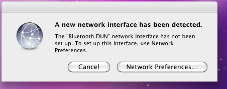

marionez Posted October 2, 2009 Share Posted October 2, 2009 I've got an issue even here. But I had no luck as you had. When I plug it in, something strange happens, a window appears with this: Beside this, there's nothing in network preferences and bluetooth can't reach anything, BT logo near clock is barred. I read on apple discussion that this could be related with SMC (==> fakesmc??), but I don't really know a way to solve this. Mine is not a DBT-122, at all, but I think the problem is not related with a specific model. Link to comment https://www.insanelymac.com/forum/topic/188071-dbt-122-bluetooth-dongle-in-snow-leopard/#findComment-1287433 Share on other sites More sharing options...

brodskive Posted October 3, 2009 Author Share Posted October 3, 2009 UPDATE: the DBT-122 stopped working the first time I put the machine to sleep.. I since haven't gotten it to work properly, the machine recognizes the hardware if I reconnect but the bluetooth pane just hangs when I try to set up or connect to a device.. Therefore I gave it up and went and bought a cheap mini bluetooth adapter (actually stating that it supports osx), and now everything is smoooth (including sleep) The chip in this is a Cambridge Silicon Radio.. marionez: I had the same dialoge, but just ignored it! but the bluetooth pane popped up once I plugged in my dongle.. Link to comment https://www.insanelymac.com/forum/topic/188071-dbt-122-bluetooth-dongle-in-snow-leopard/#findComment-1288788 Share on other sites More sharing options...
marionez Posted October 6, 2009 Share Posted October 6, 2009 So mine from linux is: Bus 003 Device 002: ID 0a5c:200a Broadcom Corp. Bluetooth dongle Device Descriptor: bLength 18 bDescriptorType 1 bcdUSB 1.10 bDeviceClass 224 Wireless bDeviceSubClass 1 Radio Frequency bDeviceProtocol 1 Bluetooth bMaxPacketSize0 64 idVendor 0x0a5c Broadcom Corp. idProduct 0x200a Bluetooth dongle bcdDevice 0.01 iManufacturer 1 Broadcom iProduct 2 BCM92035DGROM Brodskive I've got that window but pane for me doesn't appear, it's barred... Link to comment https://www.insanelymac.com/forum/topic/188071-dbt-122-bluetooth-dongle-in-snow-leopard/#findComment-1291926 Share on other sites More sharing options...
