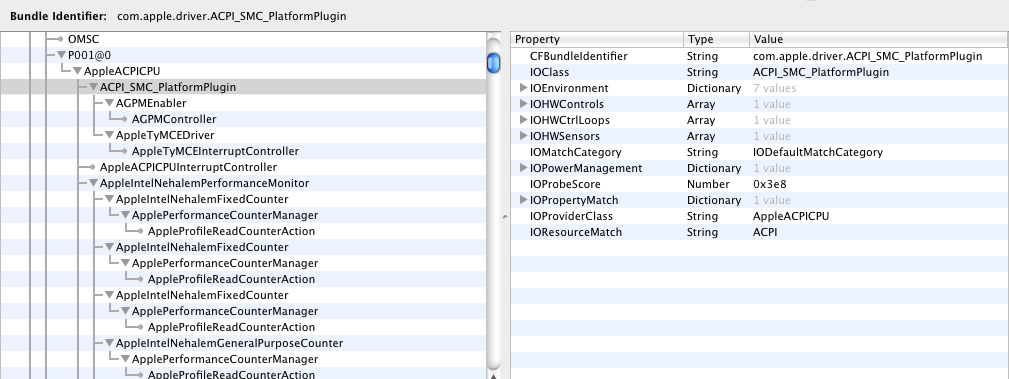

tweak41 Posted October 1, 2009 Share Posted October 1, 2009 So you have audio working in 64 bit mode ? Also, mind posting your ACPI_SMC entry in IORegistryExplorer ? Especially the PerformanceStateArray ? Don't use Extensions.mkext. For 3 ~ 7 kexts, the speed increase obtained is minimal at best. Better to just drop the mkext altogether. Also use PC EFI 10v3 because this one has 64bit EFI. I'm hesitant to use PC EFI 10v3 because the GraphicsEnabler option doesn't work with my GTX260. I have to use EFI strings instead which I find slightly annoying. Anyway I installed the XCode stuff, but can't find the PerformanceStateArray thing you're asking for under ACPI_SMC. Perhaps you could guide me further. Yes, audio works in 64-bit mode with the kexts I provided you earlier in this thread. Oh yeah harshw, did you try this by any chance in your DSDT? http://www.osx86.es/?p=691 Link to comment https://www.insanelymac.com/forum/topic/187988-need-help-installing-snow-leopard-on-p6t-se/page/3/#findComment-1286996 Share on other sites More sharing options...
harshw Posted October 1, 2009 Share Posted October 1, 2009 I'm hesitant to use PC EFI 10v3 because the GraphicsEnabler option doesn't work with my GTX260. I have to use EFI strings instead which I find slightly annoying. Anyway I installed the XCode stuff, but can't find the PerformanceStateArray thing you're asking for under ACPI_SMC. Perhaps you could guide me further. Yes, audio works in 64-bit mode with the kexts I provided you earlier in this thread. Check out this post in the other thread (post #35 ). I'm trying to get P & C states enabled in OSX. Once that is done, the system will drop the mult and idle at 2000 Mhz when not doing anything. Right now it idles at 3 GHz, thanks to the TRUE120 it stays at 45c, as opposed to 40c that it could be Link to comment https://www.insanelymac.com/forum/topic/187988-need-help-installing-snow-leopard-on-p6t-se/page/3/#findComment-1287076 Share on other sites More sharing options...
tweak41 Posted October 2, 2009 Share Posted October 2, 2009 Doesn't exist for me... Also, sleep stopped working at some point. Initially I believed it started to work because I switched to your DSDT.aml file. But I switched back to one on my machine and it worked again. Now sleep no longer works and I cannot figure out why. Maybe it's because I boot from a CF card and not from the HD... Link to comment https://www.insanelymac.com/forum/topic/187988-need-help-installing-snow-leopard-on-p6t-se/page/3/#findComment-1287183 Share on other sites More sharing options...

harshw Posted October 2, 2009 Share Posted October 2, 2009 Did you use this: http://www.osx86.es/?p=691 Because when I finally went through and did all that, I got the 10 values in PerformanceStateArray. Prior to that nothing I did made that show up. So the DSDT patch and the kext worked, I guess. So what values did you use for the DSDT patch ? Link to comment https://www.insanelymac.com/forum/topic/187988-need-help-installing-snow-leopard-on-p6t-se/page/3/#findComment-1287567 Share on other sites More sharing options...

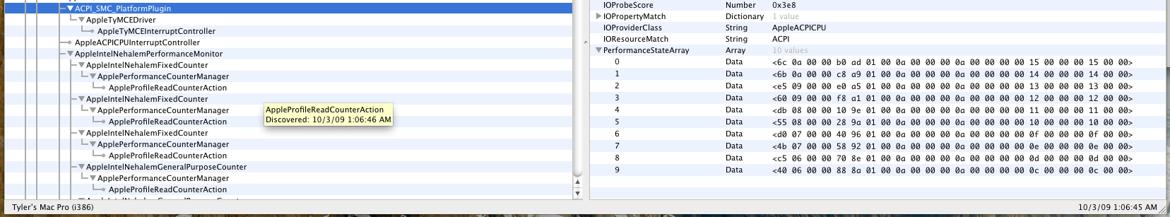

tweak41 Posted October 3, 2009 Share Posted October 3, 2009 I got sleep working again by removing OpenHaltRestart, so it's either Reboot/Shutdown or Sleep on my system. You shouldn't have to choose. Is there a newer version out somewhere? Is there a DSDT patch for that? harshw: Check out the image below. That's A LOT different than the one you posted. Mine is using that patch and kext... Link to comment https://www.insanelymac.com/forum/topic/187988-need-help-installing-snow-leopard-on-p6t-se/page/3/#findComment-1288147 Share on other sites More sharing options...
