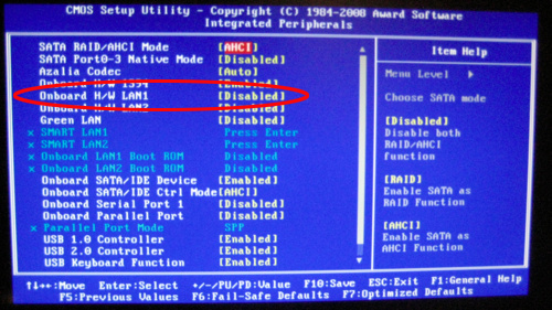

MacModifier Posted September 26, 2009 Author Share Posted September 26, 2009 Date of Update Sept 25, 2009***** UPDATE If you have this board and follow Lifehacker's Bios Settings make sure you don't change this one, it is probably why his ethernet did not work out of the box.***** So, I had some time tonight and went through my BIOS Settings to make sure they where exactly like the ones that Lifehacker posted on his tutorial because my settings where from when I had Leopard and what I was using was someone else's settings from a while back. I changed everything to match his settings, a couple of these where different and started wandering if that might be the cause of my Quicktime 8 Problems, anyway. One of the settings that I changed according to his was, the second Onboard H/W LAN. Here is the image. Everything worked fine on the re-boot up but I no longer had ethernet working. It was dead. So, knowing that it worked before I went and re-edited my bios, something changed on my bios that was stopping the internet from coming through now. I followed Lifehackers BIOS Settings to the letter. I thought it might be both my hard drives being set to "None" but still it did not work after I changed them back so I re-set them to None. Then I thought it has to do with my Lan Connection. I went to the BIOS, changed the second "Lan", the one under the one that says "Onboard H/W 1394 back to "Enabled" an we have a WINNER, WINNER, CHICKEN DINNER! Anyway, it works again so, what I have concluded; The reason why Lifehacker had to buy a separate internet card was because he turned that LAN connection off in his BIOS, that's what makes sense to me, so; If you have this board and follow his BIOS settings make sure you leave that Enabled so your internet will work from your motherboards built in ethernet card. I am also hoping since, I did change all of the other settings in my BIOS to be exactly like his BIOS settings, that it will clean up the other issues that I was having, I will report back latter. If anyone wants to post your thoughts or experiences with this board and setup good or bad feel free to do so. It is fun to read about how others are doing with there Hackintosh. Link to comment Share on other sites More sharing options...
Pablo et Pecador Posted September 26, 2009 Share Posted September 26, 2009 Date of Update Sept 25, 2009***** UPDATE If you have this board and follow Lifehacker's Bios Settings make sure you don't change this one, it is probably why his ethernet did not work out of the box.***** So, I had some time tonight and went through my BIOS Settings to make sure they where exactly like the ones that Lifehacker posted on his tutorial because my settings where from when I had Leopard and what I was using was someone else's settings from a while back. I changed everything to match his settings, a couple of these where different and started wandering if that might be the cause of my Quicktime 8 Problems, anyway. One of the settings that I changed according to his was, the second Onboard H/W LAN. Here is the image. Everything worked fine on the re-boot up but I no longer had ethernet working. It was dead. So, knowing that it worked before I went and re-edited my bios, something changed on my bios that was stopping the internet from coming through now. I followed Lifehackers BIOS Settings to the letter. I thought it might be both my hard drives being set to "None" but still it did not work after I changed them back so I re-set them to None. Then I thought it has to do with my Lan Connection. I went to the BIOS, changed the second "Lan", the one under the one that says "Onboard H/W 1394 back to "Enabled" an we have a WINNER, WINNER, CHICKEN DINNER! Anyway, it works again so, what I have concluded; The reason why Lifehacker had to buy a separate internet card was because he turned that LAN connection off in his BIOS, that's what makes sense to me, so; If you have this board and follow his BIOS settings make sure you leave that Enabled so your internet will work from your motherboards built in ethernet card. I am also hoping since, I did change all of the other settings in my BIOS to be exactly like his BIOS settings, that it will clean up the other issues that I was having, I will report back latter. If anyone wants to post your thoughts or experiences with this board and setup good or bad feel free to do so. It is fun to read about how others are doing with there Hackintosh. Good job guys. I just purchased some hardware for my hackintosh with the same specs as you except my board is EP45-UD3R. I'm waiting for the parts to come in. So, if I understand correctly, the LifeHacker tutorial will allow me to have sound/ethernet working out of the box along with the proper ID? I prepped the USB disk already and cant wait. I wonder why the lifehacker author didn't just enable the onboard ethernet. He chose rather to buy a another Lan card? Anyways, let me know if you got a chance to test out your hackintosh more. Link to comment Share on other sites More sharing options...
MacModifier Posted September 26, 2009 Author Share Posted September 26, 2009 Good job guys. I just purchased some hardware for my hackintosh with the same specs as you except my board is EP45-UD3R. I'm waiting for the parts to come in. So, if I understand correctly, the LifeHacker tutorial will allow me to have sound/ethernet working out of the box along with the proper ID? I prepped the USB disk already and cant wait. I wonder why the lifehacker author didn't just enable the onboard ethernet. He chose rather to buy a another Lan card? Anyways, let me know if you got a chance to test out your hackintosh more. Okay found out why he chose to get a separate ethernet card Answer came from member Stellarola: "You guys can use the onboard ethernet, there's just no bonjour support." As far as Sound/Ethernet OTB, Mine worked exactly as his tutorial said, I just had to go to the System Preferences and change the Output to "Line Out" and sound worked perfectly. Link to comment Share on other sites More sharing options...

dazz Posted October 5, 2009 Share Posted October 5, 2009 Date of Update October 3, 2009 ***** UPDATE, After reading other's posts, now understand why Lifehacker purchased a separate ethernet card.*****From what I read it appears that if you use the onboard ethernet card and I quote, "You guys can use the onboard ethernet, there's just no bonjour support." This came from member Stellarola. EP45 mobo have Realtek 8111B or Realtek 8111 for EP35, Gigabit LAN Controller yes there is something about this card preventing Bonjour to work properly, while i was reading, i see that a lot of people don't know, but Realtek has made drivers for mac due to PCI card i guess. and guess what it takes 10 sec to have bonjour working I have applied this here, i have three mobo EP45 RealTek download page : http://www.realtek.com.tw/downloads/downlo...GetDown=false#7 download the only driver for mac : - MacOS 10.4 and 10.5 on Intel-based Mac computer v2.0.3 2009/8/11 543k Download with Firefox, safari seems to have problems with it Link to comment Share on other sites More sharing options...
MacModifier Posted October 5, 2009 Author Share Posted October 5, 2009 EP45 mobo have Realtek 8111B or Realtek 8111 for EP35, Gigabit LAN Controller yes there is something about this card preventing Bonjour to work properly, while i was reading, i see that a lot of people don't know, but Realtek has made drivers for mac due to PCI card i guess. and guess what it takes 10 sec to have bonjour working I have applied this here, i have three mobo EP45 RealTek download page : http://www.realtek.com.tw/downloads/downlo...GetDown=false#7 download the only driver for mac : - MacOS 10.4 and 10.5�on Intel-based Mac computer v2.0.3 2009/8/11 543k Download with Firefox, safari seems to have problems with it Dazz, thanks for the update. To the people reading this, I have not personally used this technique so I CAN"T speak to it working or not working. Use this at your own risk. According to Dazz this works. Anyone who tires this update, please post your results in this thread so we can determine. Link to comment Share on other sites More sharing options...
