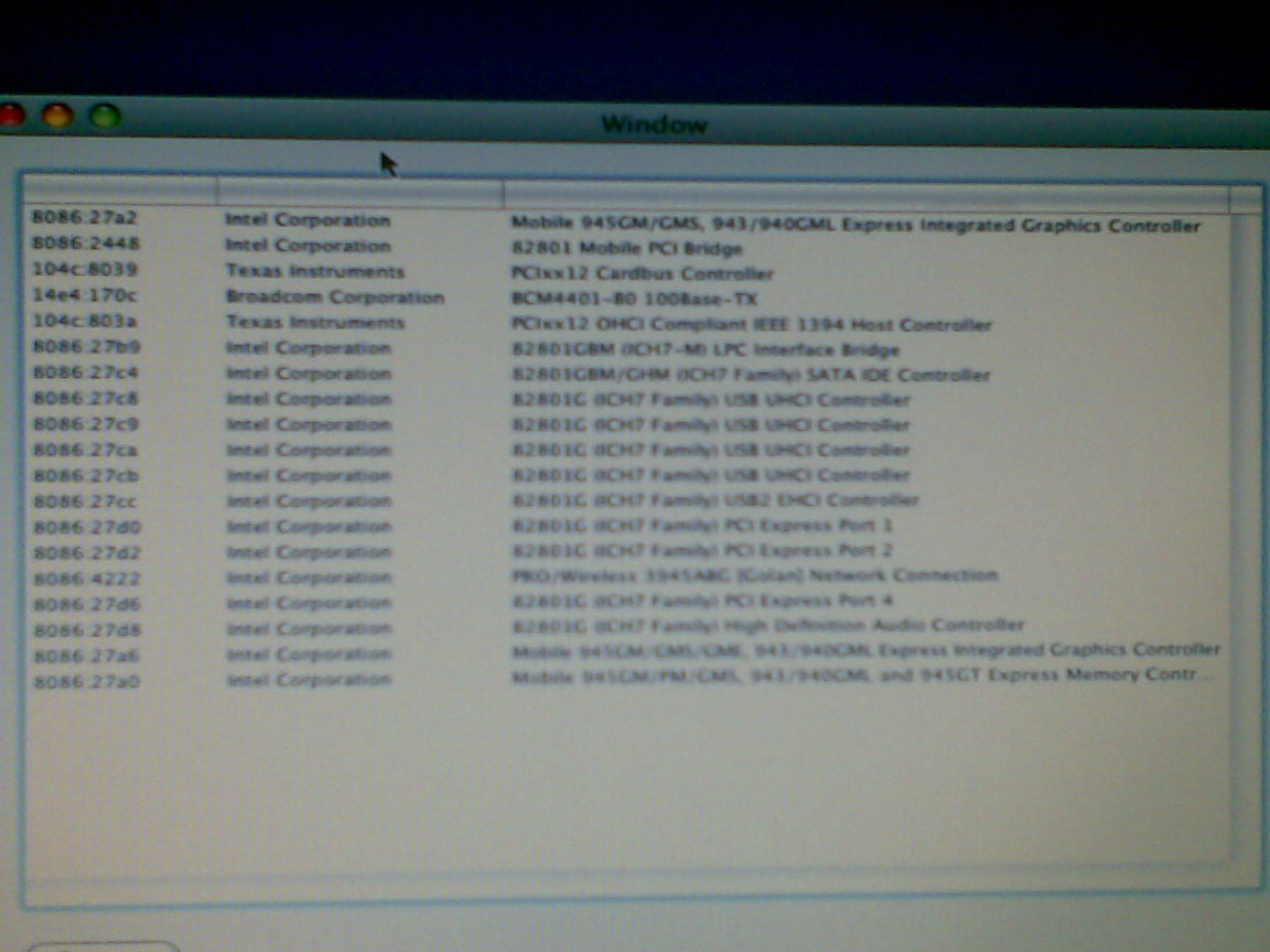

alex romania Posted September 14, 2009 Share Posted September 14, 2009 http://h20000.www2.hp.com/bizsupport/TechS...odTypeId=321957 - The hardware I'm running 10.5.8 Leopard without much issues, well it does crash unless i set cpus=1. The problem is i cannot seam to install SL(i keep getting KPs at boot), so i think im not using the right kext, can someone with more experience point me to what i should be using ? to boot up at least, rest i think i can find on my own. Link to comment https://www.insanelymac.com/forum/topic/186451-106-on-a-notebook-hp-nx7400/ Share on other sites More sharing options...

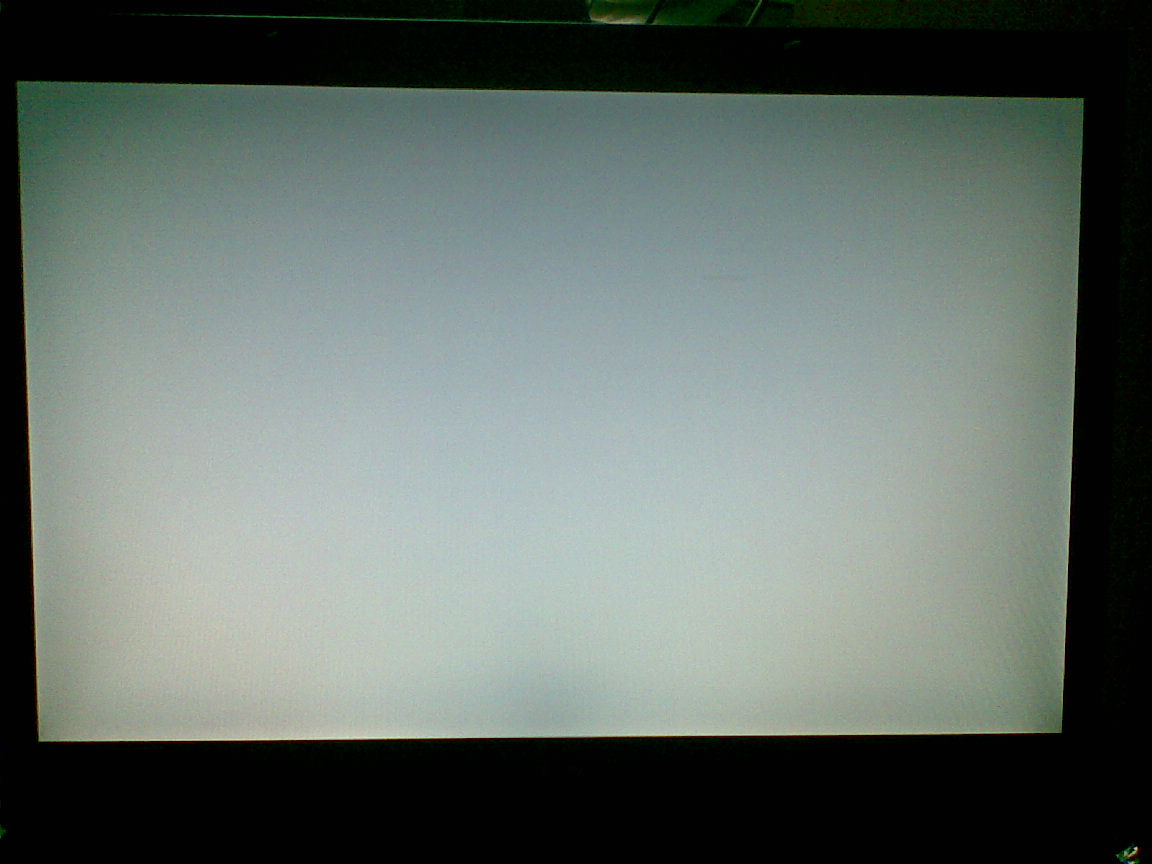

alex romania Posted September 14, 2009 Author Share Posted September 14, 2009 Now i dont have KPs but after it loads it just hangs like that in the pic. I cant say i notice any errors while it boots up. Link to comment https://www.insanelymac.com/forum/topic/186451-106-on-a-notebook-hp-nx7400/#findComment-1265672 Share on other sites More sharing options...
raykreisel Posted September 15, 2009 Share Posted September 15, 2009 I would suggest to boot with "-v" so you can see where the boot is stopping. It might also be an issue with your Intel GMA 950 graphics card. To get around this. You could boot single user and verbose "-s -v". then once you are in the single user shell mount -uw / mkdir /gfxbackup cd /System/Library/Extensions cp -r AppleIntelGMA* /gfxbackup rm -r AppleIntelGMA* exit that will then boot using the VESA graphic drivers which should work without a problem, so that at least you can finish the install and setup. The original drivers will be in /gfxbackup There is an alternative GMA 950 driver here Link to comment https://www.insanelymac.com/forum/topic/186451-106-on-a-notebook-hp-nx7400/#findComment-1267768 Share on other sites More sharing options...
alex romania Posted September 15, 2009 Author Share Posted September 15, 2009 Hi thanks for the reply, it just dosen't load the right kext, so a boot issue, seams it works only if i load the needed kext in the /System/Library/Extensions, or more likely im doing something wrong the Intel card was not a issue with efi string. Link to comment https://www.insanelymac.com/forum/topic/186451-106-on-a-notebook-hp-nx7400/#findComment-1267831 Share on other sites More sharing options...
