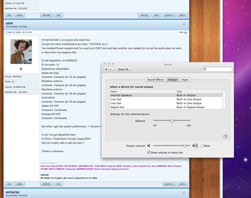

uzmi Posted September 22, 2009 Share Posted September 22, 2009 Hi HaChInToSh ( or anyone who tried this), I've got the same motherboard you have : P35 DS3L rev 2. I've installed Snow Leopard and I've used your DSDT.aml and later another one created by me but the audio does not work. In About this mac appears this: ID del dispositivo: 0x1458A002 ID de audio: 12 Dispositivos disponibles: Salida de línea: Conexión: Conector de 1/8 de pulgada Micrófono externo: Conexión: Conector de 1/8 de pulgada Micrófono externo: Conexión: Conector de 1/8 de pulgada Auriculares: Conexión: Conector de 1/8 de pulgada Salida S/P-DIF: Conexión: Combinado Entrada S/P-DIF: Conexión: Combinado But when I get into system preferences --> Sound--> no device appears in output or input. In S/L I've got AppleHDA.kext In Extra--> Extensions I've got LegacyHDA Did you modify, edit or add any kext ? Thanks in advance. Link to comment https://www.insanelymac.com/forum/topic/186065-guid-for-ga-p35-ds3l-rev20-vanilla-snow-leopard/#findComment-1276834 Share on other sites More sharing options...

swede420 Posted September 23, 2009 Author Share Posted September 23, 2009 Hi HaChInToSh ( or anyone who tried this),I've got the same motherboard you have : P35 DS3L rev 2. I've installed Snow Leopard and I've used your DSDT.aml and later another one created by me but the audio does not work. In About this mac appears this: ID del dispositivo: 0x1458A002 ID de audio: 12 Dispositivos disponibles: Salida de línea: Conexión: Conector de 1/8 de pulgada Micrófono externo: Conexión: Conector de 1/8 de pulgada Micrófono externo: Conexión: Conector de 1/8 de pulgada Auriculares: Conexión: Conector de 1/8 de pulgada Salida S/P-DIF: Conexión: Combinado Entrada S/P-DIF: Conexión: Combinado But when I get into system preferences --> Sound--> no device appears in output or input. In S/L I've got AppleHDA.kext In Extra--> Extensions I've got LegacyHDA Did you modify, edit or add any kext ? Thanks in advance. I have not modified anything. It is strange. I dont know what the problem might be! Does your mKext contain an extension that allows IDE drives to be read? As you can see in my sig I haven't been able to access an IDE drive that I use to share files with Windows. However I have no such problem with 10.5.8. Thanks I have not done that. But i have an IDE DVD drive and it is working well! Link to comment https://www.insanelymac.com/forum/topic/186065-guid-for-ga-p35-ds3l-rev20-vanilla-snow-leopard/#findComment-1278430 Share on other sites More sharing options...

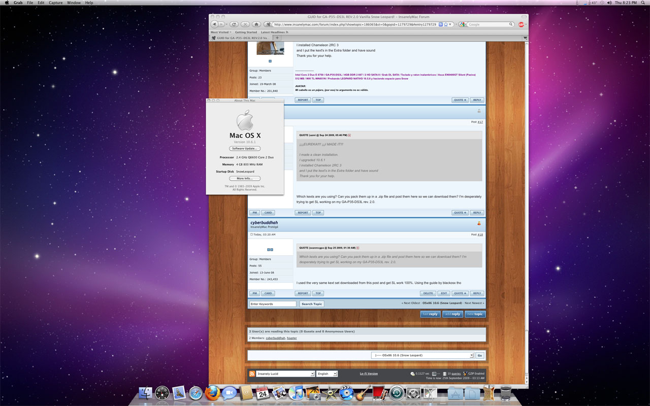

uzmi Posted September 24, 2009 Share Posted September 24, 2009 ¡¡¡¡EUREKA!!!! ¡¡¡I MADE IT!!! I made a clean installation. I upgraded 10.6.1 I installed Chameleon 2RC 3 and I put the kext's in the Extra folder and have sound Thank you for your help. Link to comment https://www.insanelymac.com/forum/topic/186065-guid-for-ga-p35-ds3l-rev20-vanilla-snow-leopard/#findComment-1279531 Share on other sites More sharing options...
seanmcgpa Posted September 25, 2009 Share Posted September 25, 2009 ¡¡¡¡EUREKA!!!! ¡¡¡I MADE IT!!! I made a clean installation. I upgraded 10.6.1 I installed Chameleon 2RC 3 and I put the kext's in the Extra folder and have sound Thank you for your help. Which kexts are you using? Can you pack them up in a .zip file and post them here so we can download them? I'm desperately trying to get SL working on my GA-P35-DS3L rev. 2.0. Link to comment https://www.insanelymac.com/forum/topic/186065-guid-for-ga-p35-ds3l-rev20-vanilla-snow-leopard/#findComment-1279674 Share on other sites More sharing options...
cyberbuddhah Posted September 25, 2009 Share Posted September 25, 2009 Which kexts are you using? Can you pack them up in a .zip file and post them here so we can download them? I'm desperately trying to get SL working on my GA-P35-DS3L rev. 2.0. I used the very same kext set downloaded from this post and get SL work 100%. Using the guide by blackosx though. This is my extra folder Extra.zip This is a set of LegacyHDA with different configurations that you may try to see which one u like the most LegacyHDA_888__ALC888_.zip Link to comment https://www.insanelymac.com/forum/topic/186065-guid-for-ga-p35-ds3l-rev20-vanilla-snow-leopard/#findComment-1279729 Share on other sites More sharing options...

uzmi Posted September 25, 2009 Share Posted September 25, 2009 Snow Gigabyte P35 DS3L v2 We need to create a file from Leopard DSDT.aml basic (at least with the correction of Device (RTC) so it does not unconfigurate the bios on every boot).I also added audio and graphics. Restart with SLBoot Change cd SLBoot for dvd Snow 10a432 Install (unchecking printers in Customize) Reboot after installation, again changing the DVD Snow for cd SLBoot Configure Upgrading to 10.6.1 and rebooting Install Chameleon 2RC 3 In the Extra folder create another folder called Extensions and install kext's: AHCIPortInjector fakesmc (version 2) IOAHCIBlockStorageInjector JMicronATA LegacyHDA NullCPUPowerManagement OpenHaltRestart PlatformUUID SleepEnabler Also put DSDT.aml Extra, com, apple.Boot.plist and smbios.plist (modify the settings according to your Hardware) Install and run kext Utility 2.3.2 Reboot .... And enjoy. Note: Every time I used to restart my computer the Bios used to unconfigurate until I used DSDT.aml http://www.megaupload.com/?d=R3VFU736 Link to comment https://www.insanelymac.com/forum/topic/186065-guid-for-ga-p35-ds3l-rev20-vanilla-snow-leopard/#findComment-1279826 Share on other sites More sharing options...
