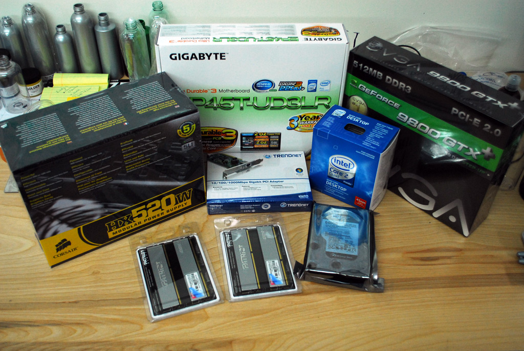

theorie Posted September 14, 2009 Author Share Posted September 14, 2009 well the parts came last friday and i've got the machine up and running. still waiting on the snow leopard install dvd to come... here are a couple of photos. Link to comment https://www.insanelymac.com/forum/topic/185550-build-ga-ep45t-ud3lr-q9550-8gb-ddr3-9800gtx-snow-leopard/#findComment-1265898 Share on other sites More sharing options...

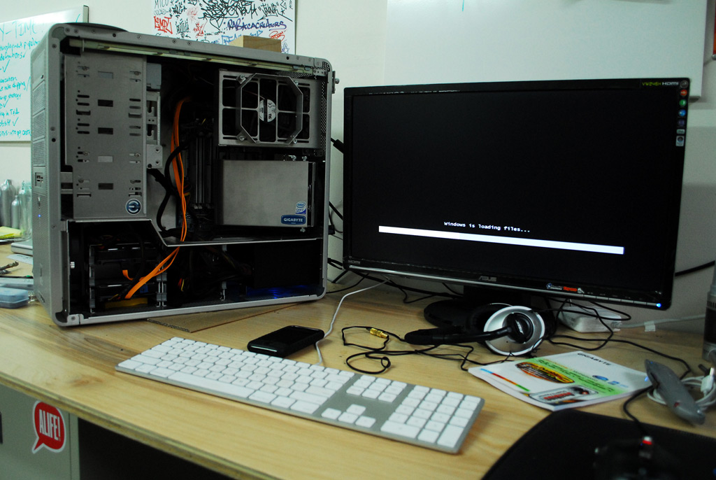

theorie Posted September 22, 2009 Author Share Posted September 22, 2009 well it's alive. running 10.6.1 with parallels and vista ultimate x64 installed. everything works, except for the sound...can't seem to find which kext will work for the ACL888 and ICH10R...help? anyway, here are some (crappy iphone 2g) photos and screenshots: updating 10.6 to 10.6.1 trying various audio kexts... desktop screenshot about this hackintosh Link to comment https://www.insanelymac.com/forum/topic/185550-build-ga-ep45t-ud3lr-q9550-8gb-ddr3-9800gtx-snow-leopard/#findComment-1276028 Share on other sites More sharing options...
