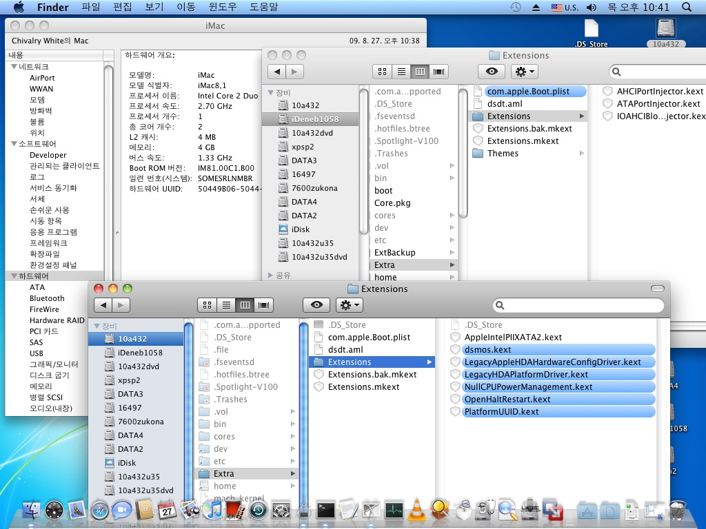

GoodWorld Posted September 3, 2009 Share Posted September 3, 2009 Hi. After trying 10a432 for several days, at last I succeeded in installing 10a432. ( 80% : sk1nhd33t`s Guide , 20% : my trial ) [ My PC : ASUS P5K + E6750 + 8600GT + SATA HDD ] =================================================================== Let`s collect nice infomations. This infomations will help ourselves from now on. ===================================================================== [ Essentials ] 1. A 10a432.dmg 2. BIOS : SATA Mode - Enhanced 3. An installed Leopard ( I am using iDeneb_v1.6_1058_Lite ) When I installed Leopard, I made 3 GUID Partitions as the following: Start by booting into your Leopard DVD and firing up Disk Utility. Select the disk you will use, and click on the "Partition" tab. Change the "Volume Scheme" drop down menu to "3 Partitions", and then click "Options...". Select GUID, and click ok. ( My 1st partition is iDeneb1058. My 2nd partition is 10a432. My 3rd partition is 10a432dvd. ) 4. 2 blank GUID Partitions ( 10a432 Partition & 10a432dvd Partition ) 5. DSDT Patcher GUI 1.0 6. 10a432p5k.zip ( unHideIT.v1.1.dmg + KextUtility.v2.3.2.dmg + AppleIntelPIIXATA2.kext + sk1nhd33t folder + AppleAzaliaAudio.kext ) ( In sk1nhd33t folder ) o cameleon-RC1-r431 o pc-efi-10.1 o Extra folder o apple.com.Boot.plist o smbios.plist o Extensions folder ( In Extensions folder ) o dsmos.kext o NullCPUPowermanagement.kext o PlatformUUID.kext o Openhaltrestart.kext o LegacyAppleHDAHardwareConfigDriver.kext o LegacyHDAPlatformDriver.kext o SleepEnabler.kext o Theme folder [ Installation ] 1. Install cameleon-RC1-r431 on Leopard, and replace the installed boot file in the root of Leopard with the boot file in pc-efi-10.1. ( Show all hidden files by using unHideIT.v1.1. ) ( From now on Leopard manages the boot infomations, so you don`t have to install chameleon-RC1-r431 & pc-efi-10.1(boot file) on 10a432 & 10a432dvd. ) 2. Restore 10a432.dmg to 10a432dvd by using Disk Utililty in Leopard ( Destination: 10a432dvd, Image: 10a432.dmg ). ( If you look at an Icon of MAC OS X Install DVD and a Window of MAC OS X Install DVD, just close the Window of MAC OS X Install DVD, otherwise you may get an "Install Failed" message ) ( In this step, don`t put other things [boot, kext, dsdt.aml ...] into 10a432dvd, otherwise you may see the KP[Kernel Panic]. ) 3. In the Desktop of Leopard, make the contents of Extra folder as the followings, and then copy the Extra folder to the root of 10a432dvd. - Extra folder in the Desktop of Leopard o apple.com.Boot.plist ( If you want, paste your gfx string in this plist. ) o smbios.plist ( Remove this plist. My 10a432 is likely to automatically get my system infos of the System Profiler without it. ) ( Don`t put UUID into apple.com.Boot.plist and PlatformUUID.kext. ) o Extensions.mkext ( You can use /Extra/Extensions.mkext in your Leopard. This Extensions.mkext was made when you installed the chameleon2-rc1-r431 on your Leopard. ) ( Use chameleon2-rc1-r431 Default Installation. (Chameleon Standard + Extras + Themes) ) o dsdt.aml ( Install DSDT Patcher GUI 1.0 on Leopard, and then put the installed dsdt.aml in the root of Leopard into the Extra folder of the Desktop. ) ( If you have your compiled/edited DSDT.aml, drop it into the Extra folder of the Desktop. ) o Theme folder ( Remove. ) - Extra/Extensions folder in the Desktop of Leopard o dsmos.kext ( If you use fakesmc.kext in this step, you may see the KP. But, after seeing the Desktop of 10a432, you can use fakesmc.kext. ) o NullCPUPowermanagement.kext o PlatformUUID.kext o Openhaltrestart.kext o LegacyAppleHDAHardwareConfigDriver.kext o LegacyHDAPlatformDriver.kext o AppleIntelPIIXATA2.kext ( iATKOS 10.5.7 ) ( After seeing the Desktop of 10a432, Use SleepEnabler.kext. ) ( Don`t use your kexts for /System/Library/Extensions in this step, otherwise you may see the KP. ) 4. After booting to 10a432dvd partition [-v -x32 or -v -f -x32 ], erase 10a432 partition by using Disk Utility and then install 10a432 on 10a432 partition. ( I didn`t install printer, rosseta, x11, quicktime7 ) ( This step is very important. If you skip this step, you must almost see the KP. ) ( Thanks to this step, we don`t have to put UUID into apple.com.Boot.plist and PlatformUUID.kext. ) ( Installation Time goes and comes from 20-minute to 17-minute. If you see 15-minute, you will mostly succeed. When you see 8-minute, the installstion screen will be black. Just click it by using your mouse, and it will come back. ^^ ) 5. First of all, go to Leopard, and then copy the Extra folder in the Desktop of Leopard to the root of 10a432 partition by using Terminal. ( In this step, you can use your kexts for /System/Library/Extensions, by the way if you use them, you will see the KP within a minute. But, don`t worry. After rebooting, you can solve this problem by using Disk Utility & Kext Utility. ) ( I didn`t use the permission commands [chown & chmod]. ) ( You can put AppleAzaliaAudio.kext into /System/Library/Extensions. ) Last login: Wed Aug 26 03:21:49 on console chivalry-whites-mac-pro:~ whitechivalry$ sudo -s Password: bash-3.2# cp -R /Users/whitechivalry/Desktop/Extra /Volumes/10a432 bash-3.2# cp -R /Users/whitechivalry/Desktop/work/10a432me/audio/org/AppleAzaliaAudio.kext /Volumes/10a432/System/Library/Extensions 6. It is time to go to 10a432. [-v -x32 or -v -f -x32] 7. On going to the Desktop, use Disk Utility [ RepairPermissions ] & KextUtility.v2.3.2.dmg. ============ [ Updated ( 2009-09-04 ) : I edited my post in some details. ] ----------------------(((( If you tell me my wrong infos, I will edit them. ))))---------------------------------------- Link to comment https://www.insanelymac.com/forum/topic/183943-success-3264-bit-p5k-vanilla10a4322009-09-04/ Share on other sites More sharing options...

Dr.Nemo Posted September 6, 2009 Share Posted September 6, 2009 hi all! sorry my english - Extra folder in the Desktop of Leopard ㅇ apple.com.Boot.plist ( If you want, paste your gfx string in this plist. ) ^^^^^^^^^^^^^^^^^^^^^^^^^^^^^^^^^^^^^^^^^^^^^^^found ㅇ smbios.plist ( Remove this plist. My 10a432 is likely to automatically get my system infos of the System Profiler without it. ) ^^^^^^^^^^^^^^^^^^^^^^^^^^^^^^^^^^^^^^^^^^^^^^^found ( Don`t put UUID into apple.com.Boot.plist and PlatformUUID.kext. ) ㅇ Extensions.mkext ^^^^^^^^^^^^^^^^^^^^^^^^^^^^^^^^^^^^^^^^^^^^^^^NOT FOUND in your 10a432p5k.zip file ㅇ Extensions folder ^^^^^^^^^^^^^^^^^^^^^^^^^^^^^^^^^^^^^^^^^^^^^^^found ㅇ dsdt.aml ( Install DSDT Patcher GUI 1.0 on Leopard, and then put the installed dsdt.aml in the root of Leopard into the Extra folder of the Desktop. ) ^^^^^^^^^^^^^^^^^^^^^^^^^^^^^^^^^^^^^^^^^^^^^^^found ( If you have your compiled/edited DSDT.aml, drop it into the Extra folder of the Desktop. ) ㅇ Theme folder ( Remove. ) ^^^^^^^^^^^^^^^^^^^^^^^^^^^^^^^^^^^^^^^^^^^^^^^found Link to comment https://www.insanelymac.com/forum/topic/183943-success-3264-bit-p5k-vanilla10a4322009-09-04/#findComment-1253536 Share on other sites More sharing options...

GoodWorld Posted September 6, 2009 Author Share Posted September 6, 2009 hi all sorry where i find this file -->ㅇ Extensions.mkext Sorry. You can use /Extra/Extensions.mkext in your Leopard. This Extensions.mkext was made when you installed the chameleon2-rc1-r431 on your Leopard. Link to comment https://www.insanelymac.com/forum/topic/183943-success-3264-bit-p5k-vanilla10a4322009-09-04/#findComment-1253596 Share on other sites More sharing options...

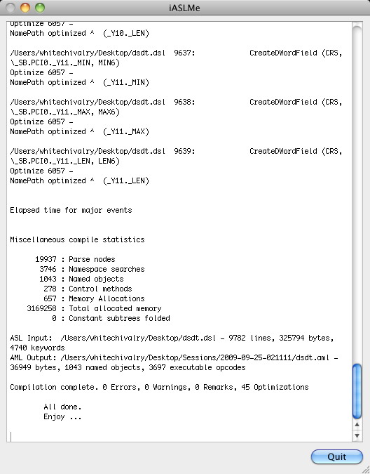

GoodWorld Posted September 17, 2009 Author Share Posted September 17, 2009 I am running both 32 bit Mode & 64 bit Mode by using Chameleon2 RC3 r658. ( BIOS : o SATA Mode - Enhanced o JMicron - Disabled ) - Realtek8139 : ( mostly working : 64bit ) ( I am using RTL8139 instead of AttansicL1Ethernet ( http://www.insanelymac.com/forum/index.php?showtopic=181566 ) - SATA Ports o AppleIntelPIIXATA2.kext from iATKOS1057 : ( Full working : SATA 1 , 2, 3, 4 Ports ) ( only 32 bit Mode ) o AppleIntelPIIXATA.kext from z0r : ( working : only SATA 1 , 2, Ports ) ( 32/64 bit Mode ) Can you tell me how to edit the info.plist of AppleIntelPIIXATA.kext ? I want to use SATA 3, 4 Ports in 64bit Mode. (( 10a432_P5K_PIIXATA(32_64).zip )) ------------------------- [64bit From z0r] ( AppleIntelPIIXATA.kext ) <key>ICH9 2 Port Serial ATA</key> <dict> <key>CFBundleIdentifier</key> <string>com.apple.driver.AppleIntelPIIXATA</string> <key>Controller Name</key> <string>ICH9 2 Port SATA</string> <key>IOClass</key> <string>AppleIntelPIIXATARoot</string> <key>IOPCIPrimaryMatch</key> <string>0x29218086 0x29268086</string> <key>IOProbeScore</key> <integer>2000</integer> <key>IOProviderClass</key> <string>IOPCIDevice</string> <key>PCS Port Map</key> <data> kgGTAZICkwKSBJMEkgiTCA== </data> <key>Serial ATA</key> <true/> <key>Supported Transfer Modes</key> <string>0x3f061d</string> </dict> <key>ICH9 Serial ATA</key> <dict> <key>CFBundleIdentifier</key> <string>com.apple.driver.AppleIntelPIIXATA</string> <key>Controller Name</key> <string>ICH9 SATA</string> <key>IOClass</key> <string>AppleIntelPIIXATARoot</string> <key>IOPCIPrimaryMatch</key> <string>0x29208086</string> <key>IOProbeScore</key> <integer>2000</integer> <key>IOProviderClass</key> <string>IOPCIDevice</string> <key>PCS Port Map</key> <data> kgGTAZICkwKSBJMEkgiTCA== </data> <key>Serial ATA</key> <true/> <key>Supported Transfer Modes</key> <string>0x3f061d</string> </dict> <key>ICH9-M Serial ATA</key> <dict> <key>CFBundleIdentifier</key> <string>com.apple.driver.AppleIntelPIIXATA</string> <key>Controller Name</key> <string>ICH9-M SATA</string> <key>IOClass</key> <string>AppleIntelPIIXATARoot</string> <key>IOPCIPrimaryMatch</key> <string>0x29288086 0x292d8086</string> <key>IOProbeScore</key> <integer>2000</integer> <key>IOProviderClass</key> <string>IOPCIDevice</string> <key>PCS Port Map</key> <data> kgGTAZICkwKSBJMEkgiTCA== </data> <key>Serial ATA</key> <true/> <key>Supported Transfer Modes</key> <string>0x3f061d</string> </dict> [32bit From iATKOS1057] ( AppleIntelPIIXATA2.kext ) <key>ICH9 2 Port Serial ATA</key> <dict> <key>CFBundleIdentifier</key> <string>com.apple.driver.AppleIntelPIIXATA</string> <key>Controller Name</key> <string>ICH9 2 Port SATA</string> <key>IOClass</key> <string>AppleIntelPIIXATARoot</string> <key>IOPCIPrimaryMatch</key> <string>0x29218086 0x29268086</string> <key>IOProbeScore</key> <integer>2000</integer> <key>IOProviderClass</key> <string>IOPCIDevice</string> <key>PCS Port Map</key> <data> kgGTAZICkwKSBJMEkgiTCA== </data> <key>Serial ATA</key> <true/> <key>Supported Transfer Modes</key> <string>0x3f061d</string> </dict> <key>ICH9-R 4 Port Serial ATA</key> <dict> <key>CFBundleIdentifier</key> <string>com.apple.driver.AppleIntelPIIXATA</string> <key>Controller Name</key> <string>ICH9-R 4 Port SATA</string> <key>IOClass</key> <string>AppleIntelPIIXATARoot</string> <key>IOPCIPrimaryMatch</key> <string>0x29208086</string> <key>IOProbeScore</key> <integer>2000</integer> <key>IOProviderClass</key> <string>IOPCIDevice</string> <key>PCS Port Map</key> <data> kgGTAZICkwKSBJMEkgiTCA== </data> <key>Serial ATA</key> <true/> <key>Supported Transfer Modes</key> <string>0x3f061d</string> </dict> <key>ICH9-M 2 Port Serial ATA</key> <dict> <key>CFBundleIdentifier</key> <string>com.apple.driver.AppleIntelPIIXATA</string> <key>Controller Name</key> <string>ICH9-M 2 Port SATA</string> <key>IOClass</key> <string>AppleIntelPIIXATARoot</string> <key>IOPCIPrimaryMatch</key> <string>0x29288086 0x292d8086</string> <key>IOProbeScore</key> <integer>2000</integer> <key>IOProviderClass</key> <string>IOPCIDevice</string> <key>PCS Port Map</key> <data> kgGTAZICkwKSBJMEkgiTCA== </data> <key>Serial ATA</key> <true/> <key>Supported Transfer Modes</key> <string>0x3f061d</string> </dict> Link to comment https://www.insanelymac.com/forum/topic/183943-success-3264-bit-p5k-vanilla10a4322009-09-04/#findComment-1269461 Share on other sites More sharing options...
GoodWorld Posted September 22, 2009 Author Share Posted September 22, 2009 Hmm... Where are P5K Users ? Who tried the dsdt.aml (alc883, sata, attantic l1, graphic card ...) ? Link to comment https://www.insanelymac.com/forum/topic/183943-success-3264-bit-p5k-vanilla10a4322009-09-04/#findComment-1276392 Share on other sites More sharing options...
GoodWorld Posted September 28, 2009 Author Share Posted September 28, 2009 - SATA Portso AppleIntelPIIXATA2.kext from iATKOS1057 : ( Full working : SATA 1 , 2, 3, 4 Ports ) ( only 32 bit Mode ) o AppleIntelPIIXATA.kext from z0r : ( working : only SATA 1 , 2, Ports ) ( 32/64 bit Mode ) Can you tell me how to edit the info.plist of AppleIntelPIIXATA.kext ? I want to use SATA 3, 4 Ports in 64bit Mode. I am waiting for DuNe` work. ( http://www.insanelymac.com/forum/index.php?showtopic=186609 ) ( http://www.insanelymac.com/forum/index.php...0&start=300 ) -------- ( http://ubuntuforums.org/showthread.php?t=1036051&page=32 ) I found out the solution which can fix the 6 warnings of dsdt.aml. This is likely to help some asus users. After applying it, my system was a bit faster. (1) After opening your dsdt.aml by using Text Editor, search the 3 followings: Method (VGET, 1, NotSerialized), Method (TGET, 1, NotSerialized), Method (FGET, 1, NotSerialized) (2) Add Return (Zero) (3) Refer to the following: Name (VBUF, Package (0x05) { 0x04, CORV, V3VV, V5VV, VV12 }) Method (VGET, 1, NotSerialized) { If (LEqual (Arg0, Zero)) { Return (^^SIOR.HWV0 ()) } If (LEqual (Arg0, One)) { Return (^^SIOR.HWV3 ()) } If (LEqual (Arg0, 0x02)) { Return (^^SIOR.HWV5 ()) } If (LEqual (Arg0, 0x03)) { Return (^^SIOR.HWV1 ()) } Return (Zero) } Name (CPUT, Package (0x05) Link to comment https://www.insanelymac.com/forum/topic/183943-success-3264-bit-p5k-vanilla10a4322009-09-04/#findComment-1283605 Share on other sites More sharing options...
