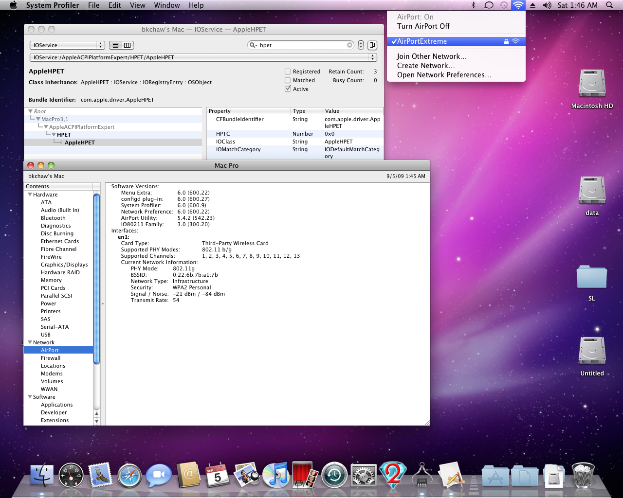

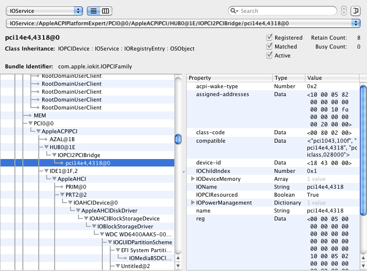

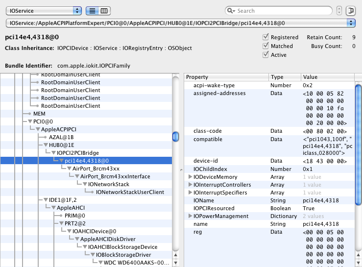

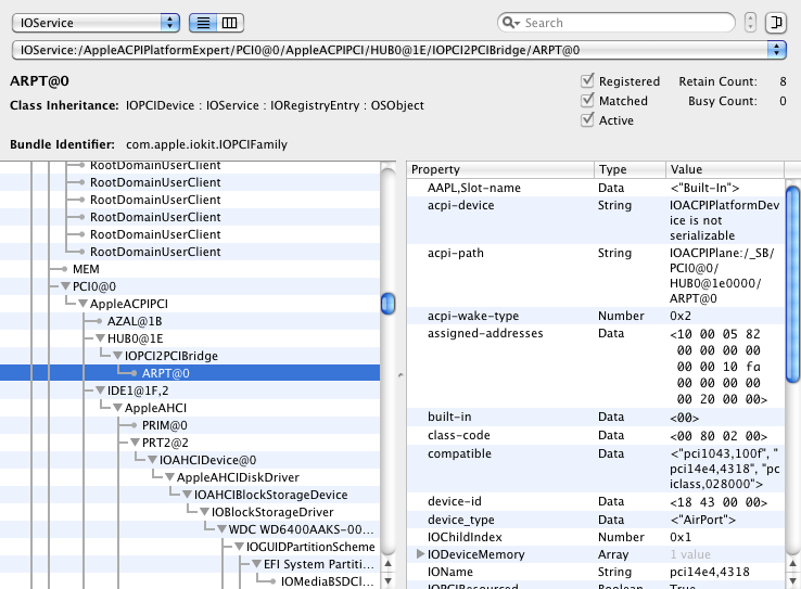

alexkidd Posted September 4, 2009 Share Posted September 4, 2009 A Google search seems to indicate that dsdt mod is not compatible with wireless, not only on OS X but on Linux as well. @alexkidd, you are so close already. Any progress? finally got HPET and wireless working with dsdt mod....after removing NullCPUPowerManagement.kext and SleepEnabler.kext and use dsdt patcher with -newHPET option....with the following code Device (HUB0) { Name (_ADR, 0x001E0000) Method (_STA, 0, NotSerialized) { Return (0x0F) } Name (PICM, Package (0x0C) { Package (0x04) { 0xFFFF, Zero, LNKE, Zero }, Package (0x04) { 0xFFFF, One, LNKD, Zero }, Package (0x04) { 0xFFFF, 0x02, LNKC, Zero }, Package (0x04) { 0xFFFF, 0x03, LNKA, Zero }, Package (0x04) { 0x0001FFFF, Zero, LNKD, Zero }, Package (0x04) { 0x0001FFFF, One, LNKC, Zero }, Package (0x04) { 0x0001FFFF, 0x02, LNKA, Zero }, Package (0x04) { 0x0001FFFF, 0x03, LNKE, Zero }, Package (0x04) { 0x0006FFFF, Zero, LNKC, Zero }, Package (0x04) { 0x0006FFFF, One, LNKC, Zero }, Package (0x04) { 0x0006FFFF, 0x02, LNKC, Zero }, Package (0x04) { 0x0006FFFF, 0x03, LNKC, Zero } }) Name (APIC, Package (0x0C) { Package (0x04) { 0xFFFF, Zero, Zero, 0x14 }, Package (0x04) { 0xFFFF, One, Zero, 0x13 }, Package (0x04) { 0xFFFF, 0x02, Zero, 0x12 }, Package (0x04) { 0xFFFF, 0x03, Zero, 0x10 }, Package (0x04) { 0x0001FFFF, Zero, Zero, 0x13 }, Package (0x04) { 0x0001FFFF, One, Zero, 0x12 }, Package (0x04) { 0x0001FFFF, 0x02, Zero, 0x10 }, Package (0x04) { 0x0001FFFF, 0x03, Zero, 0x14 }, Package (0x04) { 0x0006FFFF, Zero, Zero, 0x12 }, Package (0x04) { 0x0006FFFF, One, Zero, 0x12 }, Package (0x04) { 0x0006FFFF, 0x02, Zero, 0x12 }, Package (0x04) { 0x0006FFFF, 0x03, Zero, 0x12 } }) Method (_PRT, 0, NotSerialized) { If (LNot (PICF)) { Return (PICM) } Else { Return (APIC) } } Method (_PRW, 0, NotSerialized) { Return (Package (0x02) { 0x0B, 0x05 }) } Device (ARPT) { Name (_ADR, Zero) Method (_DSM, 4, NotSerialized) { Store (Package (0x08) { "AAPL,Slot-name", Buffer (0x0B) { "Built-In" }, "name", Buffer (0x13) { "Network controller" }, "model", Buffer (0x2B) { "Broadcom Corporation BCM4320 802.11 a/b/g" }, "device_type", Buffer (0x08) { "AirPort" } }, Local0) DTGP (Arg0, Arg1, Arg2, Arg3, RefOf (Local0)) Return (Local0) } } } Device (PX40) Link to comment https://www.insanelymac.com/forum/topic/183312-dsdtaml-kills-asus-wl138g-v2-wireless-card-solved/#findComment-1251598 Share on other sites More sharing options...
