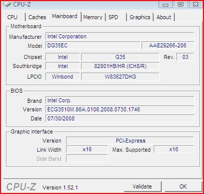

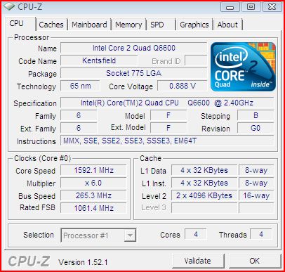

Don Ashok! Posted August 5, 2009 Author Share Posted August 5, 2009 Installed Vista now! Installed CPU-Z and got some spec from that! have uploaded those pics! Under network adapters there was some Intel® 82566DC Gigabit Platform LAN Connect Hope this helps u help me! What drivers should i use now! What option should i click on in the Utilities Tab now?? and i have a NviDia 8500GT 256 mb! what should i do in the customize tab to enable it?? Waiting for ur solutions -Ashok Link to comment https://www.insanelymac.com/forum/topic/178025-help-a-noob-reclaim-his-hdd/#findComment-1217393 Share on other sites More sharing options...
chevy2410 Posted August 5, 2009 Share Posted August 5, 2009 Just as I thought G35chipset. You might want to read through THIS THREAD. You might have to buy a supported Lan card as the intel one doesn't do full support and doesn't wake up from sleep. Chevy Link to comment https://www.insanelymac.com/forum/topic/178025-help-a-noob-reclaim-his-hdd/#findComment-1217745 Share on other sites More sharing options...
