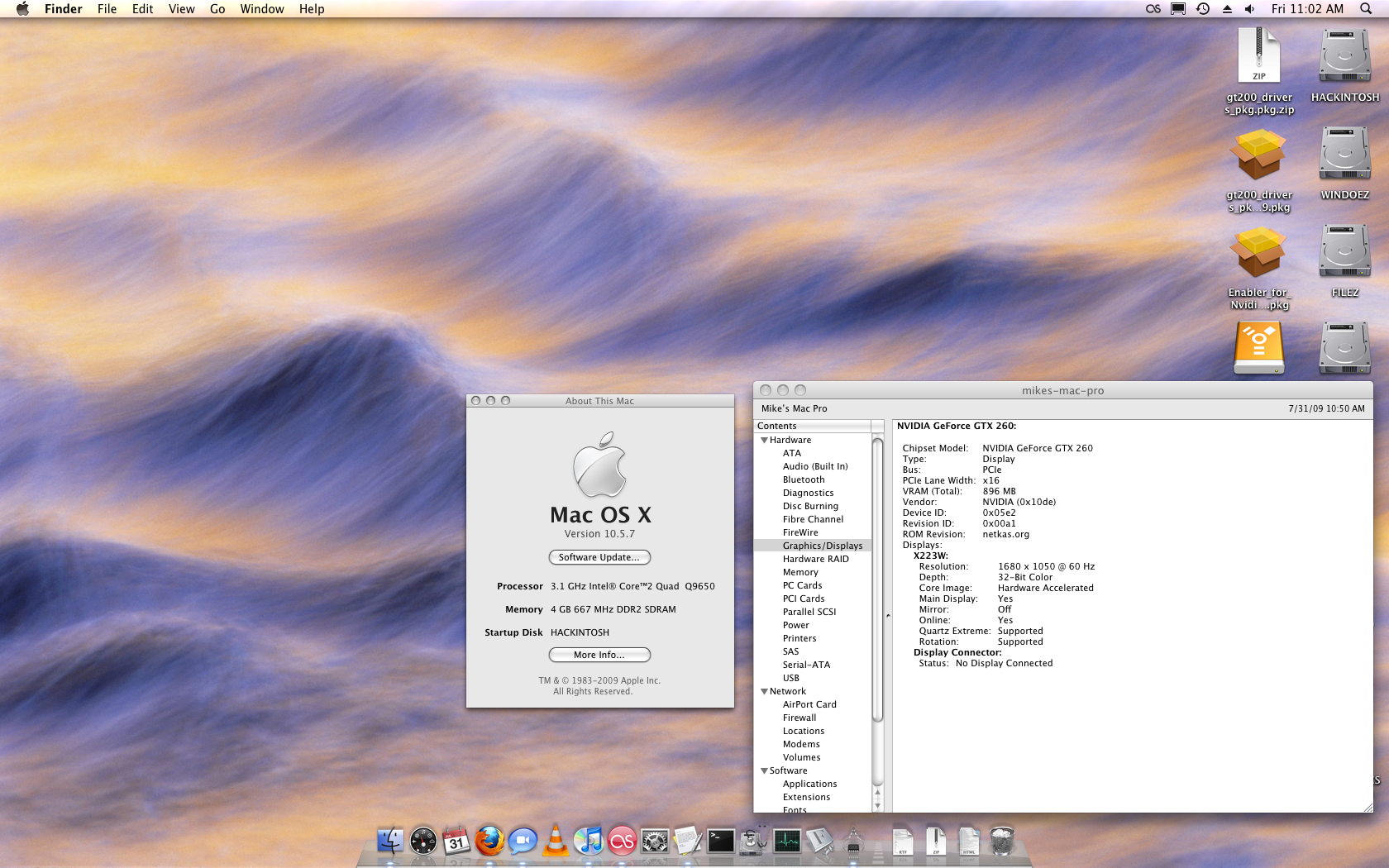

Monte SS Burnout Posted July 31, 2009 Share Posted July 31, 2009 Ok guys, so this is for anyone with similar hardware as me, who comes accross this via google or this site trying to find a solution. My hardware is as follows: Core 2 Quad Q9650 3.0GHZ 780i EVGA nforce Mother Board NVIDIA GeForce GTX 260 896MB Seagate Barracuda 1TB 7200 RPM 32MB HD OCZ Platinum 4GB (2 x 2GB) 240-Pin DDR2 SDRAM DDR2 1066 SIGMA SHARK SP-635 635W APEVIA X-SUPRA G-Type Blue Case Realtek lan card (PCI) Ive tried many installers. Kalyway 10.5.2 installs, so does ideneb 10.5.5 and 10.5.6, but they become unstable when transfering files. Leo4allv5 works like a charm, downside, its server, and is 10.5.4, and I cannot install the graphics that way, so that wouldnt do. SO, I installed iatkos v7 with the following options: Bootloader: -Chameleon v2 X86 Patches -/Extra directory -DSDT Decrypters -AppleDecrypt Kernel -9.7.0 Kernel Voodoo ACPI -x86 ACPI -Disabler Drivers: System: SATA/IDE -nForce SATA/IDE Sound -Azalia Audio Driver Post-Install Actions I did not install graphics through the installer as I couldnt figure out which enabler to use. So after installation, I installed: -gt200_drivers_pkg 00-13-49.pkg -Enabler_for_Nvidia_and_multiple_ATI_cards.pkg And then graphics work fine as well. The os is completely stable, the only problem is the ram does not appear correctly, but who knows. My external hard drives boot up fine, and even my firewire external hard drive works flawlessly. The system does not freeze while transfering files. Shut down/restart does not work, i have to press the button, but a small price to pay for a fully working mac osx on my rig. Check out the screen shot for graphics information. Anyway, comment if this helped you in anyway, or feel free to ask questions. -Mike Link to comment https://www.insanelymac.com/forum/topic/177517-iatkosv7-success-on-780i/ Share on other sites More sharing options...
Monte SS Burnout Posted August 3, 2009 Author Share Posted August 3, 2009 Ok so i found that one thing isnt working well. Usb 2.0 isnt working. Usb devices work, but the speed is very very slow. Anyone have a similar problem for a 780i or similar board? I have tried newer kexts for usb, but they didnt work. Link to comment https://www.insanelymac.com/forum/topic/177517-iatkosv7-success-on-780i/#findComment-1215666 Share on other sites More sharing options...
