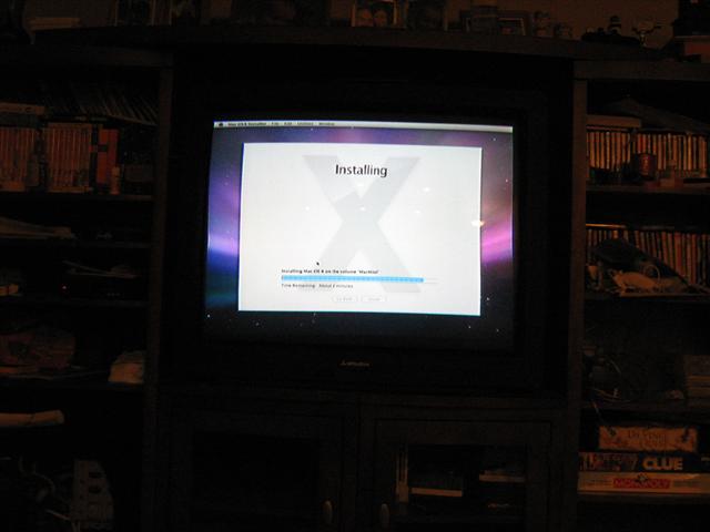

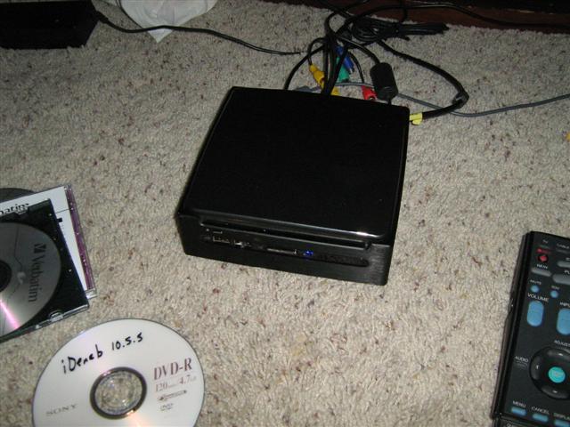

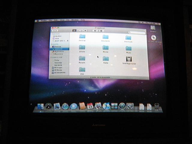

CharredPC Posted July 24, 2009 Share Posted July 24, 2009 I recently had the opportunity to pick up an MP945-D AOpen MiniPC for just $50. My intention is to use it with XP as a HTPC. But since it's here, and I have to format anyway, why not try OSX? I searched the forum, but found very little on this unit, and definitely nothing recent. So this is my actual as-it-happens commentary on installing OSX onto this tiny device. My MiniPC is configured with a 1.73GHz Celeron-M (booo!), 1GB of DDR2 ram, and a 60GB SATA drive. It also has a wifi card installed. I've ordered a 500GB drive replacement, so anything I do on this little 60GB is just for fun. Let's start with iDeneb 10.5.5... well, rats. My disc is a scratched up mess. It's 12:30am, I'm just starting, and it's already over? No way. What else have I got ready to pop in? Ah, my Boot132 CD and retail disc! I doubt it, but... what have I got to lose? Boot132 went fine, now inserting the OSX dvd. Hey, it came up! Working mouse and keyboard, too. Good thing this little thing uses USB, not PS2. Okay, Disk Manager to set up the drive as GUID, then back to setup... uncheck the printer drivers and language translations, and- begin. Uhg, this always takes forever. And it recalculates all over the place. An hour and a half?! I hope not. There we go, 50 minutes is better. Waiting, waiting... now it jumps from 32 minutes to 9, then 7. Status bar is 3/4 the way across. Did I mention I don't actually have a monitor in the house? I'm doing all this using the composite-out onto my 40" TV It's like a geek movie, I guess. Incidentally, I've named the hard drive MacMini; it's true, in a way. My plan is to up the RAM in this to 2GB, and pop in a Core Duo cpu. I spent little enough on the unit itself that I don't feel bad doing upgrades. Hurrah, less than a minute left! Wait, now "About a minute." I wish it would make up its mind. Just snapped a few pictures to make this thread official or something. Not very exciting, but it'll give you an idea of how little this thing is. Not too small to add a usb ATSC tuner inside it! ... but that's giving away another of my upgrade ideas. Still saying about a minute. Not frozen, though; the mouse still moves, and it's accessing the dvd. Maybe I'm just not a patient person. Finally! Done! About to restart... can't forget to swap the Boot132 out again. Hrm, dark gray screen during shutdown with the spinner. Wonder how long I should wait before I force a reboot. Guess two minutes is long enough. Held the power button till it was off, then tapped it back on. Swapped in boot cd, choose the hd... success! Watching the intro movie. Now setting up keyboard, etc. Setup all went fine except it wouldn't let me alter the incorrect time and date. I bet there's a bios setting blocking changes or something. If I were keeping it this way, I'd go look. Or even just set the bios time to UTC to make OSX happy / correct. Now at the desktop. Looks like audio and wifi card weren't detected, but the Ethernet shows up! Plugged in the cable; it instantly DHCP'd everything. Let's do some Software Updating, that might add a kext or two. Everything appears pretty snappy, even with this being a Celeron. This would be a pretty awesome baby Mac with a Core2Duo in it. Okay, looks like the important updates are the Airport ones and the 10.5.7 upgrade. Here goes nothing... Of course this means more waiting. *sigh* The worst part of this is there's no soda in the house to keep me awake. What kind of geek lets their soda supply run out? After everything gets done updating, I guess installing Chameleon is in order. ETA 19 minutes on the downloads. No, 21 minutes. No, 27 minutes. 17? More than halfway through now, and back up to 22. By the way, if you're too lazy to look it up, the MP945-D runs off the Intel 945 chipset (could never have guessed that, huh?) and supports any 533/667 Socket M cpu. The ram can be maxed out at 4GB of 667Mhz 200-pin DDR2, and I assume any laptop SATA hd is compatible. It's really a laptop in cube shape with DVI / VGA / RGB / Composite output, right down to the 19v power adapter. Seems really quiet, and so far hasn't even gotten warm. Mine has an internal wifi antenna; some have external ones in the back. There's four USB plugs, a firewire port, standard three audio connectors, and the optical drive is a slot-loading slip (laptop) drive. About 2 minutes left now, or so it claims. Now about 2am. I wonder how a Mac would do as a home theater computer? Oh, download is done. Restarting computer... installing updates... So, if this doesn't fix (or break) anything, once it's done I'll need to track down an audio kext, and see what kind of wifi card this has. It uses a standard MiniPCI slot, so swapping it to something compatible would be easy enough. You can also toss a TV tuner into that spot instead, but I have yet to find one with Mac drivers. Which is really unfortunate, because that's an upgrade I'd love to do in my Hackbook. Once again it looks like it's having trouble rebooting. It might go if I wait long enough, but... Forced shutdown again, restarted with the boot cd. Hrm, that didn't work. Curse this non-HD tv, the text is almost impossible to read! It looked like it was trying to reboot again, and hung, so I helped it along. Now booted successfully back into OSX. Still no audio or wifi. System Information shows no audio device nor Airport card. Ok, time to pop the case open and see what we've got. Shutdown worked almost instantly- I guess it's just reboot that gets confused. Wifi card is a Lite-On WN2302A. Doesn't look like there's any OSX support for it. A shame, but as I said, not a deal-killer. My big question is the audio. Appears to be ALC888. Mixed bag as to whether drivers work or not, it seems. I'll try a few. While I was searching and downloading, I let the Mini think about that reboot hang. 20 minutes later, it still sits. Guess reboot will need a fix, if Chameleon doesn't cure it. Now have an audio driver to try- let's see... Just for fun; it takes less than 30 seconds to boot into OSX on this. Opened Safari, grabbed B7 Kext Helper, installed the audio files, rebooted- ok, no reboot. Grr. Forced restart. Hey, it shows an audio icon! But no sound... lots of audio options, and it hums slightly when switching to Line Out, but no audio. I'll try a shut down / start up, sometimes it takes a reboot or two. Nope. Well, it hums when audio is played, so I think it's just a matter of tracking down the right kext. It's now 3am. I WILL fix this before going to bed. Trying another method. Okay, weird... I don't seem to have an AppleAzaliaAudio.kext. Fine, I'll delete the AppleHDA kext and try one more thing. 4-5 seconds to shut down, so you know. And... audio! Hooray! Listening to iTunes radio now Looks like no input, just output, but I'm never going to use line-in on a HTPC anyway. Now for Chameleon, so I can stop booting off the cd. ...all right, installed using EFI. Wasn't sure about the other options; again, little hard to read. Let's try it! Eject boot cd, shut down, boot up- there's the Chameleon logo, now the Apple boot screen... ouch. "You need to restart your computer." I guess some kext on the boot cd is not in my install. Maybe something as simple as dsmos or the disabler kext. Well, it's 4am, so I think I'll call it a night- a successful night. With the addition of a few tidbits into the Extra folder, and a $10 swap-out of the wifi card (any suggestions?), this is a great little MiniMac! Most importantly, enough works right out of the box so that you can get the rest working without a second pc. Automatic QE is a plus too. After I get my upgrades done, this will be a kick-but machine. I may very well keep it OSX I therefore highly recommend picking one of these up, if you can find a good deal on one as I did. They're very fun little toys. Hope some of this dribble was helpful, or at least amusing, to someone! Link to comment Share on other sites More sharing options...
