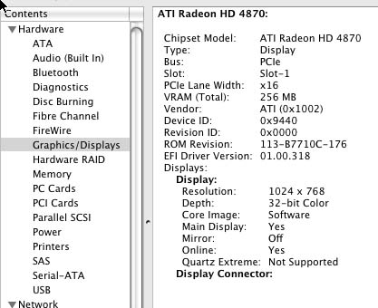

nomis66 Posted July 13, 2009 Author Share Posted July 13, 2009 Hi Kizwan, Yes, was able to install retail using your disk to boot from but OS does not recognize graphics card properly (no Open GL and only one screen resolution - BIG). Also no Ethernet so not able to run Software Update. Other than that it's fine lol. simon Link to comment https://www.insanelymac.com/forum/topic/172458-no-lan-on-asus-p5q-deluxe/page/2/#findComment-1199286 Share on other sites More sharing options...
kizwan Posted July 13, 2009 Share Posted July 13, 2009 Congratulation! At least now you have successfully installed Mac OS X using retail DVD. It is normal for a couple of device not working. I believe you have the driver for your graphic card, right? Install the driver. Can you give me the installer of the driver for your graphic card so that I can put the kext in Boot-132 CD. Well...we don't want to put any patched kext in /S/L/E because that is the whole idea of "Retail Setup". But Natit.kext will not give you any problem even if it is installed in /S/L/E. So it is ok to install it. As for your ethernet card, did you select a driver for your ethernet during iDeneb installation? I have included a kext for your ethernet card in Boot-132 CD. I don't know why it didn't work. Can you give me system.log file? It is located at "/var/log/system.log". I want to see if the kext itself failed to load from Boot-132 CD. EDIT: I think I know how to get your ethernet card working. Please wait while I update Boot-132 CD for you. kizwan Link to comment https://www.insanelymac.com/forum/topic/172458-no-lan-on-asus-p5q-deluxe/page/2/#findComment-1199313 Share on other sites More sharing options...

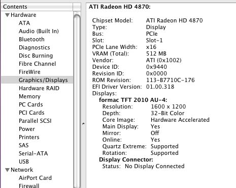

nomis66 Posted July 14, 2009 Author Share Posted July 14, 2009 Hi Kizwan, I have reinstalled Leopard Retail using Boot-132(LAN) disk and run Natit.pkg Here is what System Profiler says about QE, CI and resolution: Link to comment https://www.insanelymac.com/forum/topic/172458-no-lan-on-asus-p5q-deluxe/page/2/#findComment-1200353 Share on other sites More sharing options...
nomis66 Posted July 15, 2009 Author Share Posted July 15, 2009 Kizwan, The HD 4870 was added by Apple as an upgrade option on the latest Max Pros (which is why I got it) Both with iDeneb and Retail the HD 4870 doesn't have full functionality until I upgrade to 10.5.7. (although it still seems to work better under iDeneb) Is it possible that when Apple added the card as a possible upgrade that they also added something to 10.5.7 to make it work? Just a thought. si PS. Please note, having installed Leopard Retail using Boot-132(LAN) disk and run Natit.pkg (hav enot run Software Update) Ethernet is working but Graphics not functioning properly. Link to comment https://www.insanelymac.com/forum/topic/172458-no-lan-on-asus-p5q-deluxe/page/2/#findComment-1200663 Share on other sites More sharing options...
kizwan Posted July 15, 2009 Share Posted July 15, 2009 At this point, can you change to any resolution? I think you're right. Natit.pkg was introduce in netkas.org for 10.5.7. The purpose of this test is to see what happen if it is installed in pre-10.5.7. Right now I want you to run Software Update & update your Mac OS X to 10.5.7. Please report back to me (resolution, QE & CI). I will provide 10.5.7 kext for your ethernet card later. For this test, please use Boot-132 CD with LAN (only) to boot Mac OS X. Thank you. kizwan Link to comment https://www.insanelymac.com/forum/topic/172458-no-lan-on-asus-p5q-deluxe/page/2/#findComment-1200703 Share on other sites More sharing options...

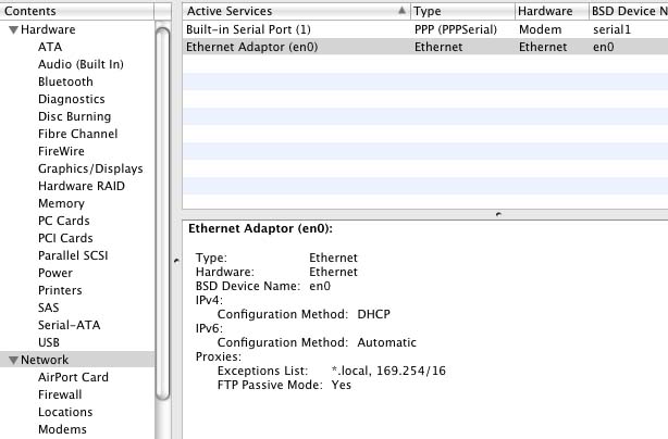

nomis66 Posted July 15, 2009 Author Share Posted July 15, 2009 Okay, HD 4870 seems fine but no Ethernet/Internet Link to comment https://www.insanelymac.com/forum/topic/172458-no-lan-on-asus-p5q-deluxe/page/2/#findComment-1200773 Share on other sites More sharing options...
kizwan Posted July 15, 2009 Share Posted July 15, 2009 That is good news. Now I have an idea to create final Boot-132 CD with LAN & GFX support. Please wait for a while. Link to comment https://www.insanelymac.com/forum/topic/172458-no-lan-on-asus-p5q-deluxe/page/2/#findComment-1200777 Share on other sites More sharing options...

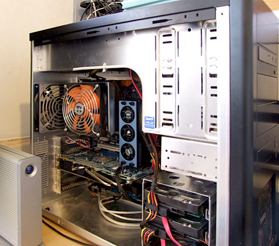

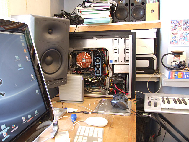

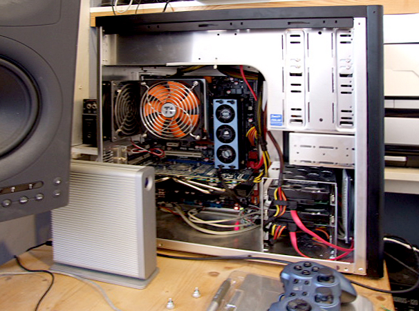

nomis66 Posted July 23, 2009 Author Share Posted July 23, 2009 Cheers Kizwan, much appreciated. I thought I'd post a few pic of "The Beast" Link to comment https://www.insanelymac.com/forum/topic/172458-no-lan-on-asus-p5q-deluxe/page/2/#findComment-1207191 Share on other sites More sharing options...
kizwan Posted July 23, 2009 Share Posted July 23, 2009 Nice!!! I'm definitely going to build a "monster" like that. Link to comment https://www.insanelymac.com/forum/topic/172458-no-lan-on-asus-p5q-deluxe/page/2/#findComment-1207224 Share on other sites More sharing options...
nomis66 Posted July 23, 2009 Author Share Posted July 23, 2009 I bought a few bits every month (online) so overall it really didn't cost that much to put together (a lot less than a comparable Intel Mac). Also I tried to match the components with the ones used on the latest Mac Pro as much as possible. I've been running Logic Studio on it and it 's blazing. It should be possible in the future to overclock the chip to 3GHz (although I've no idea how to do that and it's not really a priority just now) but I have built the machine with that in mind. si Link to comment https://www.insanelymac.com/forum/topic/172458-no-lan-on-asus-p5q-deluxe/page/2/#findComment-1207499 Share on other sites More sharing options...
