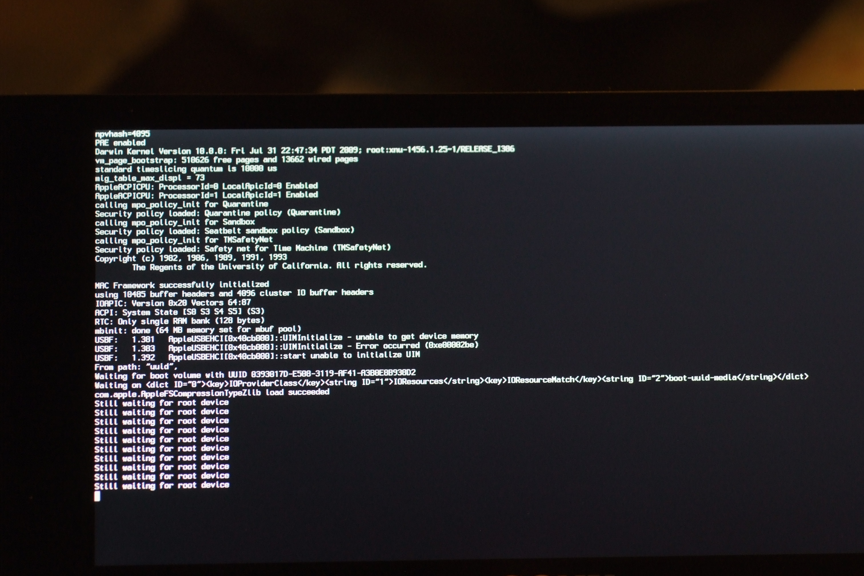

ryuu123 Posted September 7, 2009 Author Share Posted September 7, 2009 Hi, If you intended to install Snow, use these files. http://www.mediafire.com/?nnlxa5dntmw Original Atheros WIFI card is working well with Snow. so you don't need to get broadcom one. but abobe archive is bit deprecated. Please replace /boot to Chameleon RC3 and edit com.apple.Boot.plist below. <key>Kernel Flags</key> <string>"Legacy Logo"=Yes EthernetBuiltIn=Yes "Graphics Mode"=1600x768x32 arch=x86</string> one more thing. you need to recompile VoodooHDA. please refer http://code.google.com/p/voodoohda/issues/detail?id=52 I don't mean to bump an old post, but I just got a VGN-P530H and im really itching to put Snow Leopard on it. Can anyone point me in the direction of an ebay listing or site that actually sells the half size broadcom cards? i looked all over and couldn't find one and i even looked at the chinese site that someone already mentioned earlier in the tread. Im quite experienced in the hack scene and have been doing it for the past 4 or 5 years. (I'm only 19. : D) Anyways, thanks everyone for all your input. I hope i can get this thing working soon! fr3z3rburn Link to comment https://www.insanelymac.com/forum/topic/168426-snow-leopard-on-vaio-pvgn-p90hs-working/page/5/#findComment-1255593 Share on other sites More sharing options...
griff197 Posted September 7, 2009 Share Posted September 7, 2009 Hi, If you intended to install Snow, use these files. http://www.mediafire.com/?nnlxa5dntmw Original Atheros WIFI card is working well with Snow. so you don't need to get broadcom one. but abobe archive is bit deprecated. Please replace /boot to Chameleon RC3 and edit com.apple.Boot.plist below. <key>Kernel Flags</key> <string>"Legacy Logo"=Yes EthernetBuiltIn=Yes "Graphics Mode"=1600x768x32 arch=x86</string> one more thing. you need to recompile VoodooHDA. please refer http://code.google.com/p/voodoohda/issues/detail?id=52 ryuu123, thank you for your work. Could tell, do I need some other files than in your last archive? Because using an USB-stick installation of Snow i get this screen: Link to comment https://www.insanelymac.com/forum/topic/168426-snow-leopard-on-vaio-pvgn-p90hs-working/page/5/#findComment-1256166 Share on other sites More sharing options...
ryuu123 Posted September 7, 2009 Author Share Posted September 7, 2009 ryuu123, thank you for your work. Could tell, do I need some other files than in your last archive? Because using an USB-stick installation of Snow i get this screen: it seems none of my files is exist. 1. Does USB-stick:/Extra/Extensions.mkext exist? 2. using chameleon 2 rc 3? Extract my archie and copy all files to USB-stick's root. Link to comment https://www.insanelymac.com/forum/topic/168426-snow-leopard-on-vaio-pvgn-p90hs-working/page/5/#findComment-1256423 Share on other sites More sharing options...

griff197 Posted September 8, 2009 Share Posted September 8, 2009 it seems none of my files is exist. 1. Does USB-stick:/Extra/Extensions.mkext exist? 2. using chameleon 2 rc 3? Extract my archie and copy all files to USB-stick's root. 1. Yes 2. Yes But something went wrong... Link to comment https://www.insanelymac.com/forum/topic/168426-snow-leopard-on-vaio-pvgn-p90hs-working/page/5/#findComment-1256896 Share on other sites More sharing options...
