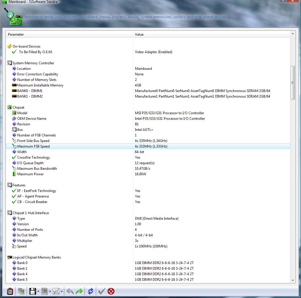

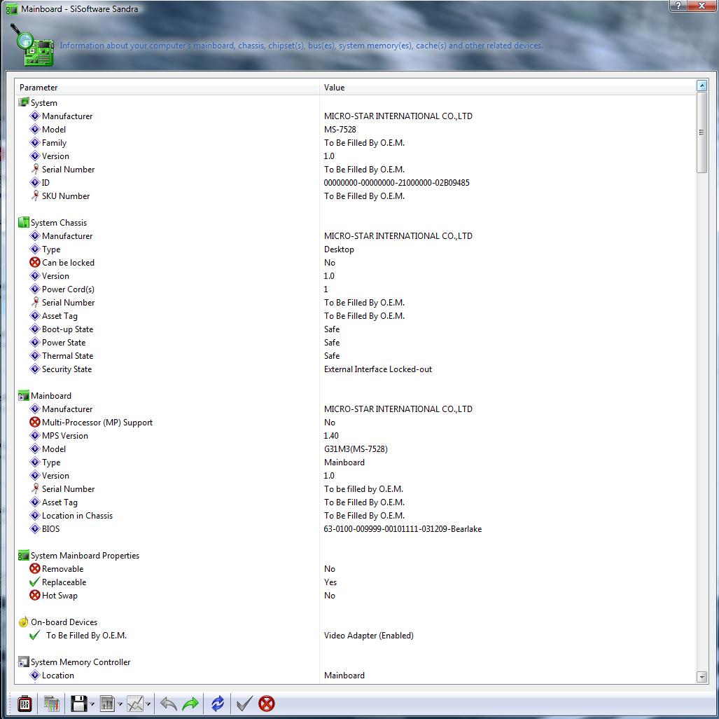

Lambros Posted May 23, 2009 Author Share Posted May 23, 2009 i think i found it... i believe it is the one with version 3.50 for the bios. but, if i am wrong, can i experience problems? or no, because im not installing it? also, it gives me a .exe file and a "350 file". What should i do from here? Ok, heres all the info i have: I have uploaded 2 screenshots SANDRA testing my hardware. According to it, my maximum FSB value is 1.33 GHz. Now, id be happy to mod my bios, but i want to be 100% sure it will work. If you cannot guarantee this, then what are my options for a patched bios file? Link to comment https://www.insanelymac.com/forum/topic/161056-cant-get-to-installation-screen/page/3/#findComment-1162719 Share on other sites More sharing options...
verdant Posted May 23, 2009 Share Posted May 23, 2009 @ Lambros As I said there is always a degree of risk when flashing a BIOS.......even MOBO manufacturers admit that......so no one will give you or anyone else a 100% guarantee even if the number of failed flashhings is generally small.....hence: OSXCORES TAKES NO RESPONSIBILITY FOR A BAD BIOS FLASH, NOR USE OF THE WRONG BIOS PLEASE PROCEED WITH CAUTION & AT YOUR OWN RISK!!! What are the full file names of the .exe and "350" file....? As I said you can download the BIOS file onto your Windows Desktop and have a go at using Koalala's DSDT software to extract, patch and save a modified DSDT.aml file......or you can decide to ask OriginalMACNUT to mod the BIOS for you...... Link to comment https://www.insanelymac.com/forum/topic/161056-cant-get-to-installation-screen/page/3/#findComment-1162752 Share on other sites More sharing options...
Lambros Posted May 23, 2009 Author Share Posted May 23, 2009 I saw this: http://www.insanelymac.com/forum/lofiversi...hp/t163142.html I saw someone say, that it doesnt matter which if your mobo is one of about 5 diff models, as long as it is G31M3. So, does that mean I can use the 7528 flasher from the website you gave me, as long as my mobo is G31M3? Thanks! The files are: AFUD4281.exe and A7528IMS.350 But, it might be the other bios file, im not quite sure yet. Link to comment https://www.insanelymac.com/forum/topic/161056-cant-get-to-installation-screen/page/3/#findComment-1162753 Share on other sites More sharing options...

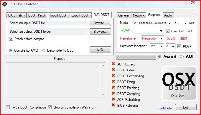

Lambros Posted May 23, 2009 Author Share Posted May 23, 2009 Is it possible to use ACPI (DSDT) patcher by koalala to patch my bios? If you know how, please tell me, although i suppose i patch the 120 file, then use that with the .exe to boot and patch the mobo. Thanks! EDIT: With the patcher i was able to not only create a modded bios file, but i was also able to create a dsdt.aml file. it was patched, but now i dont know what to do with the dsdt. isnt this a safer method. What do i do now? Thanks! Link to comment https://www.insanelymac.com/forum/topic/161056-cant-get-to-installation-screen/page/3/#findComment-1162794 Share on other sites More sharing options...
verdant Posted May 23, 2009 Share Posted May 23, 2009 Is it possible to use ACPI (DSDT) patcher by koalala to patch my bios? If you know how, please tell me, although i suppose i patch the 120 file, then use that with the .exe to boot and patch the mobo. Thanks! EDIT: With the patcher i was able to not only create a modded bios file, but i was also able to create a dsdt.aml file. it was patched, but now i dont know what to do with the dsdt. isnt this a safer method. What do i do now? Thanks! As I said in an earlier post in this thread you need to use Chameleon 2.0RC1 bootloader with the DSDT.aml file placed in the /Extra directory that you will see after installing Chameleon 2.0RC1...... Link to comment https://www.insanelymac.com/forum/topic/161056-cant-get-to-installation-screen/page/3/#findComment-1162808 Share on other sites More sharing options...
