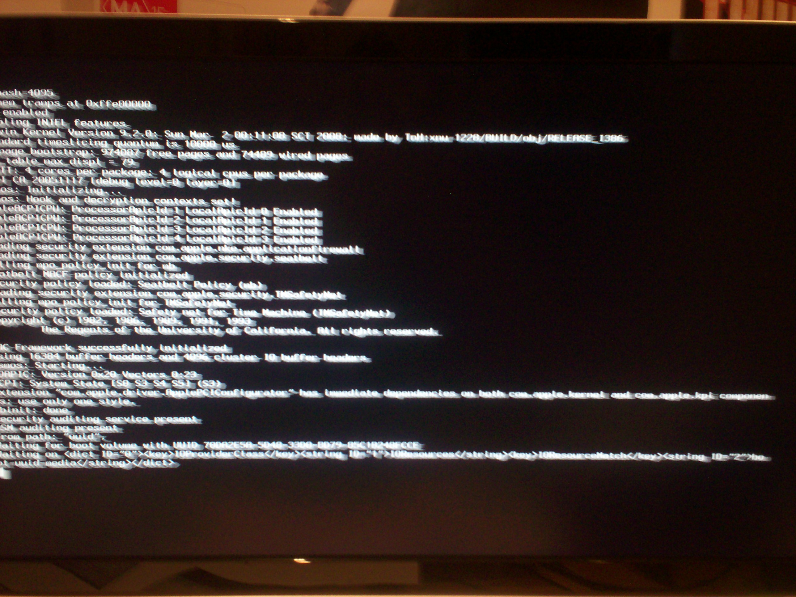

With -v, the last few lines were as follows:
Mac OS Version:
Not set yet
Kernel version:
Darwin Kernel Version 9.2.0: Sun Mar 2 00:11:08 SCT 2008; made by ToH:xnu-1228/BUILD/obj/RELEASE.I386
And nothing else appeared after that.

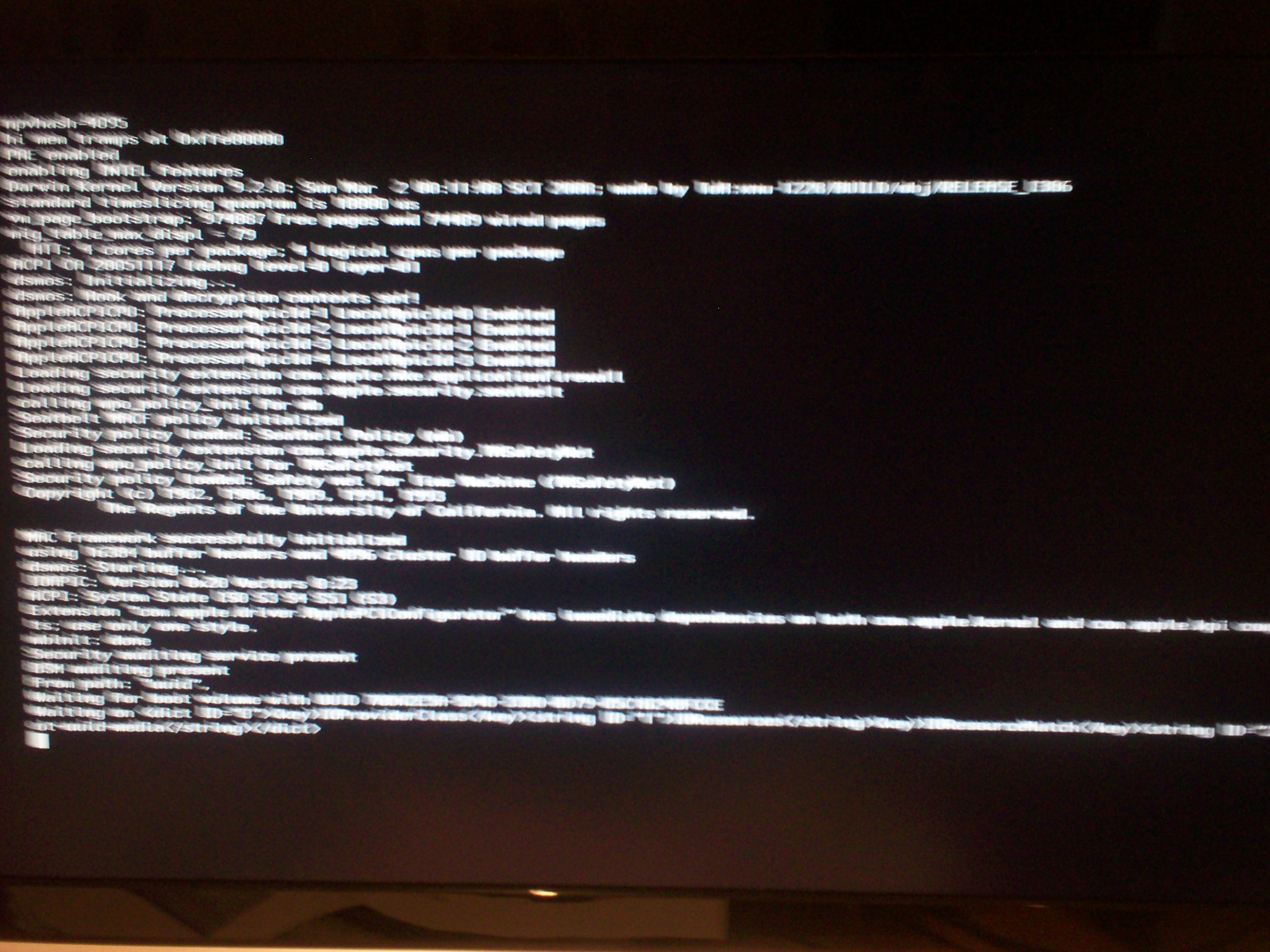

For -x, I got the following at the end:
Loading HFS+ file: (for ages, then the following appeared in a smaller text)
Extension "com.apple.driver.com.Apple PCIConfigurator" has immediate dependencies on both com.apple.kernel and com.apple.kpi components: use only one style

I just got iDeneb and installed it, and I got this as an error when i typed -v (as shown in the image).
When I typed -x I got the error to use only one style or something like that.

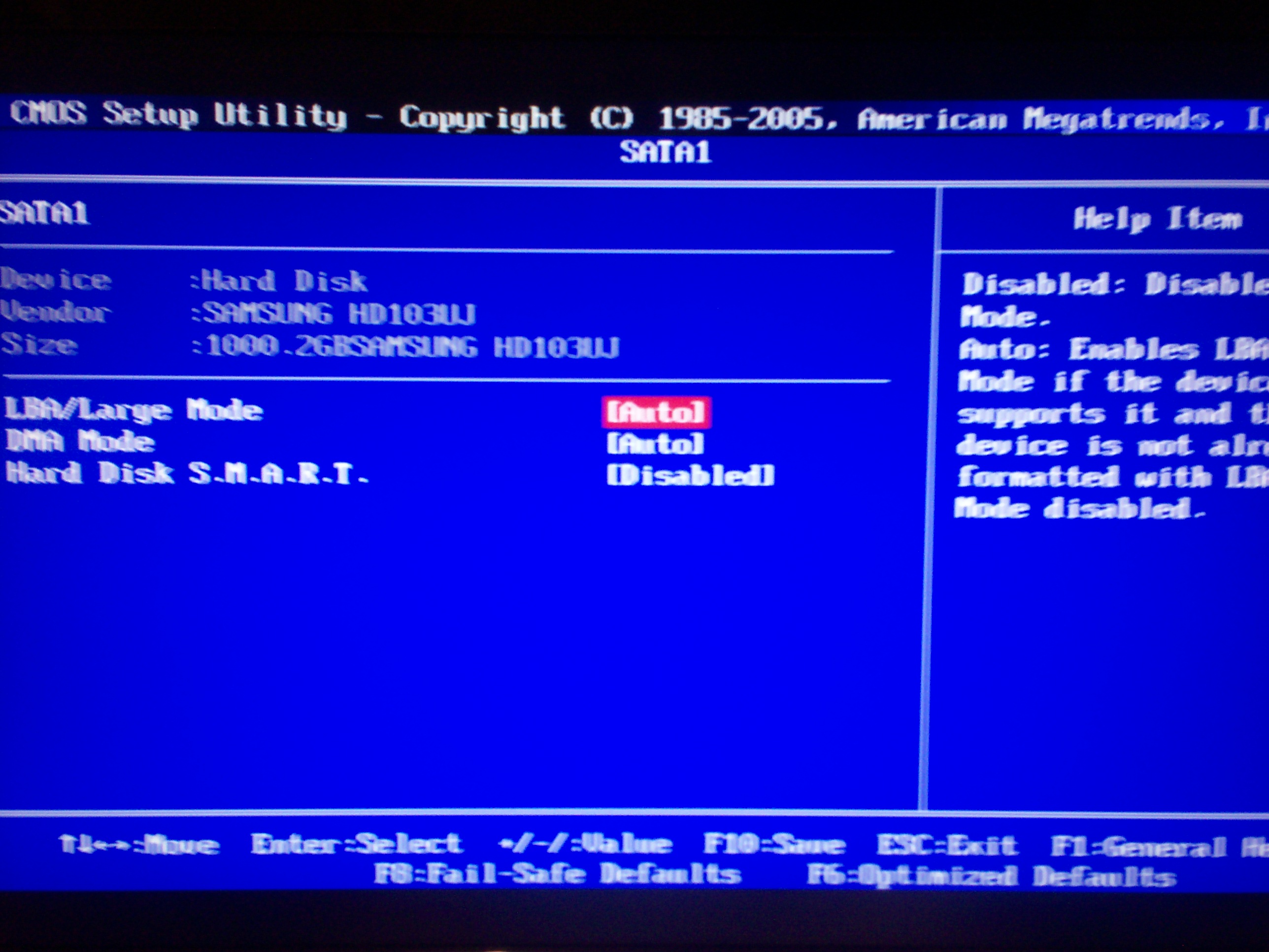

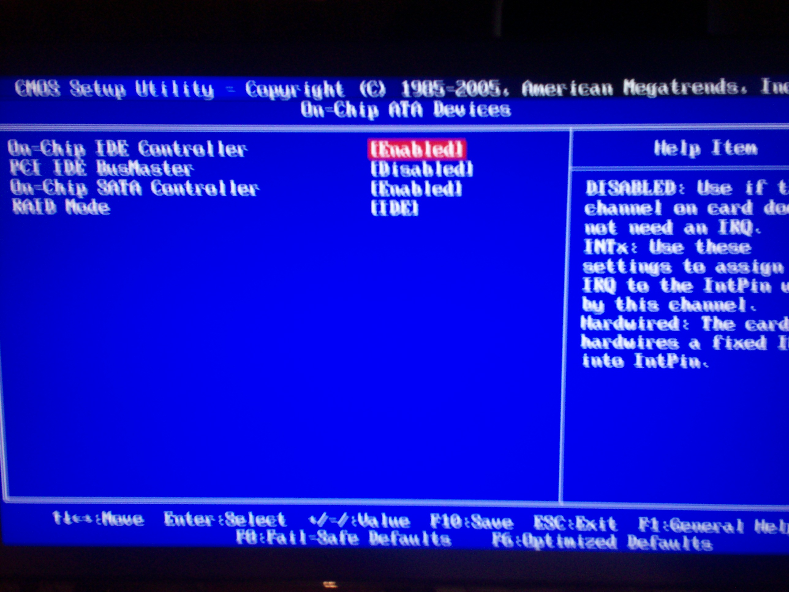

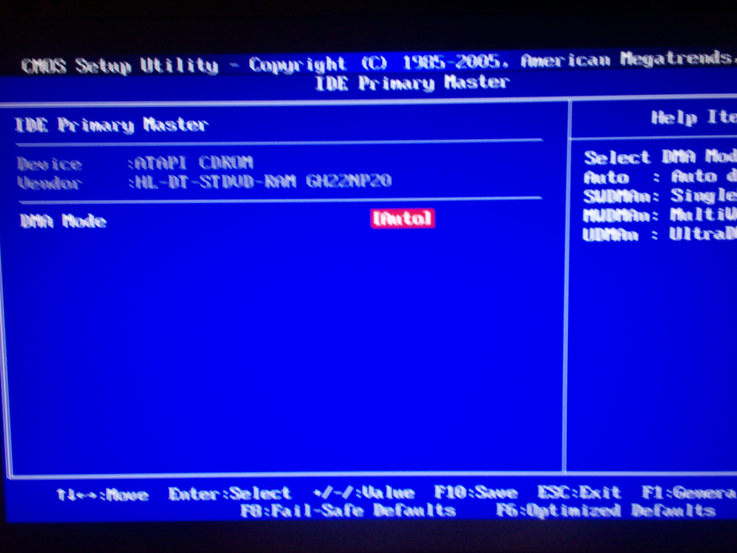

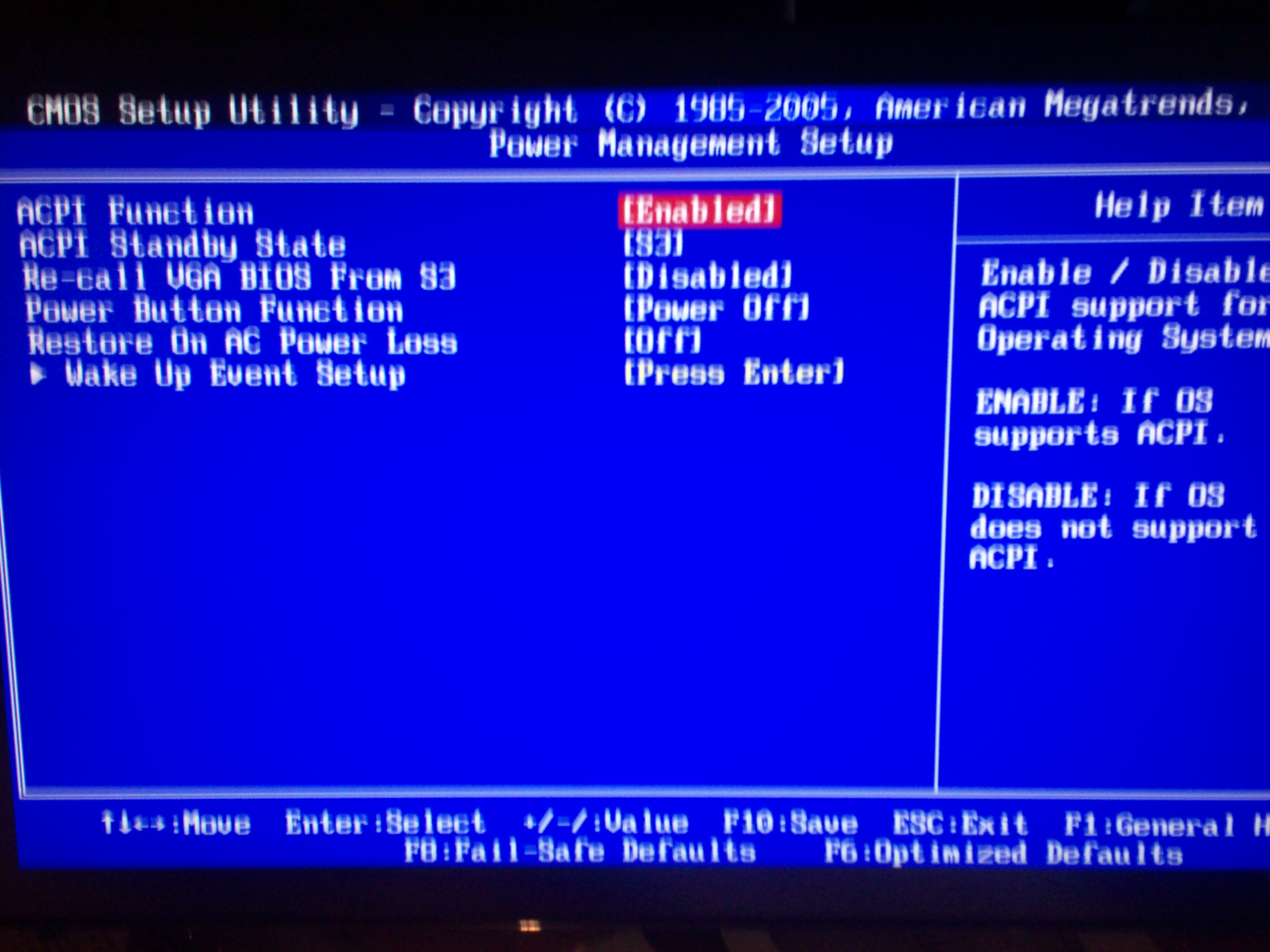

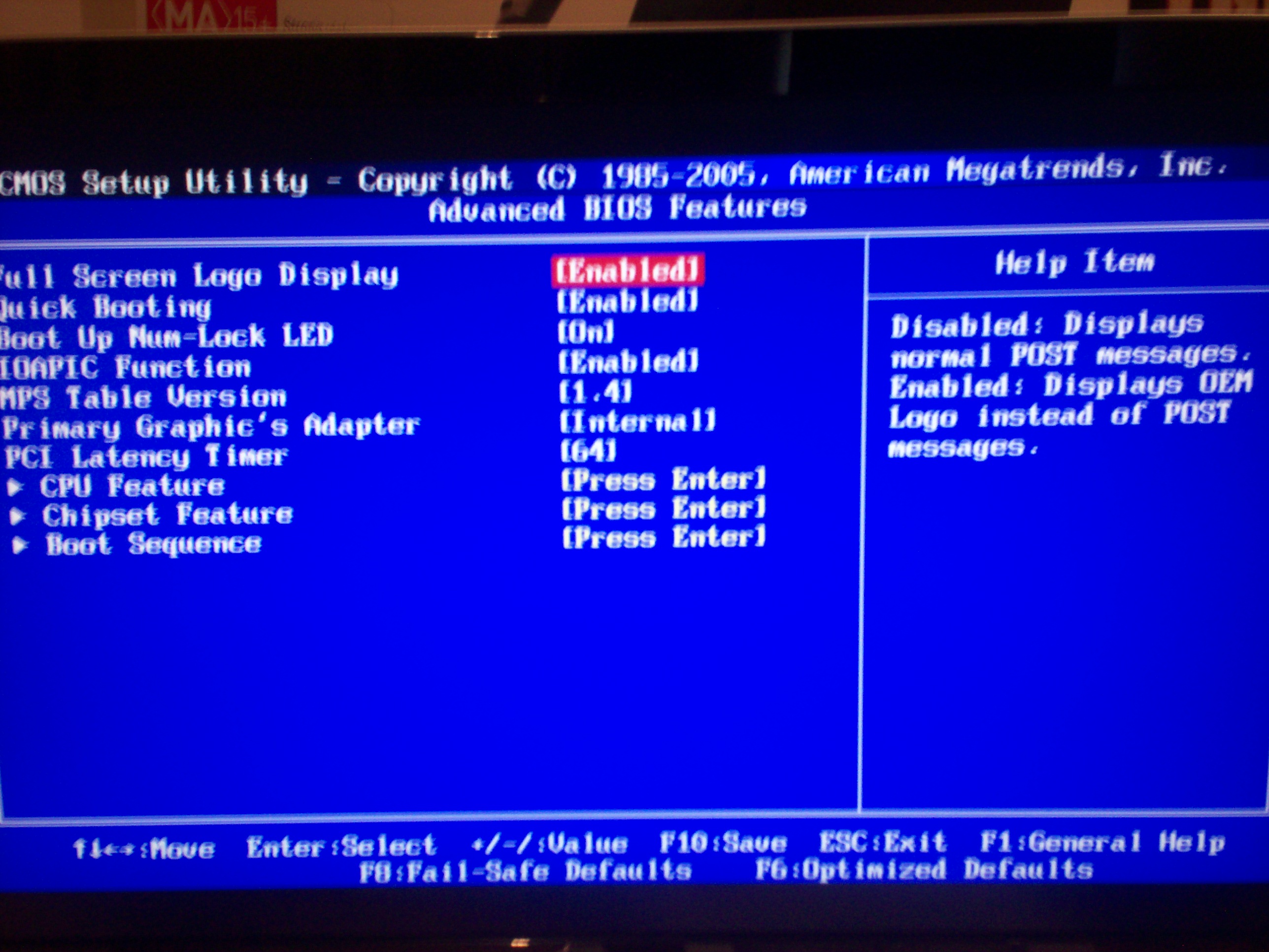

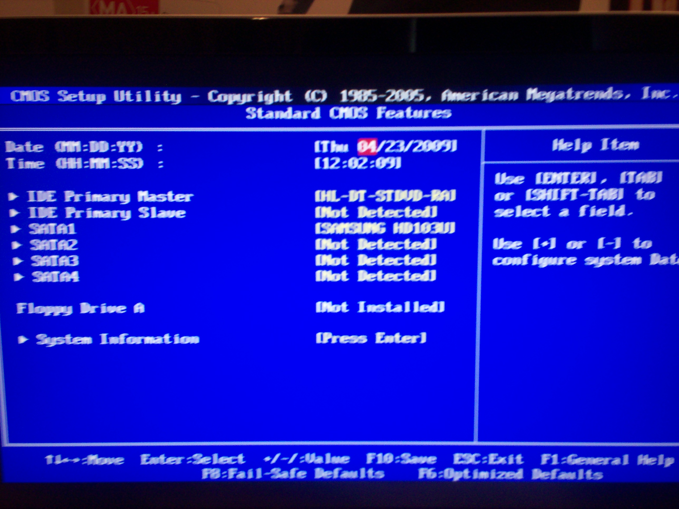

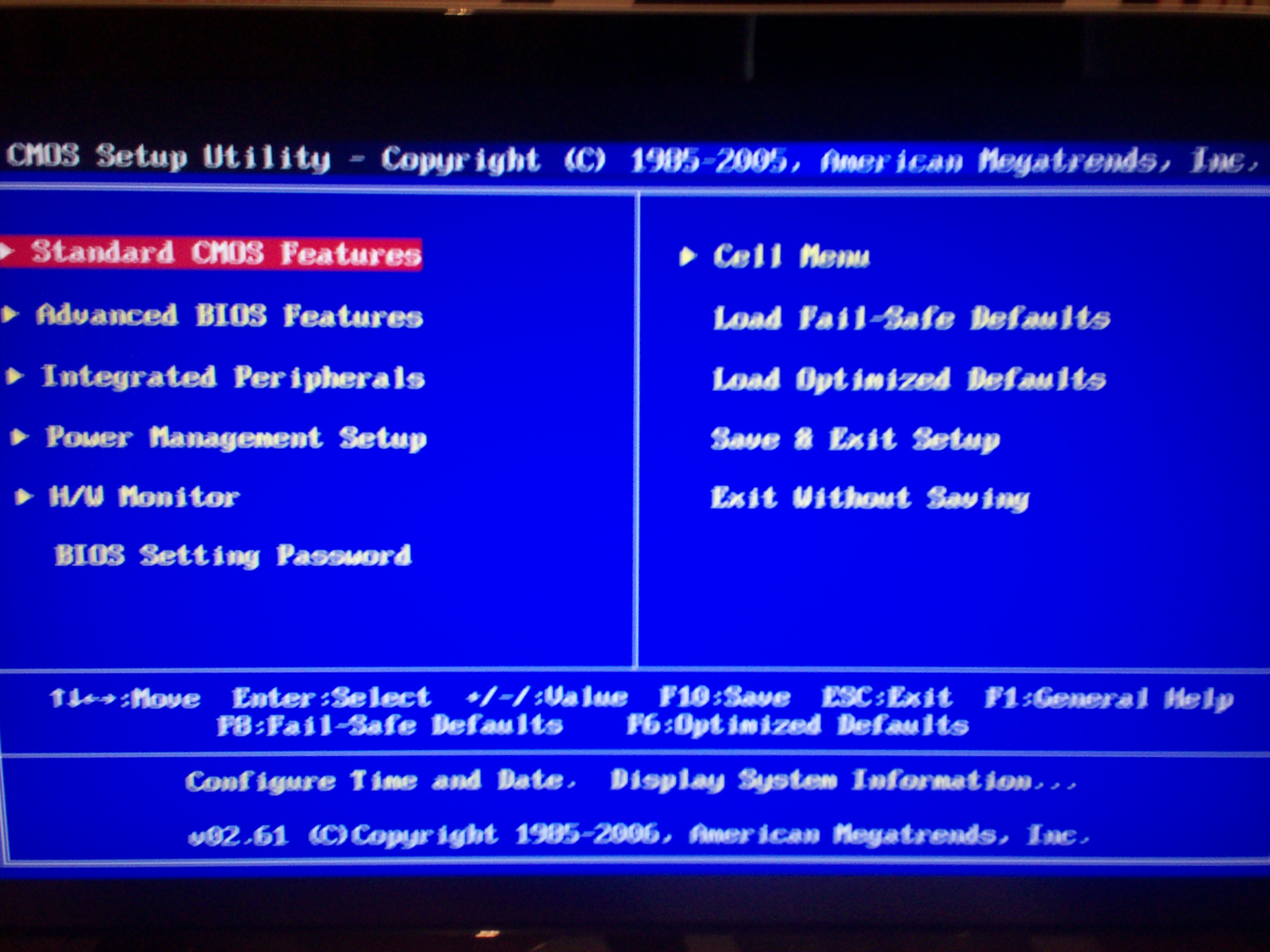

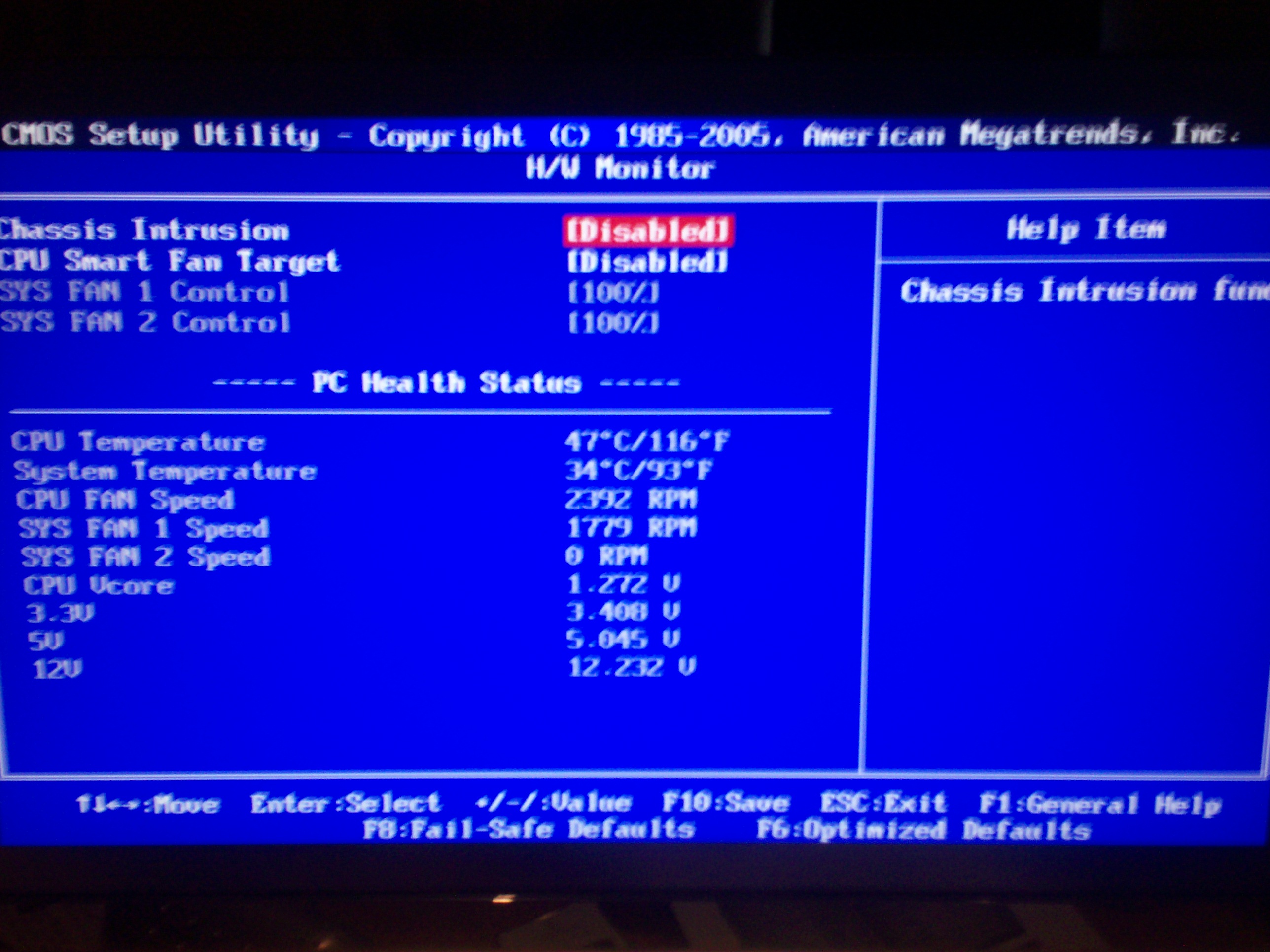

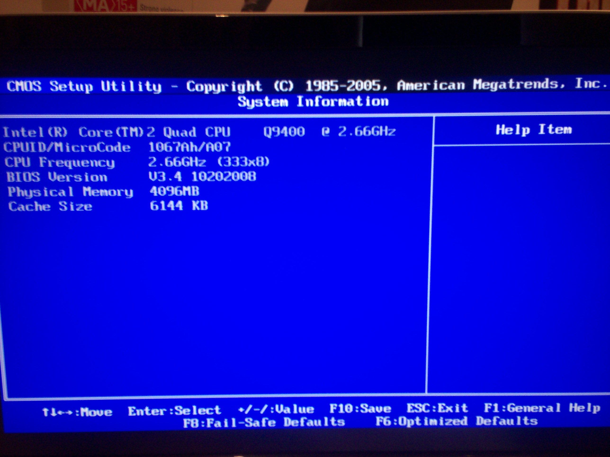

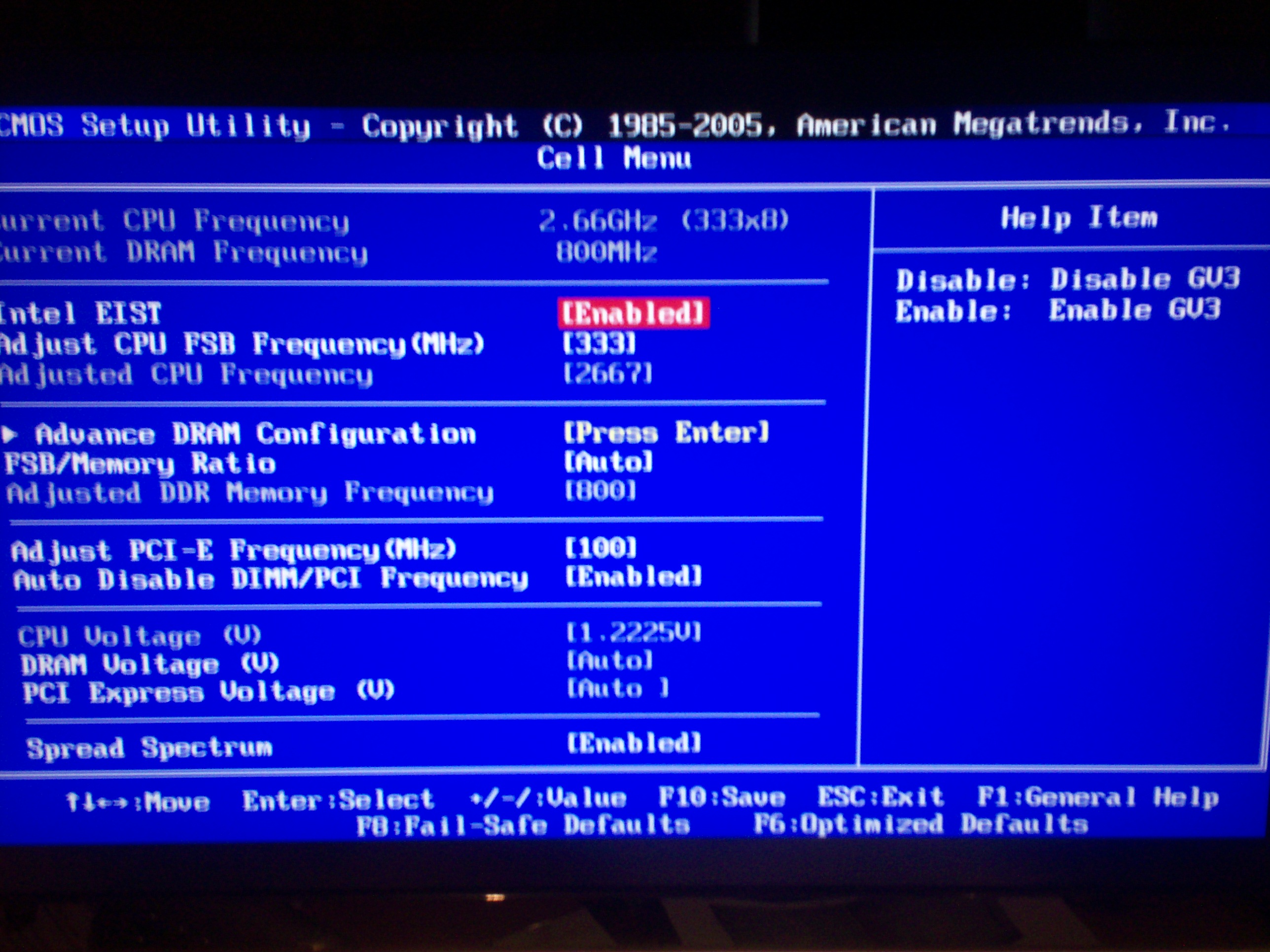

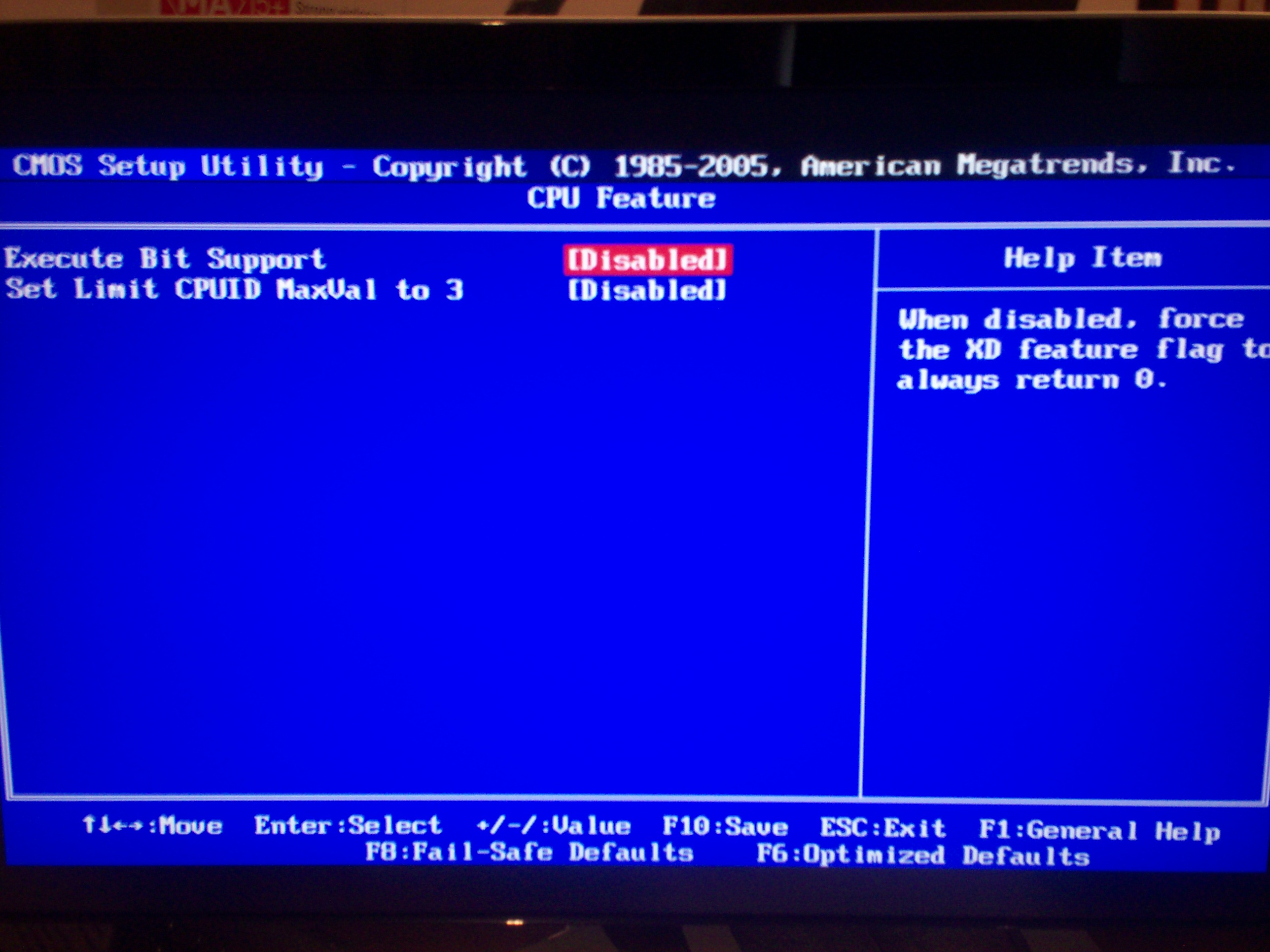

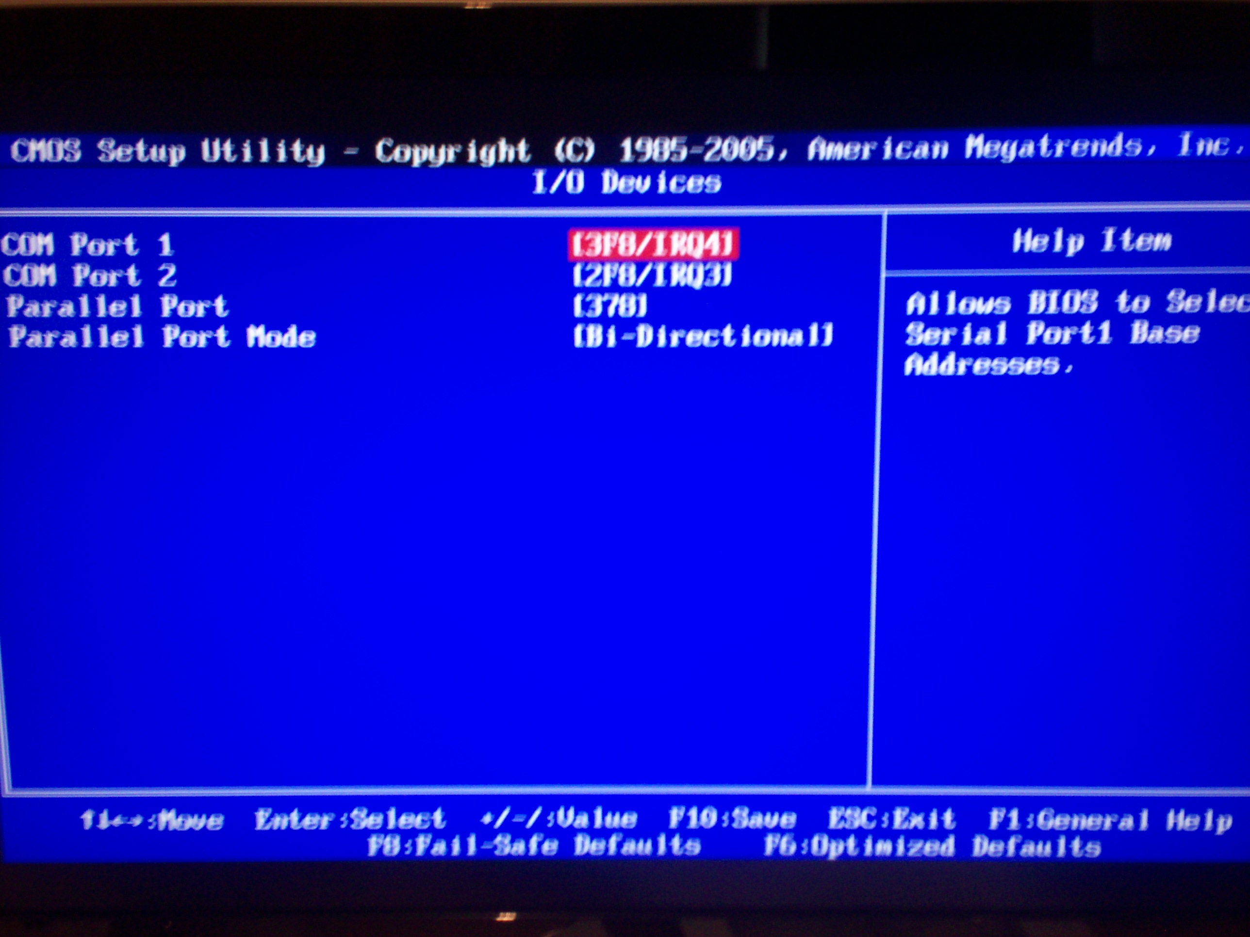

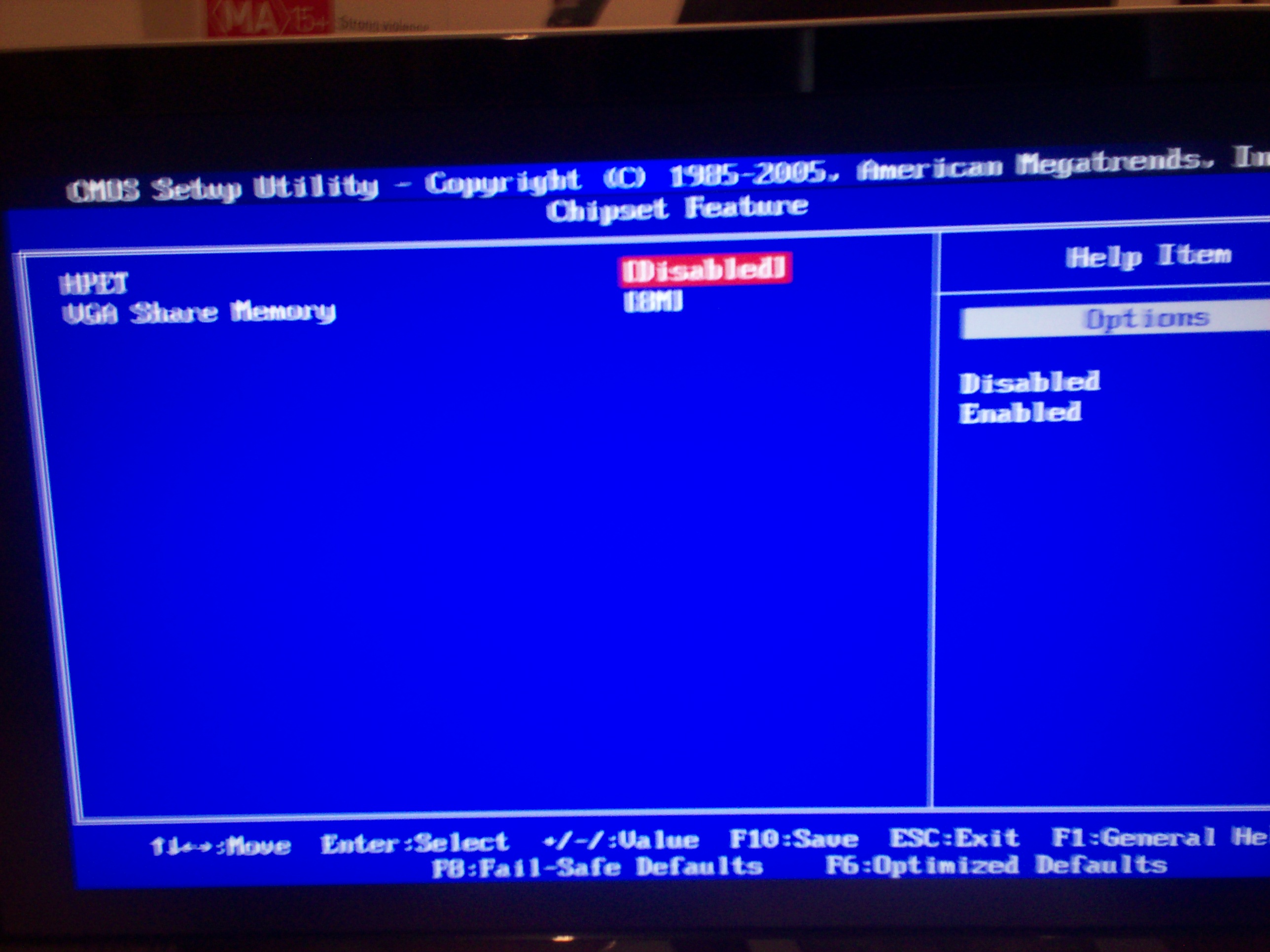

Here are the screens as requested....
Thank you so much for all your help insanelymac, especially verdant, who has helped me the whole way through....(ONLY VERDANT!) haha
if anyone else can help it would be much appreciated, but I am very thankful to verdant for all his help, he seems to know all there is to know about hackintosh.

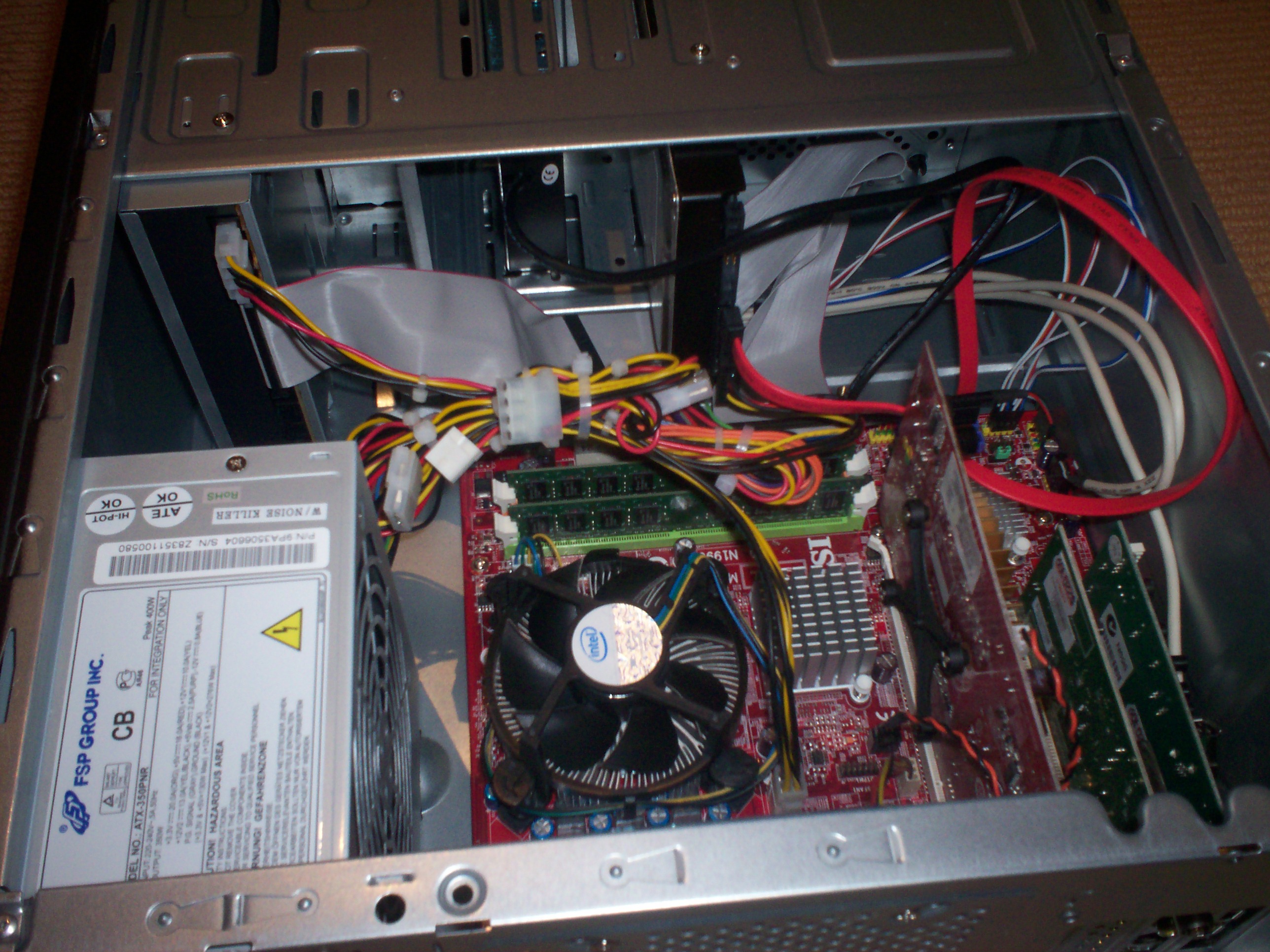

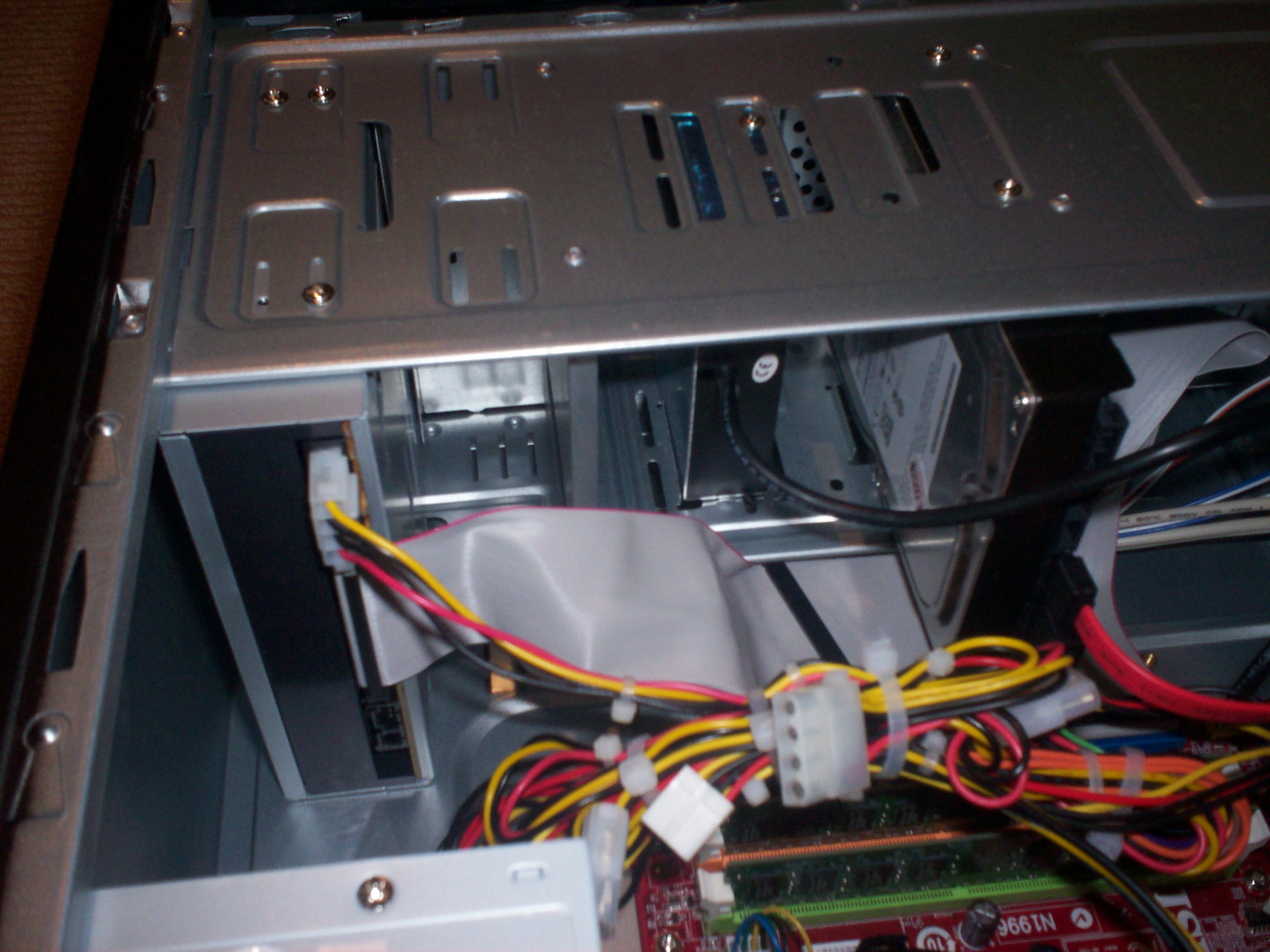

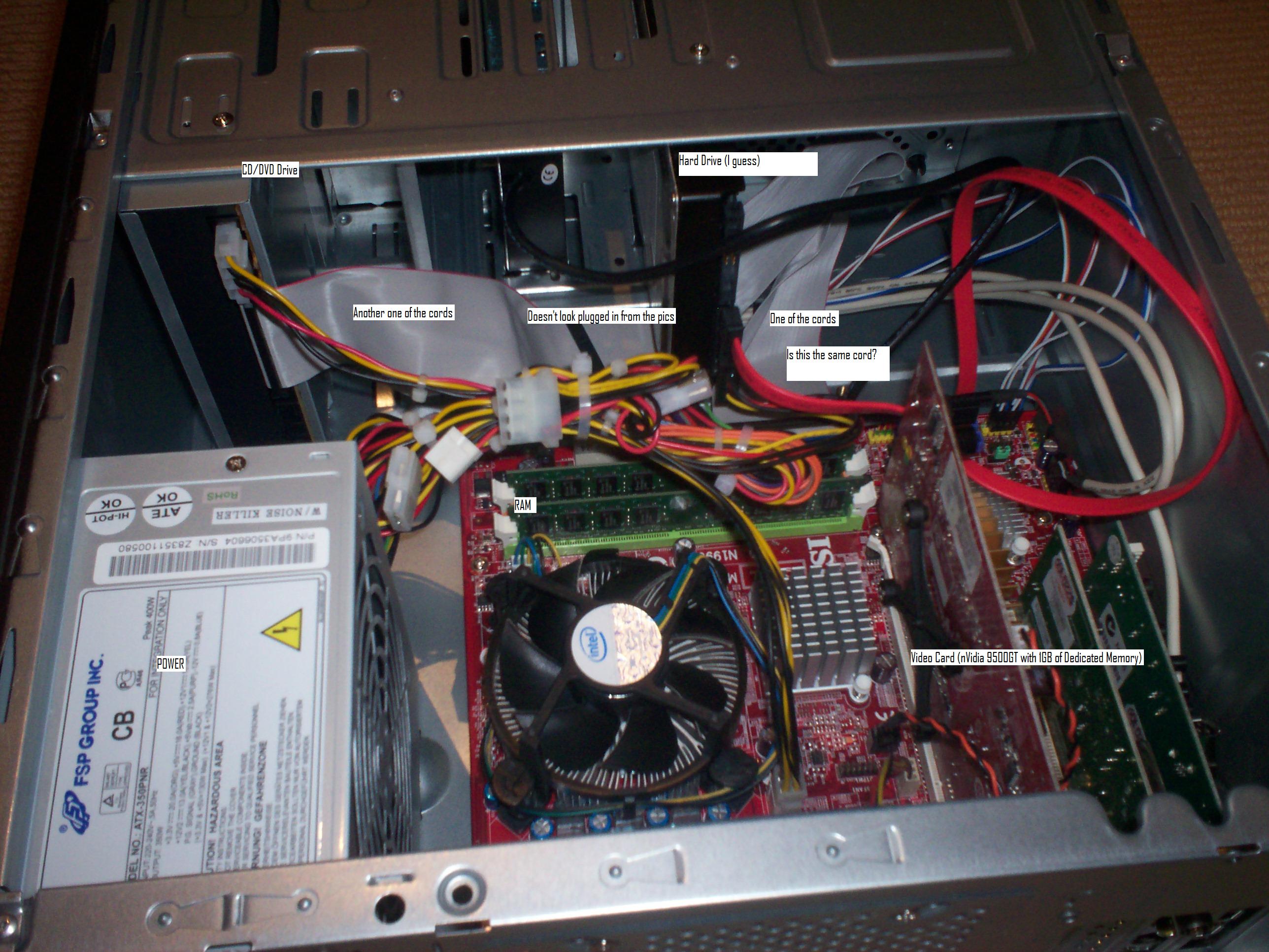

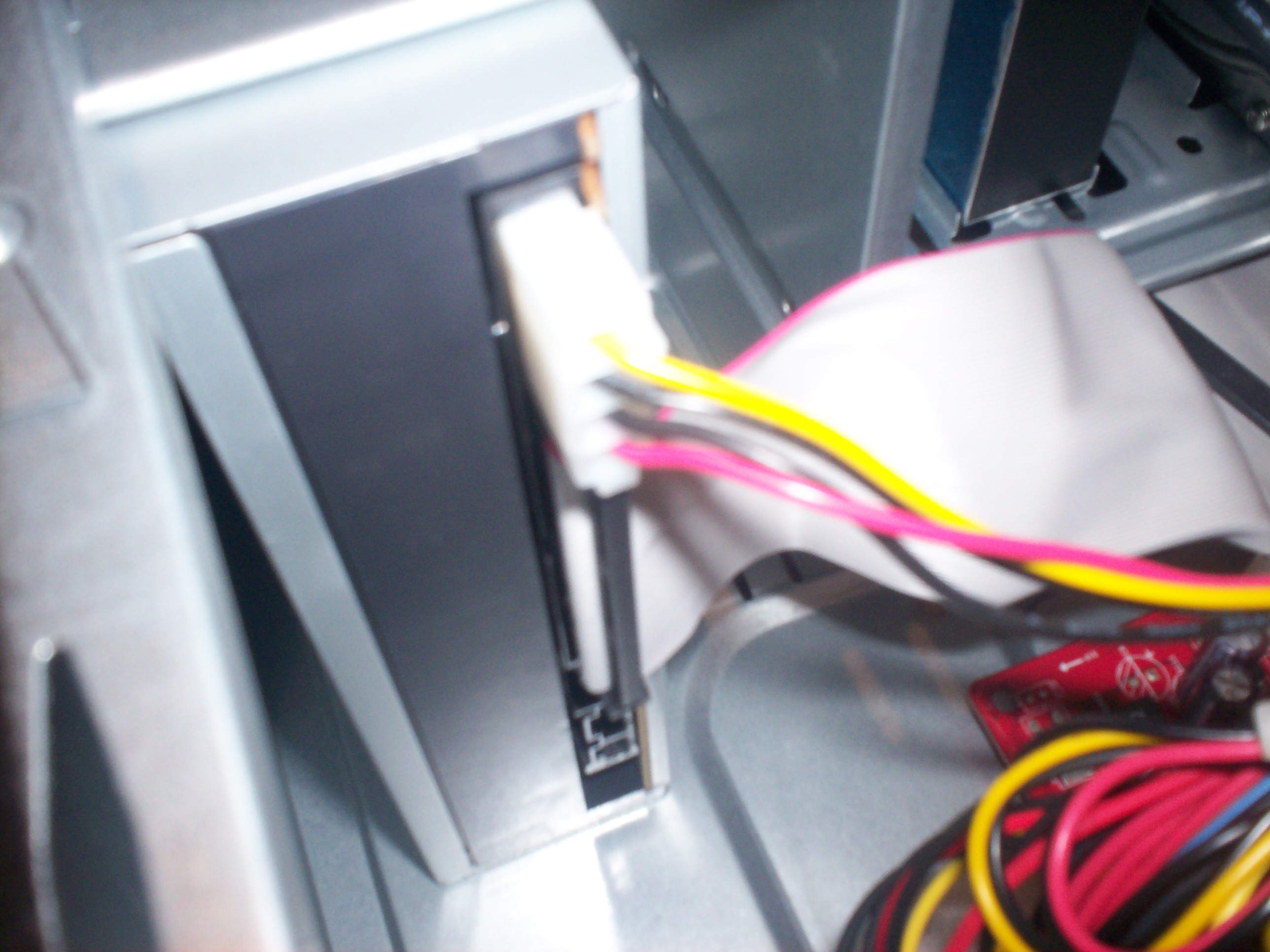

And I opened up the computer, wanting to see what this new PC of mine had in it....It looked like an 80-wire cord connecting to the CD/DVD Drive and HDD Drive, although I'm not really sure what you wanted to see. Attached are 3 photos of the inside. Tell me if it helps, or if you need me to take some more pics.
And I also annotated one of the pictures, although you probably know much more about it than me. :)
Thanks!
Actually, it seems that the 80-wire cord connects from the CD/DVD Drive by going under the HDD, and connecting through the blue part. To me it seemed that the cord wasn't plugged in, but I noticed that the black connector wasn't connected and it went under the HDD through to the MOBO.
What does that mean?
Thanks!
BIOS settings:
Set Primary Graphics Adapter to External
Enable PCI-IDE Busmaster
Set RAID mode to AHCI (this may cause Windows not to boot, you may have to reinstall SATA controller drivers under Windows)
Enable HPET
Disable Spread Spectrum
The black plug on the gray IDE-PATA cable that's not connected to anything is there so that you can connect another optical drive or hard drive as slave device on the same IDE channel. The red cable that goes to the hard drive is a SATA cable.
Type CPUS=1 -v at the darwin boot prompt and see if it gets any further.
Verdant, how do you tell whether his cable is 40 or 80 conductor?
Is it 40 if the 'pin 1' line is red? Sounds too simple to be true :)
I have a 80 conductor cable that has "80 conductor" written on it..another one has a blue 'pin 1' line. Other than that...how?
Enable PCI-IDE Busmaster in the BIOS.

I cant find that option anywhere in the bios....judging from the screens i posted, where is it?
Thanks!

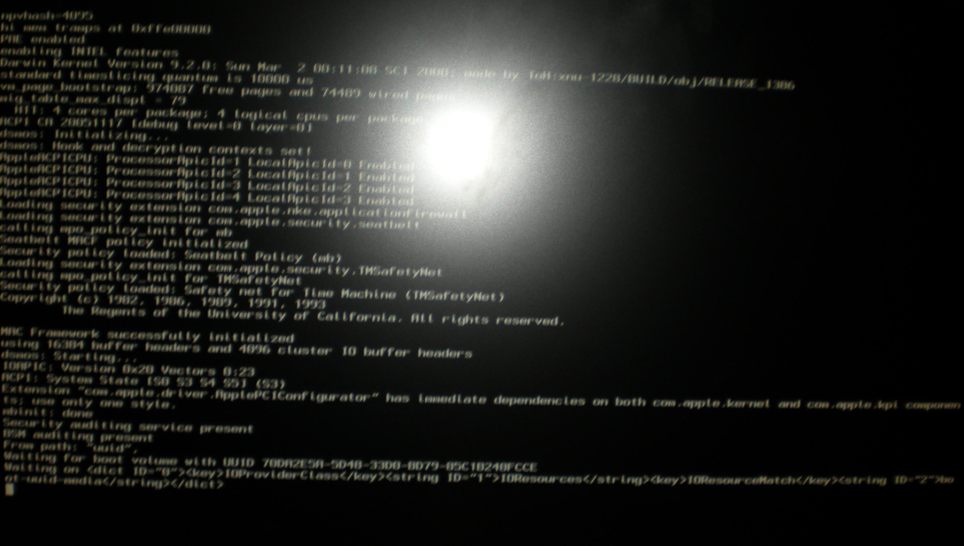

Primary Graphics Adapter Set from internal to PCI-E (options were internal, PCI and PCI-E)
Enabled PCI-IDE Busmaster
NO CHANGE to RAID mode - only option was IDE
Enabled HPET
Disabled Spread Spectrum
Mucked around with SMART - Enabled and Disabled but no changes occurred.
Error: Waiting on <dict ID="o"><key>IOProviderClass</key>....
does that have something to do with I/O Device Setting in BIOS?
Thanks!

Your IDE controller has some strange settings related to IRQ handling.
Try changing those and see if it will boot. Looks like you can set to 'disabled', 'hardwired' and some other stuff. Try all the settings.
It looks like 'disabled' doesn't actually disable it but just doesn't assign an IRQ to it.
Try disabling on-board LAN, try disabling the parallel and serial ports.
Try removing your video card and reconfigure your BIOS to use the on-board video (set shared VGA RAM to the maximum supported amount) and see if it will boot then.
