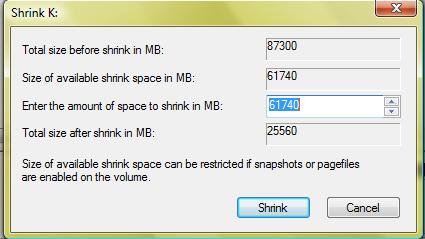

In Vista, click "Start" button, right click "Computer" click "Manage" A window will come up. There is a pane on the left side, find "Storage" then click "Disk Management". In this area, you have to be able to identify your hard drives. Once you have done that, right click the partition you wish to make smaller, and click "Shrink Volume"
Take note which disk you are shrinking.Example: "Disk 0", we'll need this when using DISKPART.
A small window will come up after you have clicked "Shrink Volume". In this window, you will set the size, in MegaBytes (MB), as to much you want to shrink your current partition by. Example: you have a 100GB partition, you want 20GBs for OS X, so then you shrink by 20GB, or 20480MB. You can use an online calculator, if you can't do it in your head. Keep in mind which volume / HD you've shrunk. Such as Disk 0, or Disk 1, I know I said it earlier, but I'm saying it for a reason. Once you're done determining how much free space you'll need, click "Shrink", once it is done, you will have an unallocated partition.

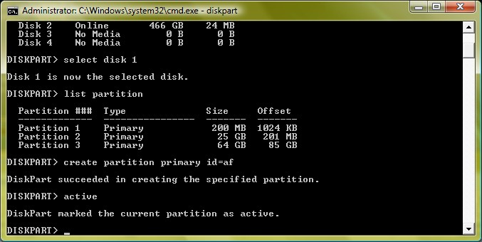

Part 2 – Creating an HFS + Journaled partition in Vista

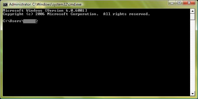

Close everything, click "Start" button, in the search type in "cmd"
Now type in "diskpart". Remember when I mentioned twice to remember which disk you have partitioned? This is where it comes in use.
Type in "list disk" there IS a space between "list" and "disk"!
Type "select disk X" X = the disk you have partitioned. Example: I made a 20GB partition out of a 200GB partition, and it was labeled as disk 0 in Disk Management, I'd type "select disk 0"
Once you have selected the disk with the command mentioned above, diskpart will display "Disk X is now the selected disk" (X = the disk you have partitioned). Now type "list partition" If you know your hard drive has only had one partition, prior to partitioning, and you only see one partition after you've entered "list partition" then we are good, if you see more than one, clearly you did something else, so fix it.
Type "create partition primary id=af" this command makes our unallocated partition into a Mac HFS + Journaled partition. If it is a success you will see, "DiskPart succeeded in creating the specified partition."
Finally type "active". After that you should see, "DiskPart marked the current partition as active" type "exit" and "exit" again, first one is to exit diskpart, second one is to exit dos.

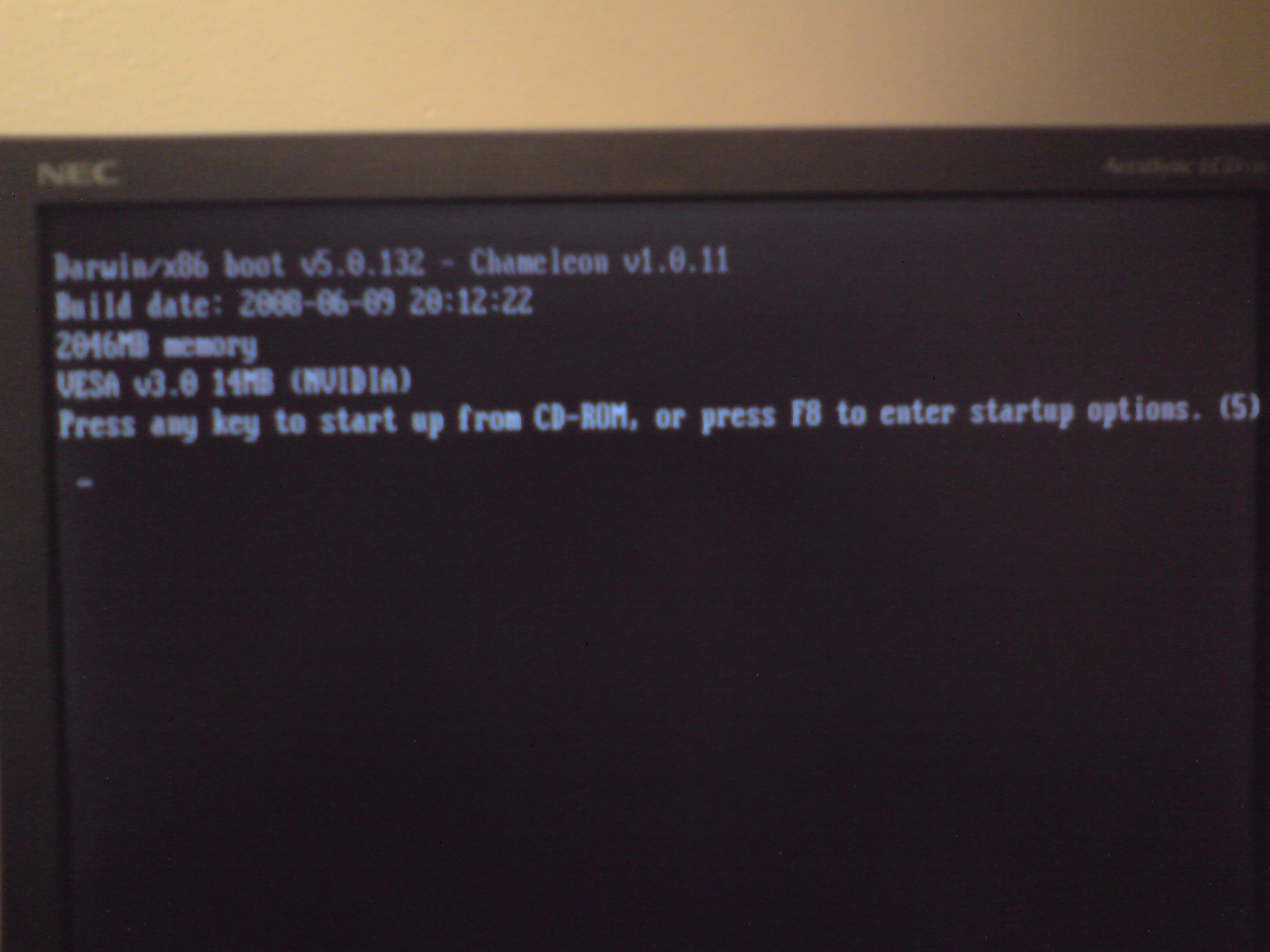

Now close everything, insert your iPC dvd into the dvd drive, reboot your computer. Make sure the boot priority in the BIOS is set to boot off the dvd drive, get out your EP-45-DS3L manual to find out how to set this, if you're nervous in the bios. Or, at boot, when you see POST text, or the green splash screen, hit f12, scroll down to select the dvd drive.A black screen will appear with text displaying "Press any key to start up from the CD-ROM", press any key now.
obviously, press any key.
This is what you'll see booting into the Mac dvd.

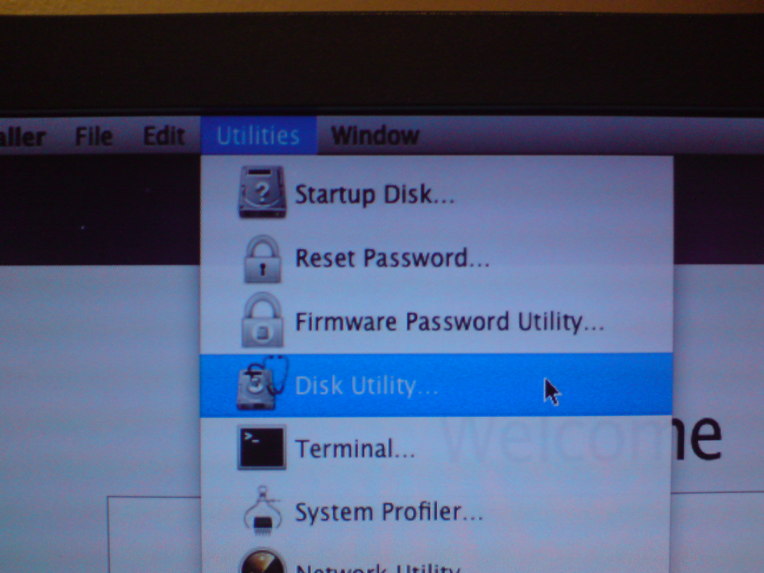

After some time there will be a window where you choose what language you wish to operate in. When the installer appears open the "Disk Utility", to do that go to the top, click "utilities", click "Disk Utility"

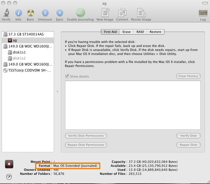

A new window will come up. Now select the disk where you created your Mac partition from Windows, and select the partition. You can tell it is the mac partition you created by looking at each partitions information. At the bottom of this window look at "Format" it should say "Mac OS Extended (journaled)".

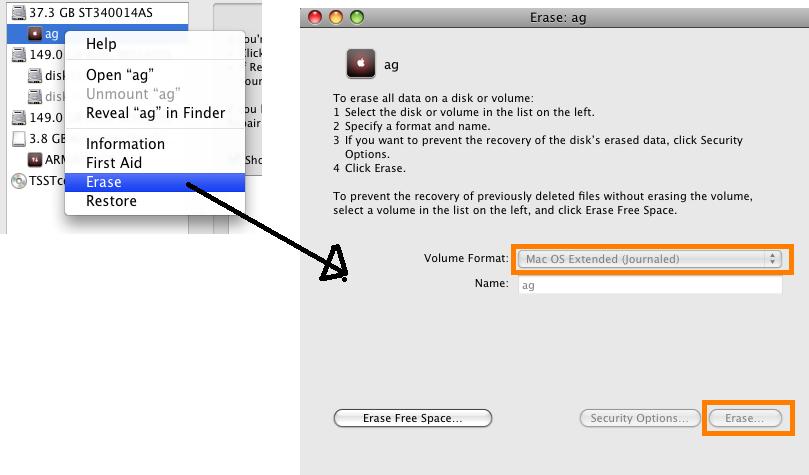

Once you have found the right partition, right click it, click "Erase". Another window will come up, and make sure the format is "Mac OS Extended (Journaled)", finally click "erase".
Once it is erased, click the red button in the top left cornor, the close button, and then again for the Disk Utility window. Now you're back to the main install screen. Click "Continue", then "Agree". The Select a Destination screen is displayed now, click the correct partition / disk to install to. You DO have to customize installation options as per your computer configuration.

I'm in the boot screen right now...it's been like this for like half an hour. I see the apple sign but there's no spinning loading wheel. Is there a problem, or do I have to wait longer,
oof upon further inspection when I get to the part where it says 'press any key to continue' and I don't press right away this pops up:
'system config file '/com.apple.boot.s/library/preferences/systemconfiguration/com.apple.boot.plist' not found
I'm pretty sure I followed the directions to the dot.. The only difference on the Darwin boot page is I have 4gb ram instead of 2.
I'm using the new iPC iso, the one that's 4.3 gb.
Any clue what's going on? My hardware is pretty standard..core2duo 1.83 ghz intel, nvidia 8800gt.
O_O
and now my computer is missing an operating system when I try to boot normally. Halp. X.x
how did u install? what method?
u have to push any key...or else it'll attempt to boot into an already installed mac
and the error u are getting usually means that the mac hd was not set as active

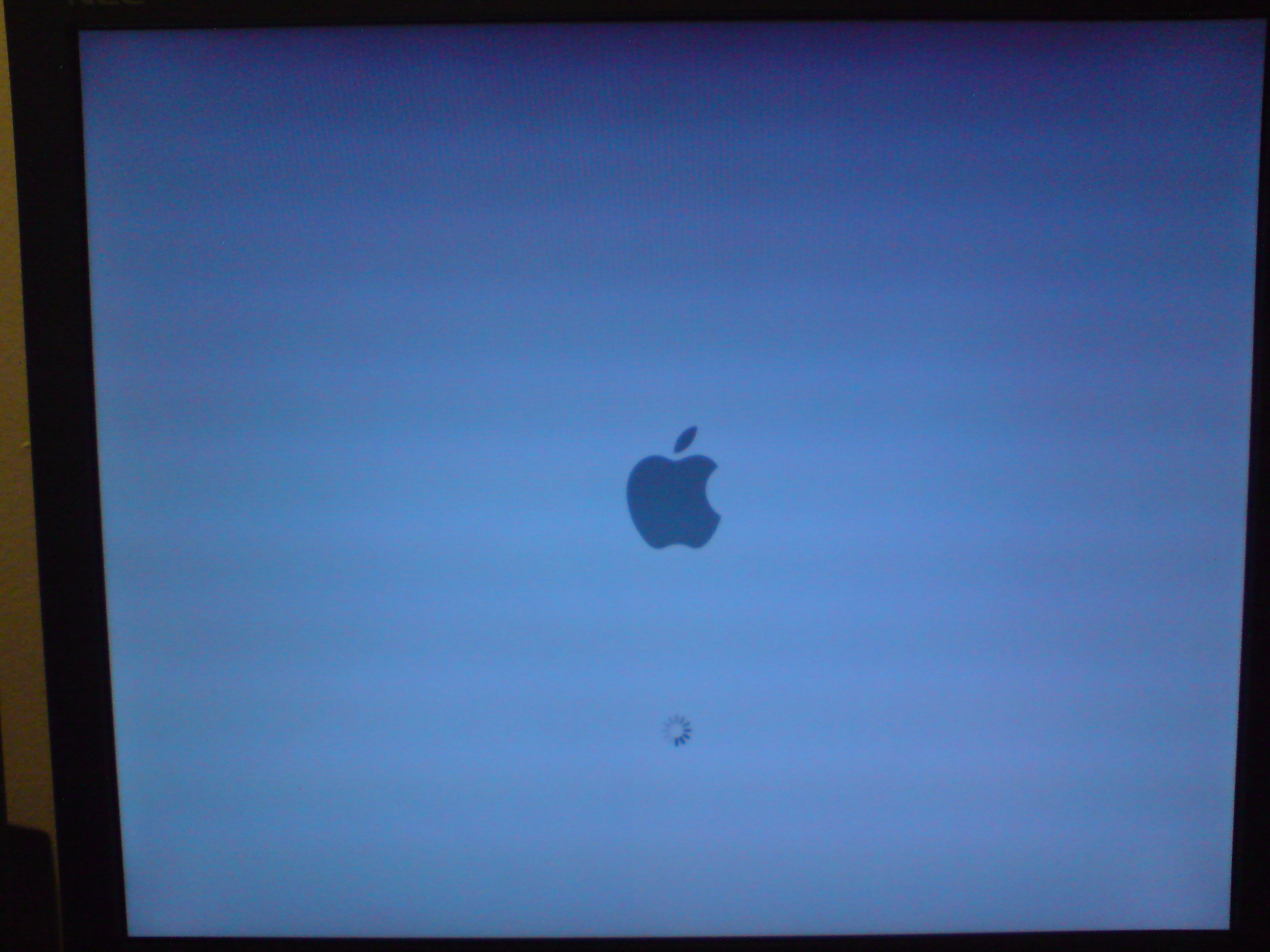

ok ive done this correctly to the absolute T now. but i get stuck, maybe im not, and im not waiting long enough but here is my problem.
the mac dvd boots up, and i get to the grey screen where the mouse cursor turns into the apple spinning color wheel. the cd drive is still spinning, and so is the color wheel for about a minute and nothing comes up.
the cd drive then stops spinning but the apple color wheel is still spinning and all is silent, no hard drive movement, nothing. i once left it there like that for like 5 or so minutes, but i then i turned off my comp, and tryed again. so here is my plea
