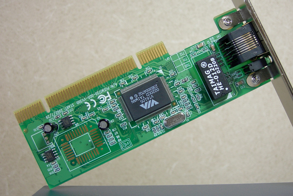

Searay_X Posted March 25, 2009 Share Posted March 25, 2009 Also, on installing a NIC to the system, is there something I am missing or might the card not work? Because I installed a Dlink DFE-530TX (Rev B1 i think) and installed the Dlink drivers from their web site, reboot and it does not detect the card.. Does the card show up running lspci in terminal (or you can get it with OSX86 tools). lspci will let you know if the card is even being detected by the system on a hardware level and then we can go from there. If it worked in windows than its probably good. I am curious if the device ID matches the driver. Regards, Searay Link to comment https://www.insanelymac.com/forum/topic/158951-file-download-will-cause-kernel-panic/#findComment-1115359 Share on other sites More sharing options...
JEB101 Posted March 25, 2009 Author Share Posted March 25, 2009 Does the card show up running lspci in terminal (or you can get it with OSX86 tools). lspci will let you know if the card is even being detected by the system on a hardware level and then we can go from there. If it worked in windows than its probably good. I am curious if the device ID matches the driver. Regards, Searay Here is a copy of my LSPCI report. 00:00.0 Host bridge [0600]: Intel Corporation 82X38/X48 Express DRAM Controller [8086:29e0] (rev 01) 00:01.0 PCI bridge [0604]: Intel Corporation 82X38/X48 Express Host-Primary PCI Express Bridge [8086:29e1] (rev 01) 00:1a.0 USB Controller [0c03]: Intel Corporation 82801I (ICH9 Family) USB UHCI Controller #4 [8086:2937] (rev 02) 00:1a.1 USB Controller [0c03]: Intel Corporation 82801I (ICH9 Family) USB UHCI Controller #5 [8086:2938] (rev 02) 00:1a.2 USB Controller [0c03]: Intel Corporation 82801I (ICH9 Family) USB UHCI Controller #6 [8086:2939] (rev 02) 00:1a.7 USB Controller [0c03]: Intel Corporation 82801I (ICH9 Family) USB2 EHCI Controller #2 [8086:293c] (rev 02) 00:1b.0 Audio device [0403]: Intel Corporation 82801I (ICH9 Family) HD Audio Controller [8086:293e] (rev 02) 00:1c.0 PCI bridge [0604]: Intel Corporation 82801I (ICH9 Family) PCI Express Port 1 [8086:2940] (rev 02) 00:1c.2 PCI bridge [0604]: Intel Corporation 82801I (ICH9 Family) PCI Express Port 3 [8086:2944] (rev 02) 00:1c.4 PCI bridge [0604]: Intel Corporation 82801I (ICH9 Family) PCI Express Port 5 [8086:2948] (rev 02) 00:1d.0 USB Controller [0c03]: Intel Corporation 82801I (ICH9 Family) USB UHCI Controller #1 [8086:2934] (rev 02) 00:1d.1 USB Controller [0c03]: Intel Corporation 82801I (ICH9 Family) USB UHCI Controller #2 [8086:2935] (rev 02) 00:1d.2 USB Controller [0c03]: Intel Corporation 82801I (ICH9 Family) USB UHCI Controller #3 [8086:2936] (rev 02) 00:1d.7 USB Controller [0c03]: Intel Corporation 82801I (ICH9 Family) USB2 EHCI Controller #1 [8086:293a] (rev 02) 00:1e.0 PCI bridge [0604]: Intel Corporation 82801 PCI Bridge [8086:244e] (rev 92) 00:1f.0 ISA bridge [0601]: Intel Corporation 82801IR (ICH9R) LPC Interface Controller [8086:2916] (rev 02) 00:1f.2 SATA controller [0106]: Intel Corporation 82801IR/IO/IH (ICH9R/DO/DH) 6 port SATA AHCI Controller [8086:2922] (rev 02) 00:1f.3 SMBus [0c05]: Intel Corporation 82801I (ICH9 Family) SMBus Controller [8086:2930] (rev 02) 01:00.0 VGA compatible controller [0300]: nVidia Corporation GeForce 8800 GT [10de:0611] (rev a2) 02:00.0 IDE interface [0101]: JMicron Technologies, Inc. JMB368 IDE controller [197b:2368] 03:00.0 Ethernet controller [0200]: Marvell Technology Group Ltd. 88E8056 PCI-E Gigabit Ethernet Controller [11ab:4364] (rev 12) 05:01.0 Ethernet controller [0200]: VIA Technologies, Inc. VT6105/VT6106S [Rhine-III] [1106:3106] (rev 86) 05:03.0 FireWire (IEEE 1394) [0c00]: VIA Technologies, Inc. VT6306 Fire II IEEE 1394 OHCI Link Layer Controller [1106:3044] (rev c0) Hope this helps! also, the NIC's I got are from RFO (Really Freaking Old) computers... But this one according to windows is Dlink DFE-530TX rev. C1 I was just going over it once more, and it doesn't even look like it's there at all... I see the Marvel Adapter which is onboard, and I believe that the VIA Enet controller is my IEEE1394 controller interface. Should I try a DFE-538 instead? Link to comment https://www.insanelymac.com/forum/topic/158951-file-download-will-cause-kernel-panic/#findComment-1115590 Share on other sites More sharing options...
Searay_X Posted March 25, 2009 Share Posted March 25, 2009 Here is a copy of my LSPCI report. 05:01.0 Ethernet controller [0200]: VIA Technologies, Inc. VT6105/VT6106S [Rhine-III] [1106:3106] (rev 86) The above is not a fire wire... Take a look at this See the 1106:3106? that is your device ID which has to be in IOPCIMatch field of your kext's info.plist as 0x31061106 The attached kext should get you up and running. Use kext helper b7 to install it (you can find that http://cheetha.net/ at the bottom of the page) Try that and let me know if it works for you Regards, Searay ViaRhine.kext.zip Link to comment https://www.insanelymac.com/forum/topic/158951-file-download-will-cause-kernel-panic/#findComment-1115634 Share on other sites More sharing options...
JEB101 Posted March 25, 2009 Author Share Posted March 25, 2009 The above is not a fire wire... Take a look at this See the 1106:3106? that is your device ID which has to be in IOPCIMatch field of your kext's info.plist as 0x31061106 The attached kext should get you up and running. Use kext helper b7 to install it (you can find that http://cheetha.net/ at the bottom of the page) Try that and let me know if it works for you Regards, Searay Thank you very much for the file! Unfortunately, even after using kext installer and fixing permissions it keeps saying that it's invalid and not setup correctly. I have tried doing it manualy, with kext editor, fix perms with Onyx, and keeps coming up on boot not valid.. Link to comment https://www.insanelymac.com/forum/topic/158951-file-download-will-cause-kernel-panic/#findComment-1115682 Share on other sites More sharing options...
Searay_X Posted March 26, 2009 Share Posted March 26, 2009 Thank you very much for the file! Unfortunately, even after using kext installer and fixing permissions it keeps saying that it's invalid and not setup correctly. I have tried doing it manualy, with kext editor, fix perms with Onyx, and keeps coming up on boot not valid.. Ill check it and get another ready for you. Sorry about that - Ok, I just loaded the attached and it did load on both a Hack and real Mac - Some weird persistent permission issue that I had to manually change. Let me know if this one works ViaRhine.kext.zip Link to comment https://www.insanelymac.com/forum/topic/158951-file-download-will-cause-kernel-panic/#findComment-1115776 Share on other sites More sharing options...
JEB101 Posted March 26, 2009 Author Share Posted March 26, 2009 Ill check it and get another ready for you. Sorry about that - Ok, I just loaded the attached and it did load on both a Hack and real Mac - Some weird persistent permission issue that I had to manually change. Let me know if this one works I'm not sure what i'm doing wrong, but OSX refuses to use it. This time it installed correctly, even got an update message on shutdown. But I did manage to get my Marvel Adaptor working. Something weird happened though.. When I was deleting the original file you gave me I got a popup saying EN1 was found and is now in network, I check it out but canot open Network, so I install your file, reboot with success update message, come back without EN1, BUT my yukon chip started working with no problem, which is weird because I have a Stock ionetworkingfamily.kext with no added kext for the nic. So I think I'm going to try the DFE-538TX I have, they all have the same chipset. On the 530TX I have here it sais DL10030B on chip, and have an older of same modem with A. The 538TX I have all have the same DL10030C chip. These cards are close to 10 years old and before they changed to new chipsets.. Also, I seem to have the seatbelt KP happening, no biggie I got the files here Just need to replace, but I know this is going to be a dumb question.. I thought that I was running Vanilla 9.6 turns out 9.2.2.. Where would I go along to update again? Also, my buddy has a MBP and sais he can give me a copy of his.. Would that work? Thanks again for all your help!!! Link to comment https://www.insanelymac.com/forum/topic/158951-file-download-will-cause-kernel-panic/#findComment-1116193 Share on other sites More sharing options...
verdant Posted March 26, 2009 Share Posted March 26, 2009 I'm not sure what i'm doing wrong, but OSX refuses to use it. This time it installed correctly, even got an update message on shutdown. But I did manage to get my Marvel Adaptor working. Something weird happened though.. When I was deleting the original file you gave me I got a popup saying EN1 was found and is now in network, I check it out but canot open Network, so I install your file, reboot with success update message, come back without EN1, BUT my yukon chip started working with no problem, which is weird because I have a Stock ionetworkingfamily.kext with no added kext for the nic. So I think I'm going to try the DFE-538TX I have, they all have the same chipset. On the 530TX I have here it sais DL10030B on chip, and have an older of same modem with A. The 538TX I have all have the same DL10030C chip. These cards are close to 10 years old and before they changed to new chipsets.. Also, I seem to have the seatbelt KP happening, no biggie I got the files here Just need to replace, but I know this is going to be a dumb question.. I thought that I was running Vanilla 9.6 turns out 9.2.2.. Where would I go along to update again? Also, my buddy has a MBP and sais he can give me a copy of his.. Would that work? Thanks again for all your help!!! Why not simply use Voodoo 9.5.0 from here.......? Link to comment https://www.insanelymac.com/forum/topic/158951-file-download-will-cause-kernel-panic/#findComment-1116206 Share on other sites More sharing options...
