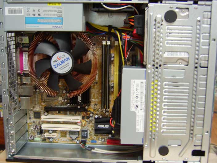

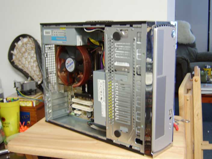

Well I got this HSF and replaced the factory intel one. First of all it's HUGE!!! So big that it didn't fit in my mATX case without alittle modding. I had to cut the some of the fins on the copper heatsink on the side of the psu to fit it in. the install was fairly easy though outside of that. Temps are in the mid 40's during full load, sorta wish they were lower based on the reviews from newegg. apparently some were getting down to 29c with basically the same setup (and a larger case with better air flow i assume). enjoy the photos

Get a better case. You can't stick a chip that hot into a case that small and expect it to actually have low temps. First off, did you make sure to use AS5? Second, Zalman coolers are extremely touchy. Modding the fins in any way has been known to cause a serious loss of performance.

yes I used arctic silver and if the case is too small then so be it. I wasn't expecting low temps but I was expecting an improvement over the stock intel HSF. If modding the fins caused this then it's my own fault...oh well. I've already got a full server tower and 2 mini towers in my office @ home, the last thing I needed to {censored} off the woman was another large case so I went smaller...anyone know the temps of the intel D 805 on this board?
