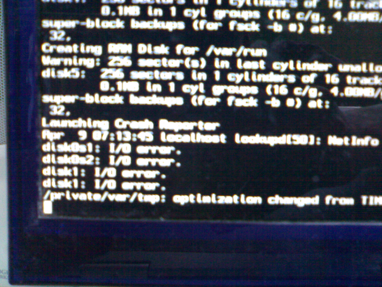

hey,
i have downloaded and burned the 10.4.5 installer DVD, and i boot using the -v flag. in the verbose, i get a disk I/O error.
however, the DVD still loads but i can't partition or install, so i am sure that the i/o error is the root of the problem. i have 2 hard disks, an 80gb which is jumpered as master, and a 120gb disk which is a slave, and they are both IDE.
i am using an MSI K8N Neo4-F (mobo web link)
i have an AMD 3200+ (venice), and an xfx 6800XT.
please tell me if you require an more information.
thanx in advance,
jordn

hey alicheusz,
i burned my iso with the nero tools, and i burned it at its minimum speed. still no luck. :(
jordn

Try conect HDD on one cable, not HDD and CDROM on this same cable. Try change some setting in bios . I have something like Enchenced mode and compatibility mode for IDE. Search for some setting like prefeth or burstmaster and turn it off
Search on HLC part for clues on IDE
this one thread I find
http://forum.osx86project.org/lofiversion/....php/t3851.html
I think that on this forum someone already figured out solution for this problem. This looks that Install dvd don't have approbate kext for you maybe you will have to path 10.4.4 dvd manually with your kext
Use search put keyword like nForce4 and MSI K8N Neo4-F or nFroce IDE or SATA
My knowledge is finish now. :)
Good luck

hey,
i have read all the links that you have sent me and none of them were of any use. i have disabled any advanced features relating to hard disks and IDE but to no avail. thank you for your help anyway.
does anybody have any suggestions?
jordn

I had a major I/O error. Or that’s what someone else called it.
Was told to change the DVD drive. When I did so it worked perfectly. But I had a spare DVD drive sitting next to my computer so that was easy. If you have one, try the same or borrow one for a while and if it works swap back.
Hope this helps :(
