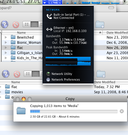

MacUser2525 Posted December 21, 2008 Share Posted December 21, 2008 Thanks Macgirl. But are you getting full Gig-E performance from them? Like > 10 mB/sec? My Gig-E 8111b built-in ethernet also "works" but it maxes out at 2 mB/sec while a 10/100 card on the same system maxes out its bandwidth at 10 mB/sec. Have you looked at your transfer rates via Activity Monitor? There's working... and then there's WORKING Works here from my main to spare machine (8111C to 8111B) I routinely get 50-60 sometimes 70 like it shows for the max in the picture, perhaps you have a bad cable or router port. Edit: Running 10.5.6 but the speed never has really changed with any version I have run only IONetworkingFamily changed for Time Machine. Link to comment https://www.insanelymac.com/forum/topic/141612-is-there-a-100-working-solution-for-gigabit-lan-on-leopard/#findComment-1009099 Share on other sites More sharing options...
limini Posted December 22, 2008 Author Share Posted December 22, 2008 Thanks a heap MacUser2525! I was beginning to wonder. These are the speeds I'm looking for. I've tested with two cables and they both work at full Gig-E on another computer. I also had to fix IONetworkingFamily for Time Machine to work but most of my install is vanilla. However my RTL8111B is actually recognized as a RTL8168B by the system and this is a vanilla driver. Which driver are you using? Maybe that's my problem. Link to comment https://www.insanelymac.com/forum/topic/141612-is-there-a-100-working-solution-for-gigabit-lan-on-leopard/#findComment-1009322 Share on other sites More sharing options...
