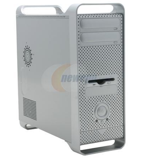

Wman Posted December 18, 2008 Share Posted December 18, 2008 Its compatible. You're paying too much for that gfx card, don't buy that case!!!! Its the ugliest (and apperently crappiest) thing I've ever seen and looks nothing like a mac pro case, NOTHING! Link to comment https://www.insanelymac.com/forum/topic/141571-is-my-build-compatible/#findComment-1003773 Share on other sites More sharing options...
CLS-PRODUCTIONS Posted December 18, 2008 Author Share Posted December 18, 2008 Its compatible. You're paying too much for that gfx card, don't buy that case!!!! Its the ugliest (and apperently crappiest) thing I've ever seen and looks nothing like a mac pro case, NOTHING! oh where can i get it cheeper ? that was on amazon ? and yeah i found the case on new egg and they say its total {censored} thanks for your help : ) Link to comment https://www.insanelymac.com/forum/topic/141571-is-my-build-compatible/#findComment-1003827 Share on other sites More sharing options...
Wman Posted December 18, 2008 Share Posted December 18, 2008 I've seen a link to a newegg retailer that sells it somewhere. Search "slick hackintosh cases" and there's a thread that I beleive has the link in it. I'll find it for you, but I wouls sleep better tonight if I knew that the makers of that foul perversion of nature would not be rewarded (in the form of like 50$ for such a cheap case) for its creation!!! nvm, I searched through that thread and I no longer seem to be able to find it. I suggest a Lian-Li case. Link to comment https://www.insanelymac.com/forum/topic/141571-is-my-build-compatible/#findComment-1003892 Share on other sites More sharing options...
