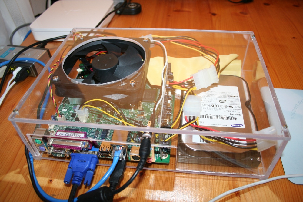

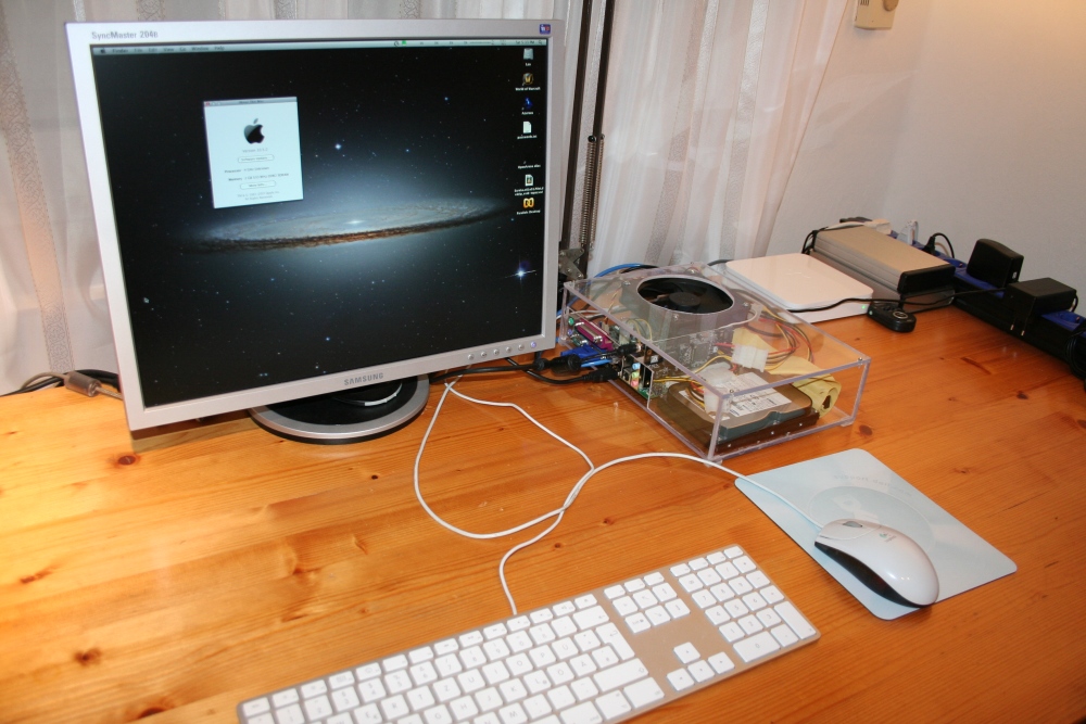

jslocum Posted November 1, 2008 Share Posted November 1, 2008 Hi guys, first, I would like to thank the great OS86X community for creating drivers, patches and work-arounds to let OsX run on non-Apple hardware. Especially, the distro-guys spending a lot of time doing an excellent job deserve a huge thanks! This is my second home-brew hackintosh. The last one consumed to many power to run 24/7 so i switched to D945GCLF2 (Atom 330) + 2GB + 160GB system disc + extern sata discs for the XBMC in the living room + Sil3114 (4xsata) + picoPSU-120 120W + 12@6A power supply. I've installed Kalyway 10.5.2 and updated it to 10.5.3, removed the small and loud chip-set fan and installed a temperature-controlled quiet 12cm fan. Anything is working perfectly except the sound and the last two of the four sata ports on the Sil3114 card. In this configuration and without the external harddiscs the system consumes 45W. With the two additional external discs it takes about 60W. The system is fast enough to run Azureus on full speed (1.5Mybyte/s on a 16Mbit DSL line) and to serve movies to the XBMC at the same time without any delays. If you want to have a cheap, quiet and not power-hungry OsX-box, D945GCLF2 is the right decision! cq Link to comment https://www.insanelymac.com/forum/topic/134271-45w-atom-330-d945gclf2-kaliway-1052-1053-update/ Share on other sites More sharing options...
