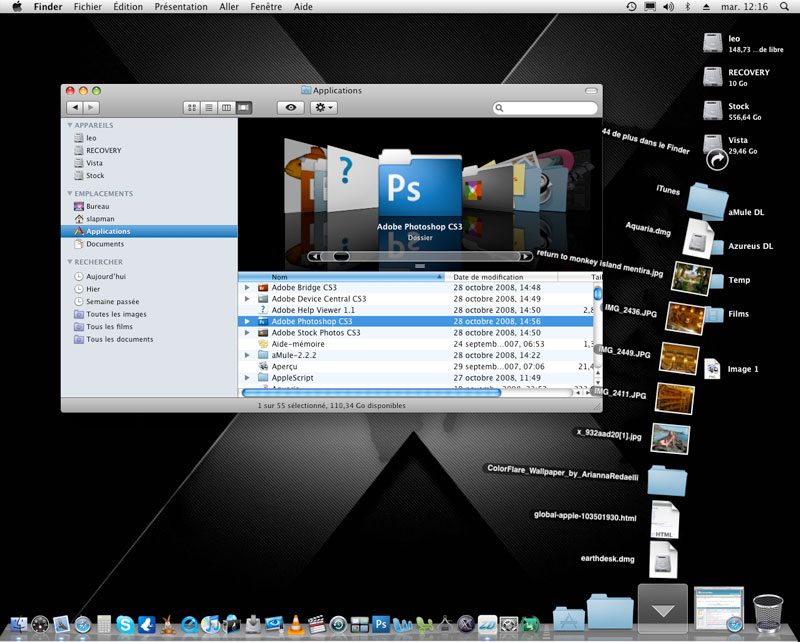

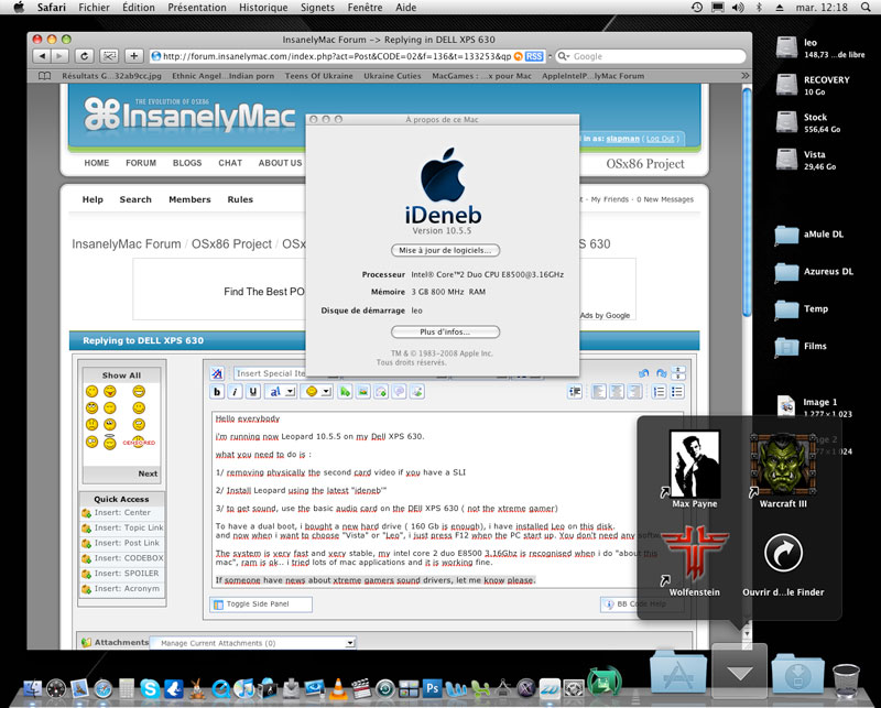

slapman Posted October 26, 2008 Share Posted October 26, 2008 Hello everybody i'm running now a dual boot : Vista / Leopard 10.5.5 on my Dell XPS 630. what you need to do is : 1/ remove physically the second card video if you have a SLI 2/ Install Leopard using the latest "ideneb 10.5.5'" 3/ to get sound, use the basic audio card on the DEll XPS 630 ( not the xtreme gamer) To have a dual boot, i bought a new hard drive ( 160 Gb is enough), i have installed Leo on this disk. and now when i want to choose "Vista" or "Leo", i just press F12 when the PC start up. You don't need any software. The system is very fast and very stable, my intel core 2 duo E8500 3.16Ghz is recognised when i do "about this mac", ram is ok.. i tried lots of mac applications and it is working fine. Have a look to my screenshots. If someone have news about "xtreme gamers" sound drivers, let me know please. Best regards Slapman Link to comment https://www.insanelymac.com/forum/topic/133253-dell-xps-630/ Share on other sites More sharing options...

slapman Posted November 24, 2008 Author Share Posted November 24, 2008 hi, in the iDeneb 10.5.5 install, you need to put these essential drivers : Kernel Speedstep, ALC888Audio, Nvinject, AppleNForceATA (chipset), put all apple bios, and put the Fix drivers for ACPI, CPus=1, power off fix. it should work to get audio stable, you need to go to the BIOS (dell) and put HDMI for audio. after, when you are in OS X, you will need "carbonlib_FIX" (easy to find in the forum) for launching appli installers. Let me know if it is ok for you or if you have trouble. Slapman my config : XPS630 Core 2 Duo 3.16GHZ 8800GT 512mb 3GB ram Dual boot Vista / Leopard Link to comment https://www.insanelymac.com/forum/topic/133253-dell-xps-630/#findComment-976219 Share on other sites More sharing options...
