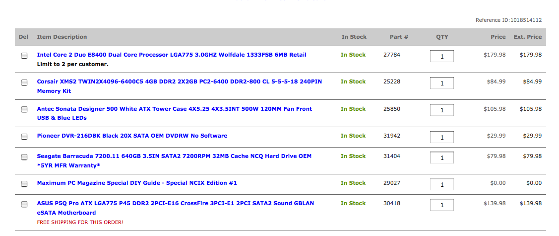

modis Posted October 9, 2008 Share Posted October 9, 2008 hello Basically right now I own a 15 inch powerbook, looking to get something faster and for some games. here is the configuration i came up with but is missing a video card. Please let me know if all the parts should work ok and what video card you guys would recommend to go along with it, I'm leaning towards a 8800gt. my basic questions for now are: - are my hardware choices compatible with osx86? - is anything over or underspeced (sticks out from the bunch)? - what changes would you make? thanks Link to comment https://www.insanelymac.com/forum/topic/130357-please-offer-opinions-on-my-hackintosh-config-before-i-buy/ Share on other sites More sharing options...

Envying Posted October 10, 2008 Share Posted October 10, 2008 I would suggest a Gigabyte P45 mobo, not ASUS P5Q. Because you will need a mod bios for P5Q to get rid of CPUS=1... Link to comment https://www.insanelymac.com/forum/topic/130357-please-offer-opinions-on-my-hackintosh-config-before-i-buy/#findComment-925097 Share on other sites More sharing options...
modis Posted October 11, 2008 Author Share Posted October 11, 2008 ^ thanks here is my revised build motherboard: Gigabyte EP45-DS3L or Gigabyte EP45-DS3R cpu: Intel E8400 Core 2 Duo ram:GSKILL 4gb F2-6400 video card: I've found a asus 8800GS 384mb on sale so i'm going to get that. dvd drive:Pioneer DVR-216DBK hdd:Seagate 7200.11 640gb case:Antec Sonata 500 White w/ PSU other: two 92mm fans for the front of the case. like i said before computer will be used for a general purpose computer and for gaming. which motherboard should I go with? Other than that, anything I should be aware of before I go ahead and purchase? Link to comment https://www.insanelymac.com/forum/topic/130357-please-offer-opinions-on-my-hackintosh-config-before-i-buy/#findComment-925867 Share on other sites More sharing options...
JaE-V Posted October 11, 2008 Share Posted October 11, 2008 ^ thanks here is my revised build motherboard: Gigabyte EP45-DS3L or Gigabyte EP45-DS3R cpu: Intel E8400 Core 2 Duo ram:GSKILL 4gb F2-6400 video card: I've found a asus 8800GS 384mb on sale so i'm going to get that. dvd drive:Pioneer DVR-216DBK hdd:Seagate 7200.11 640gb case:Antec Sonata 500 White w/ PSU other: two 92mm fans for the front of the case. like i said before computer will be used for a general purpose computer and for gaming. which motherboard should I go with? Other than that, anything I should be aware of before I go ahead and purchase? Go with the DS3R....and i'd suggest the 8800GT for better performance Link to comment https://www.insanelymac.com/forum/topic/130357-please-offer-opinions-on-my-hackintosh-config-before-i-buy/#findComment-926393 Share on other sites More sharing options...
modis Posted October 11, 2008 Author Share Posted October 11, 2008 ok so i've just about finalized my order. going to go with the ds3r and a q6600 processor as it's only $18 more than the duo core i had selected. i think i'm going to go with the 8800gs just because it's $50 after $30 MIR, and I will upgrade it when I can find a higher performance card for ~$100. any objections before i go for it? thank you very much for the replies Link to comment https://www.insanelymac.com/forum/topic/130357-please-offer-opinions-on-my-hackintosh-config-before-i-buy/#findComment-926427 Share on other sites More sharing options...
