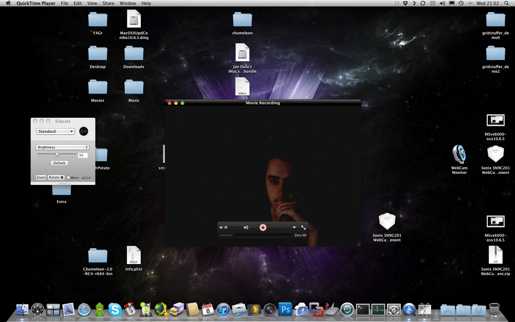

frantisheq Posted December 8, 2010 Author Share Posted December 8, 2010 vx-6000 working again under 10.6.5. there is a new driver version 1.03 on sonix website. just put it in /Library/QuickTime and reboot maybe. no iChat, no PhotoBooth Sonix_SN9C201_WebCam.component.zip iGlasses, QuickTime, VX-6000 Link to comment https://www.insanelymac.com/forum/topic/129713-using-sonix-driver-with-microsoft-lifecam-vx-6000-and-others/page/4/#findComment-1598958 Share on other sites More sharing options...
