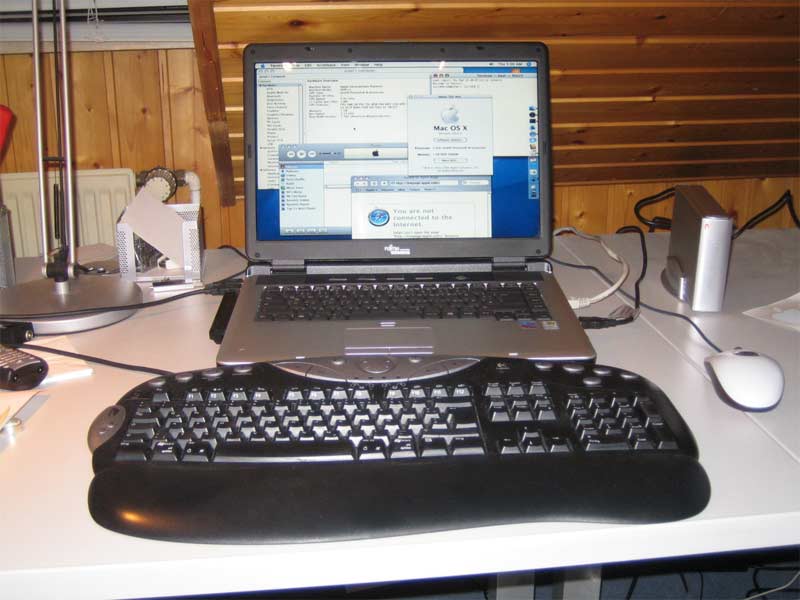

-TiLT- Posted March 24, 2006 Share Posted March 24, 2006 Hello OSX-friends. This thread is meant for FSC laptops, especially the x43xG series, like the Fujitsu Siemens Amilo M 1437G, 1439G, 3438G, 4438G, Uniwill P71EN0 and Alienware S-4 m5700. Installing OSX on these laptops seems to be quite impossible, tho I already reached little success with only little knowledge. Nevertheless you can install OSX on these laptops in VMWare but its not realy nice to work copious under a virtual machine. Trying to do a native install is often crashing with different kernel panics. Even booting VMWare2native installs (http://forum.osx86project.org/index.php?showtopic=11314) crash, when booting native. (But is a main part of the way how to get 4.5 working, so follow this link as well) It seems to be the hurdle, finding the incompatible part in our laptops, ´cause a short look on the hardware and on the compatibility-wiki shows mostly supported hardware. (Or it is after tweaking some kext) Tonight I finally got it working. I have a running 4.5 on a 1437G. It took me about 7 or 8 days an is definitely not quite fully developed. The main problem is the SATA-HD attached at the VIA6421 and no possibility of emulating a PATA HD. The BIOS simply has disabled that. (And many other things) If you want to make OSX boot on this laptop be prepared to have USB-Mouse USB-Keyboard USB-Harddisk 1 more primary partition on your internal HD The theory is excluding problematic kext from a working VMWare installation. (As it always is ) I. If you want to work on 10.4.3 the ACPIProcessor.kext in /System/Library/Extensions/AppleACPIPlatform/Contents/Plugins has to be renamed or removed. That way there are no more kernel panics while booting native. II. For 10.4.5 the ApplePS2Controller.kext is the problematic one. Removed from Extensions, kernel panics are gone, BUT you have no more support for touchpad and keyboard (even in VMWare) so be prepared. You should have Macdrive6 or a another VMWare working copy, to continue working in this installation. Later, when we came to the point when it boots natively, you can use a USB-Mouse and Keyboard. Be aware of pressing a button on the laptops keypad while in 10.4.5. In text mode it will give you a kernel panic, in graphics mode as well, so the system hangs. Use USB-Keyboard, when slightly reaching point III. III. VIA6421 issue As far as I know, its impossible to boot from VIA6421-connected SATA drives. (Hopefully someone fixes that). The 1437G has no possibility to boot from USB-Harddrive, too (Mine could not directly, maybe other drives are more compatible). The workaround was, to have one installation on the Harddisk (patched like in I or II, and booting properly until the root device is not found) AND have a clone of this on your USB-storage. The reason is that the USB storage will jump into position “disk0” and continues the booting process instead of your internal-harddrive. (I had to buy an empty USB-Harddisk-Case to find out ^^). Now my 10.4.5 came up, completely incompatible with everything (Graphics, W-Lan, Audio, SATA, Modem). When trying the same thing with 10.4.3, the booting process did not finish for any reason I don´t know, but I think, its not reasonable to go on finding a way to boot 10.4.3 although keybord/mouse might be usable, maybe we can port the ApplePS2Controller.kext to 10.4.5. Would be worth a try.) Now that we are able to have the system booting natively, I hope to find some comrades-in-arms who will work together in fixing the problems, as we now know, … …FSC x37xG IS definitely compatible! (sorry, I´m just happy about that) I hope I did not forget something, as its late now in Germany (5 in the morning) and I did not sleep well the last nights. Had nightmares of never getting this OS on my laptop working and saw myself walking jerkingly through a VMWare OSX, while Safari always pointed at me and said “looser, looooooser” If you have any questions, feel free to ask. Clues are greatly appreciated. German native speakers: Fragt ruhig in deutsch, wenn ihr euch auf englisch nicht traut (Dont be shy to ask in German, when you think your English is not enough. Thats only because I am german as you might already have noticed while reading this post) I hope as well that some of our OSX86 experts read this and maybe know, how to workaround some of the problems better than I did. Any useful information will be edited in this post. Hopefully this will end in an easy howto for x37xG´s. Cheers -TiLT- As a sidenote: I was working with a OSx86 10.4.3 8F1111A Patched Jas v4.2b and a clean 10.4.4 with MacOSX_10.4.4DVD_latest.ppf. Link to comment https://www.insanelymac.com/forum/topic/12927-fujitsu-siemens-owners-read-this-the-x43xg-issue/ Share on other sites More sharing options...
-TiLT- Posted March 26, 2006 Author Share Posted March 26, 2006 Still no progress on the VT6421. I need some help for that. (DeviceID is 0x3249 Vendor 0x1006) Editing AppleVIAATA.kext in section SATA gave me no result. No booting from SATA, even no HDs recognized in the running system. Even editing AppleAHCIPort.kext gives no results. Have VIAATA or AHCIPort hardcoded deviceIDs in their drivers binarys? I do not really understand how, while booting, the bootloader is able to read /System/Library/Extensions*, but after he finished has no more access to the harddisk. Can anyone explain this to me? Is this the EFI-emulator who does this? How are the harddisks accessed while booting, and how are they lateron, when running the OS? Link to comment https://www.insanelymac.com/forum/topic/12927-fujitsu-siemens-owners-read-this-the-x43xg-issue/#findComment-83171 Share on other sites More sharing options...
-TiLT- Posted March 26, 2006 Author Share Posted March 26, 2006 Something I have to ask for, because I cannot find a way to do it myself. Could one of the mods please edit thread title and subtitle in "Fujitsu-Siemens-owners. Read this! The x43xG issue." "1437G, 1439G, 3438G, 4438G, Uniwill P71EN0 motherboard, SATA, USB-boot" Somehow I have mixed something up in there. Thanx Link to comment https://www.insanelymac.com/forum/topic/12927-fujitsu-siemens-owners-read-this-the-x43xg-issue/#findComment-83532 Share on other sites More sharing options...
-TiLT- Posted April 8, 2006 Author Share Posted April 8, 2006 Yes, I think I tried this as well. I suppose the solution might be a combination of device-id editing and deleting some of the kext that block the sata detection. At the moment I do not have my Amilo available. Hopefully in the next weeks it will return from service and I can go on testing. Thank you anyway. Good to know there are others that deal with this problem as well Link to comment https://www.insanelymac.com/forum/topic/12927-fujitsu-siemens-owners-read-this-the-x43xg-issue/#findComment-92012 Share on other sites More sharing options...

-TiLT- Posted June 2, 2006 Author Share Posted June 2, 2006 As I do not have a 1437G anymore, I will try to explain from what I remember. 1. Create a partition (just as big as you need for the installation, because you can not use this space for anything) 2. Install OSX via VMWare to this partition. Remove /System/Library/Extensions/AppleACPIPlatform.kext 3. Remove the ApplePS2Controller.kext 4. Remove /System/Library/Extensions.mkext and .kextcache and let them be rebuild. 5. Clone the partition to a USB-Harddisk 6. Reboot and use rd=diskXsY (whereas X and Y are replaced with the number of the USB Drive and the partition to be used) to access the USB harddisk as the startup drive. That way the system loads its base features from the internal harddisk, and when it comes to the point where it wants to use all kext, it can go on to load from the USB disk. My 10.4.6 shows VIA-Sata support, maybe it is usable after a VMWare installation. Hope this helps. Link to comment https://www.insanelymac.com/forum/topic/12927-fujitsu-siemens-owners-read-this-the-x43xg-issue/#findComment-123728 Share on other sites More sharing options...

Cillit Bang Posted June 9, 2006 Share Posted June 9, 2006 I have an FSC Amilo M3438G. When I try to boot the Setup from the DVD it it has somemkind of a problem with the PS2 controller and it stops there. How can I install it? I also don't get how I can remove the extensions. I'm trying to get it to work for days. I installed it in VMware and it worked, but when I try to boot i just see a blinking cursor. Hope somebody can help me!!! Link to comment https://www.insanelymac.com/forum/topic/12927-fujitsu-siemens-owners-read-this-the-x43xg-issue/#findComment-127047 Share on other sites More sharing options...
-TiLT- Posted June 9, 2006 Author Share Posted June 9, 2006 It was a 10.4.4/10.4.5 DVD with maxxuss patches on it. Was the first DVD I dled, and it came from a rapidshare space, and there was no special name given. Sorry. @Cillit Bang: The kexts are located in /System/Library/Extensions. Additionally they are cached in /System/Library/Extensions/Extensions.mkext und /System/Library/Extensions/Extensions.kextcache. Those two files must be removed and the kext. When rebooting now, the kextcache gets recreated without the deleted kext. -- What still makes me think about is why the system hangs at the ps2controller.kext. I thought, those touchpads are all the same and wired up similar. What is different about this one? Link to comment https://www.insanelymac.com/forum/topic/12927-fujitsu-siemens-owners-read-this-the-x43xg-issue/#findComment-127079 Share on other sites More sharing options...
Cillit Bang Posted June 9, 2006 Share Posted June 9, 2006 @Tilt: Thanks for your answer, but I don't know where I can find those files! Do you mean on the CD. If so, i can't see any folders just bootfiles Link to comment https://www.insanelymac.com/forum/topic/12927-fujitsu-siemens-owners-read-this-the-x43xg-issue/#findComment-127285 Share on other sites More sharing options...
-TiLT- Posted June 10, 2006 Author Share Posted June 10, 2006 No, you find them, after you install OSX via VMWare. Typically the way to deal with problematic systems would be to install OSX via VMWare onto a physical disk (howto is here http://forum.osx86project.org/index.php?showtopic=11314) and change everything, you need to make it run native in the virtual machine (where it will run as long you have a capable processor). As I mentioned above, after removing the ps2controller kexts, you have no more support for your keyboard and mouse in vmware. Link to comment https://www.insanelymac.com/forum/topic/12927-fujitsu-siemens-owners-read-this-the-x43xg-issue/#findComment-127545 Share on other sites More sharing options...
Cillit Bang Posted June 10, 2006 Share Posted June 10, 2006 Thanks -TiLT-! I installed it on VMWare and I got it running on VMWare. Then I removed that extension and booted natively. Now I dont get the PS2Controller panic anymore but I get panics with other 2 extensions: iTunes Phone Driver and IOUSBMass Storage Controller. I just don't know how to get it to work running natively Now I can reinstall OS X on VMWare because I dont have mouse! Link to comment https://www.insanelymac.com/forum/topic/12927-fujitsu-siemens-owners-read-this-the-x43xg-issue/#findComment-127558 Share on other sites More sharing options...
Cillit Bang Posted June 10, 2006 Share Posted June 10, 2006 Ok, i booted in VMWare and found those files. At the top you wrote that if you remove the P22Controller Extension you cant't use the mouse in VMWare and you should have another working VMWare copy - what do you mean by that? How can I have two copies that access the same system? Link to comment https://www.insanelymac.com/forum/topic/12927-fujitsu-siemens-owners-read-this-the-x43xg-issue/#findComment-127654 Share on other sites More sharing options...
-TiLT- Posted June 11, 2006 Author Share Posted June 11, 2006 This is easy. Create a new virtual machine without physical disk but a virtual harddisk. Install OSX. When everything works, edit the virtual machine an add the physical harddisk where OSX is on, as second HD. Now you can work on that harddisk out of the virtual machine and have the results when booting natively. Link to comment https://www.insanelymac.com/forum/topic/12927-fujitsu-siemens-owners-read-this-the-x43xg-issue/#findComment-127708 Share on other sites More sharing options...
Cillit Bang Posted June 11, 2006 Share Posted June 11, 2006 Ok I did that and it worked - That makes things a lot easier. I used 10.4.3 so I deleted the ACPIProcessor.kext. Now I don't get any panics. But I get the "Still waiting for root device" Problem. Did you get any further with that problem? Link to comment https://www.insanelymac.com/forum/topic/12927-fujitsu-siemens-owners-read-this-the-x43xg-issue/#findComment-127798 Share on other sites More sharing options...
-TiLT- Posted June 11, 2006 Author Share Posted June 11, 2006 Yes, but at that point my effords came to an end. To deal with the still waiting for root device, I figured out, that versions higher than 10.4.3 are able to boot from USB-devices. What I did was, that I cloned my OSX, that had no more panics, onto an USB-harddisk. Now I had to enter something like rd=disk0s1 on startup and tricked OSX, because it starts to load from the internal harddisk and at the point, where all kexts are loaded and it expects to have the system on disk0s1, disk0s1 isn´t there anymore (via sata is unsupportet), but now the USB-drive jumps into the place and becomes disk0s1. The rest of the system is then loaded from the USB-drive. To work with the system I used an external USB-mouse and USB-keyboard (as you can see on my picture on the threads start) I noticed the support for S-ATA in 10.4.6 Jas where VIA-Sata is also mentioned as an installation option. What others were suspecting was, that maybe those new kexts would maybe help us to make the system boot up from the internal sata drive (as it isnt attached onto the ich6m but onto the via-sata-controller). This would make dealing with the ps2controller.kext more easy. But I think the whole driver has to be rewritten to work with this motherboard (what frustrates me, because it is a general synaptics touchpad) Link to comment https://www.insanelymac.com/forum/topic/12927-fujitsu-siemens-owners-read-this-the-x43xg-issue/#findComment-128071 Share on other sites More sharing options...
