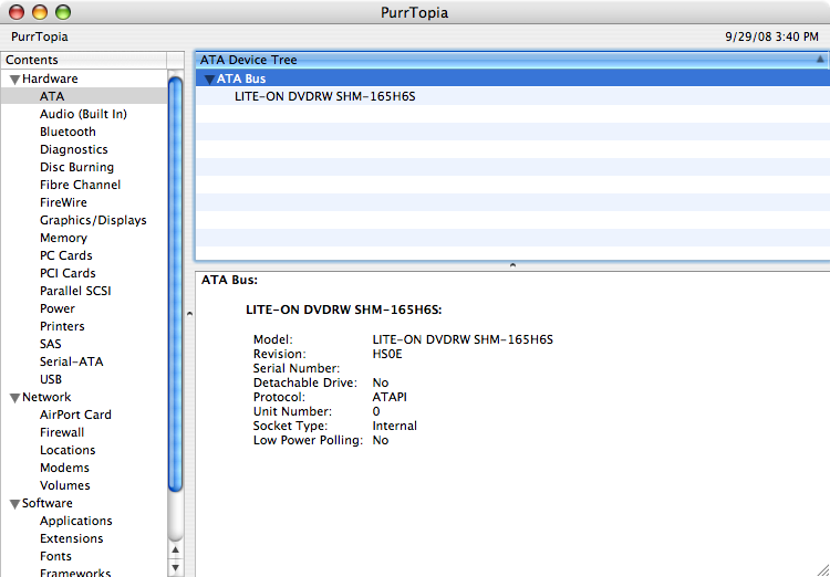

scj312 Posted September 29, 2008 Share Posted September 29, 2008 I fixed my problem too, had to change the jumper (#@%$) to cable-select from secondary which was because I used to have an IDE HDD. Link to comment https://www.insanelymac.com/forum/topic/128588-ide-dvd-not-detected-in-os-x/#findComment-911176 Share on other sites More sharing options...
