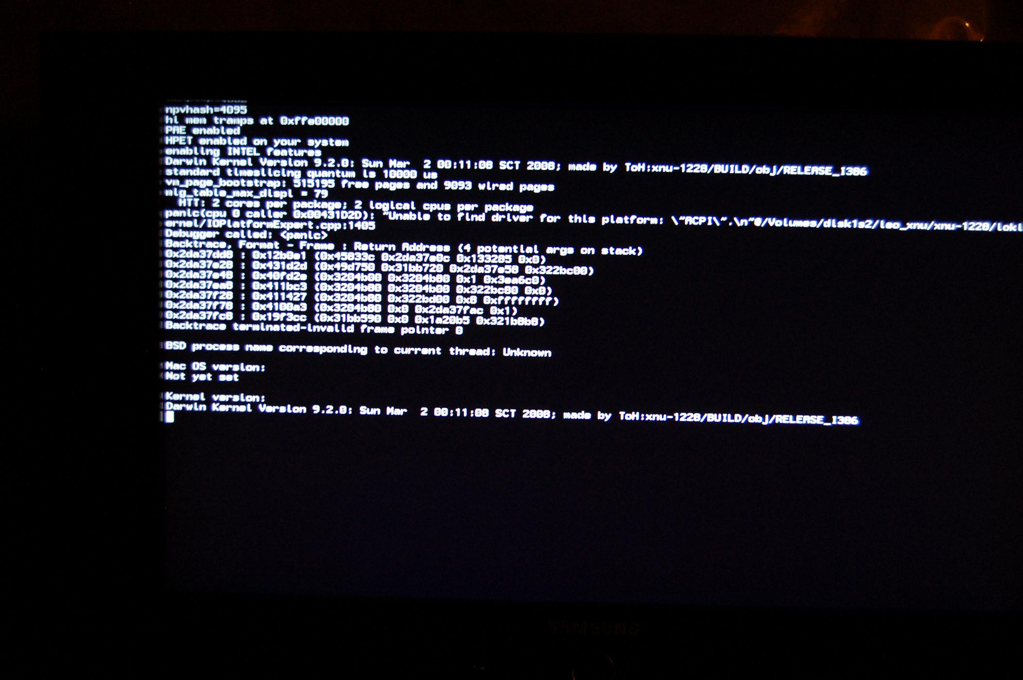

devils-haven Posted August 28, 2008 Share Posted August 28, 2008 look at the screen cap can any one tell me what is the problem and if i can fix it? i can't boot the dvd at all tried Kalyway_10.5.2_DVD_Intel_Amd and iATKOS_4i and i get the exact same screen, hope its somthing i can change in the bios they are both medefied with the chameleon pff patch so i can boot my jmicron IDE please help me realy need it, if any one has the same board? setup asus P5QL-E jmicron IDE core 2 duo e4500 2.2 @ 2.7 8800gts 640mb 2gig 667 kingston ram 1xSATA seagate 500gig 1XIDE master WD 250 GIG(the one i want to put osx on) 1xIDE slave LG DVDRW(the one i am using as a dvd drive for the install) Link to comment https://www.insanelymac.com/forum/topic/123170-help-installing-105/ Share on other sites More sharing options...
Gujal Posted August 28, 2008 Share Posted August 28, 2008 Asus P5Q BIOS is incompatible with OSX. Read this thread Link to comment https://www.insanelymac.com/forum/topic/123170-help-installing-105/#findComment-871175 Share on other sites More sharing options...
devils-haven Posted August 28, 2008 Author Share Posted August 28, 2008 Asus P5Q BIOS is incompatible with OSX. Read this thread even if its a p43 insted of a p45? Link to comment https://www.insanelymac.com/forum/topic/123170-help-installing-105/#findComment-871176 Share on other sites More sharing options...
Gujal Posted August 28, 2008 Share Posted August 28, 2008 It seems the ASUS P5Q Series BIOS is the issue, not the chipset. Link to comment https://www.insanelymac.com/forum/topic/123170-help-installing-105/#findComment-871197 Share on other sites More sharing options...
devils-haven Posted August 28, 2008 Author Share Posted August 28, 2008 i did get the moded bios made by phoenix3200 for the P5QL-E, thankfully my system is still working, but the osx install dvd still won't boot, i get a slightly diffrent screen now, i'll post the screenshot tomorow Link to comment https://www.insanelymac.com/forum/topic/123170-help-installing-105/#findComment-871209 Share on other sites More sharing options...
phoenix3200 Posted September 12, 2008 Share Posted September 12, 2008 10.5.3 (10.5.2 Kalyway -> Jas) is working just fine on my P5QL-E. What I remember having to tweak was applying Chameleon to the setup, and turning on ACPI and AHCI anywhere I could find them in the BIOS. The Atheros L1e integrated NIC is junk - you'll need to get a PCI card to replace it (the Realtek 8169 Gigabit NIC worked right out of the box), and the ALC888 audio chipset is a pain to get working - I threw so many things at it that I couldn't tell you what made it work. It's too bad I still can't get optical out. If you're looking for dual booting with XP, you'll need to find the proper drivers to make XP work off of an AHCI drive configuration insead of an IDE configuration. If you're looking for triple booting with Ubuntu, the drivers to get the Atheros working are such a pain that you'll wish you owned a Realtek card already. Link to comment https://www.insanelymac.com/forum/topic/123170-help-installing-105/#findComment-888167 Share on other sites More sharing options...
