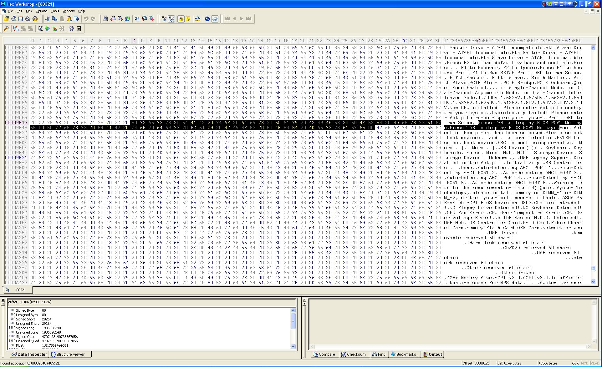

Jedric Posted October 19, 2008 Author Share Posted October 19, 2008 For those who are interested in removing the "Press tab to display BIOS POST message" I found the module. Its Module21 "Multi Language". Extract it using MMTool and do a hex edit. I haven't done any test or editing. I Just found it. Link to comment https://www.insanelymac.com/forum/topic/119982-bios-modding/page/2/#findComment-936350 Share on other sites More sharing options...

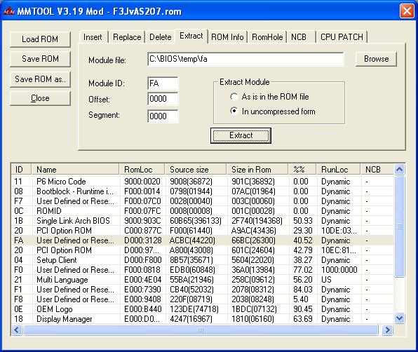

Jedric Posted October 20, 2008 Author Share Posted October 20, 2008 First things first.... I have removed the intel logo successfully as per SticMan's instruction. Just remove the F0 module in MMtool. One thing to note is to use the MMTool ver 3.19Mod21fix. Version below this does not allow you to delete, add/insert or replace modules. One more good new is the possibility of MAC/Apple "chime" on boot post. Now i'm all excited I know lots of guys would love this. Here's what I did. I downloaded the BIOS for Asus laptop F3Jv. This laptop has a chime option on post. I added .rom extension. The BIOS of FJ3v can be opened with AMIBCP which is great. I used the MMTool and found module "FA" contains the chime. Its a wave file. I extracted it and rename to .wav and it played on windows sound recorder. Now for some help. Would anyone care to try applying the suggestions on http://www.rebelshavenforum.com/sis-bin/ul...c;f=52;t=000132 on adding New Item and New Labels in the BIOS. Most of us can't open our BIOS in AMIBCP so this would be the long way of doing it. I don't have module FA in my BIOS, so im assuming its straight insert using MMTool. Just edit the wav file using sound editor and replace it with the Mac/Apple chime. fa.wav Mac_Startup.mp3 Link to comment https://www.insanelymac.com/forum/topic/119982-bios-modding/page/2/#findComment-937017 Share on other sites More sharing options...

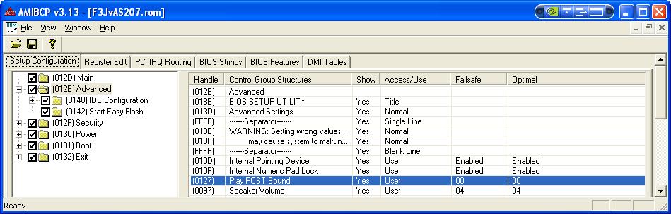

SticMAC™ Posted October 20, 2008 Share Posted October 20, 2008 Adding the module FA to the bios doesn't make it play the sound! We will have to look into adding the BIOS options for enabling the sound as in the F3Jv rom. I would like to but I'm busy, the Wife just slapped a Acer Aspire One 150 on my desk and said: " Here, see if you can make this work" I've made the Mac_Startup sound file into a small enough wav for you to insert. It has no extension but it is a wav file, the Bios has no prob if it is smaller but hates it if it is bigger! StiCMAN Link to comment https://www.insanelymac.com/forum/topic/119982-bios-modding/page/2/#findComment-937150 Share on other sites More sharing options...
